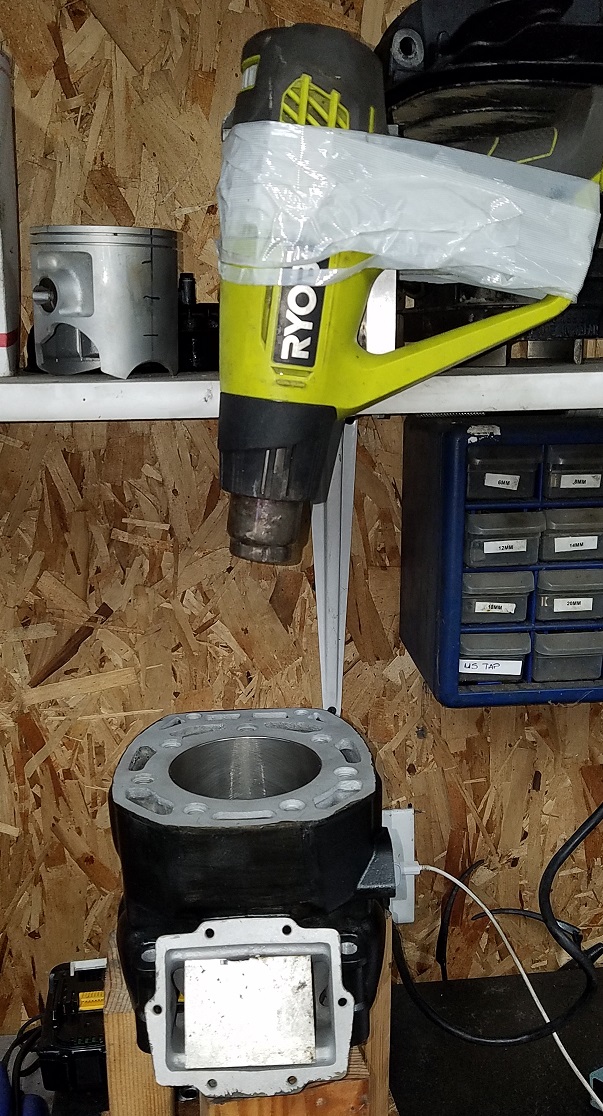

Here is the set up

Air temp was 50f.
I turned on the heat gun and ran it until the block off plate in the intake reached 200f.
I used the block off plate because it was the most accurate way I could figure to start both cylinders off at the same temp.

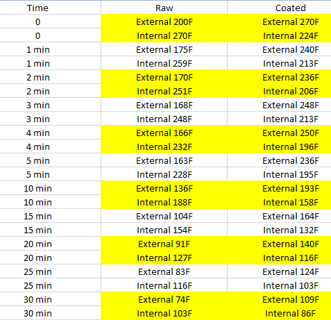

Next, I moved the heat gun and took temps externally and internally in the same spot on both cylinders.
Five readings were taken and averaged at each spot with a Infrared thermometer.
Re: Gun-kote paint. How well does it work?
Posted: Wed Mar 03, 2021 9:26 pm
Initial thoughts?
Wow!
I can wait to get this bike out for some live action testing and see how it works :ugeek:

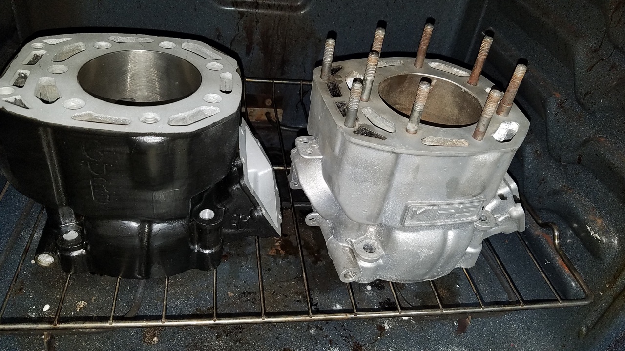

Here is another testing method.
This time I put both cylinders in the oven at 275f for 40 minutes.
Shop temp was 54F.
I pulled both cylinders out at the same time and started checking temps.

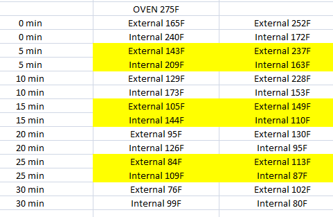

Here's the results..
left side Raw.
Right side Coated.
Again, Gun-kote is showing interesting results :geek:
