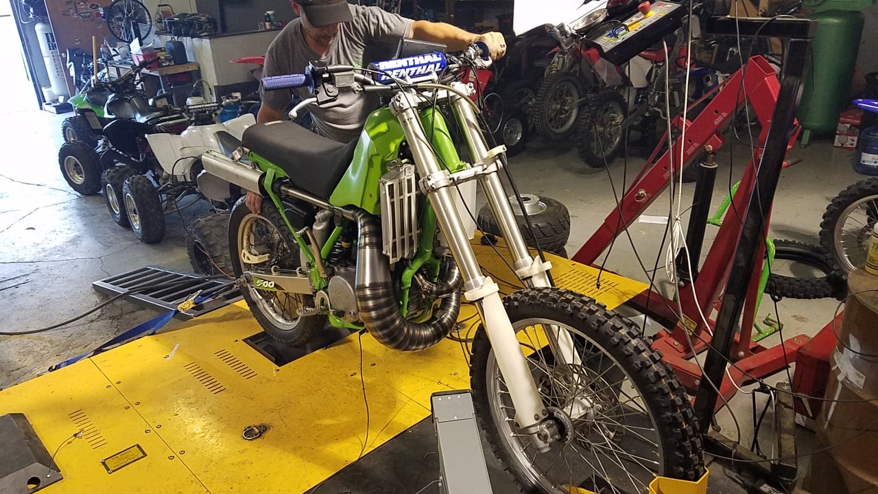

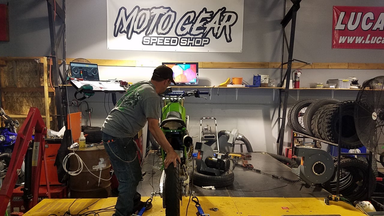

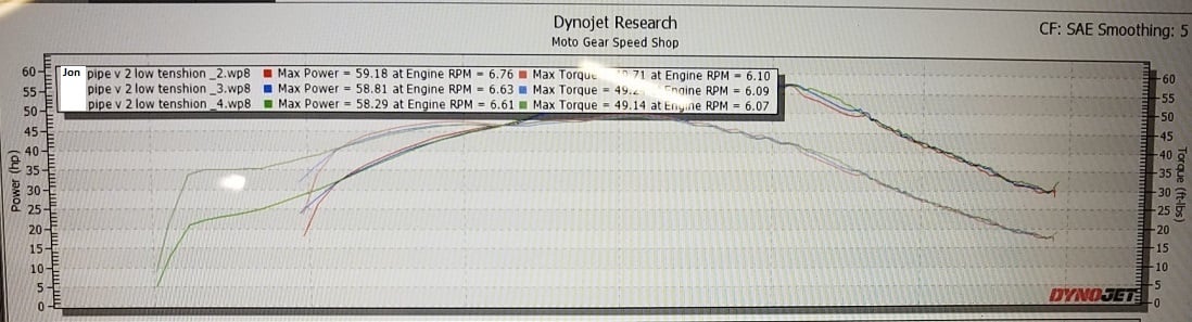

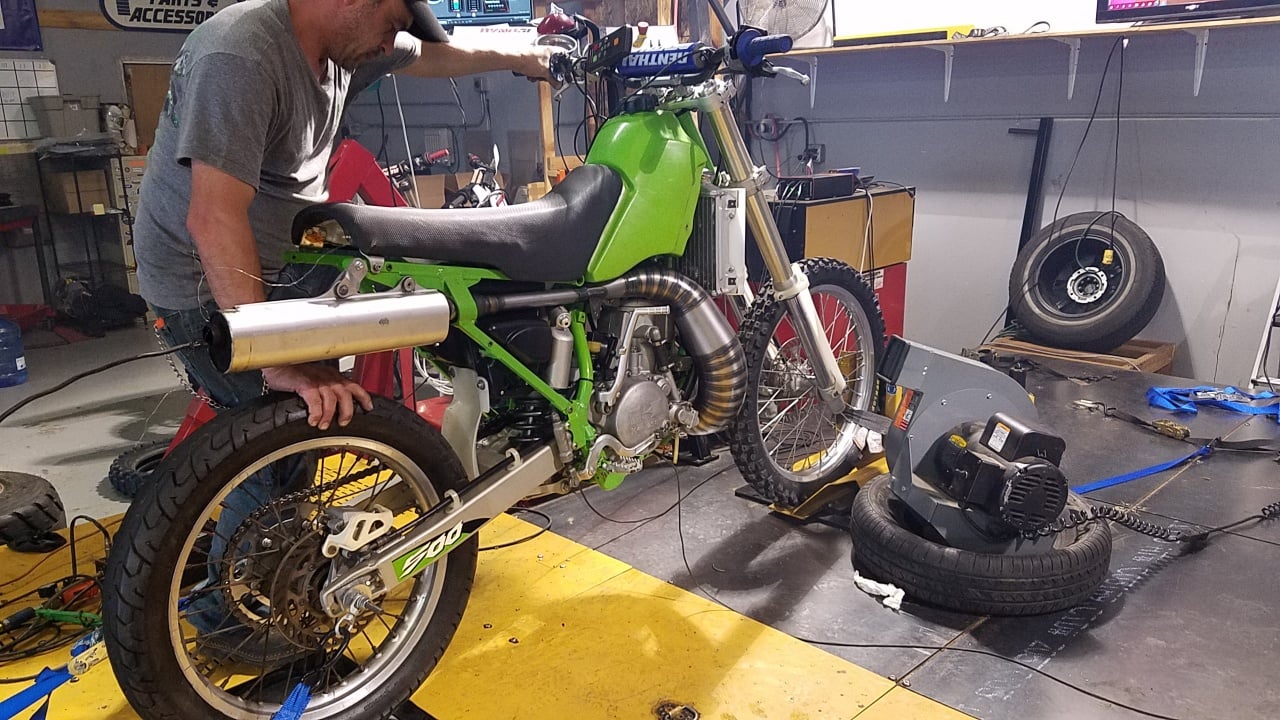

Jonathon Bell sold me this beautiful pipe a while back and I finally got around to testing it. So far it is making more HP and more torque than the stock pipe, Pro Circuit 2, and a FMF Gnarly Desert pipe. Here is the setup. Chad Cadnum
's beautiful all Stock 01 KX500, VF2 reed at the low tension setting, 92 pump gas. That's it.
49.71 ft/lb or torque
59.18 hp.
Drop in some c12 and you'll be over 60 at the rear wheel.
While the HP is impressive considering the setup the Torque is amazing...
This series of tests would not be possible with out Jason Tanner, Chad Cadnum, Moto Gear Speed Shop, and of course Jonathon Bell

On Jonathon Bells Doma vs PC1 pipe the difference all the way through the RPM range is the same until you get to the peak... then the Doma peaks a little higher but it holds on to the pear power longer..
Either are great pipes and both fit perfect.
But for my money I'd get the Doma.

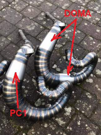

I'm assuming the middle pipe in this pic is the Doma?
https://www.facebook.com/photo/?fbid=10 ... 0340983907
Re: KX500 cone pipes
Posted: Wed Sep 22, 2021 4:42 pm
The one on the left is a PC1, the one on the right is a Doma.
You can always tell because the Doma has two straight sections and the PC1 only has one.
