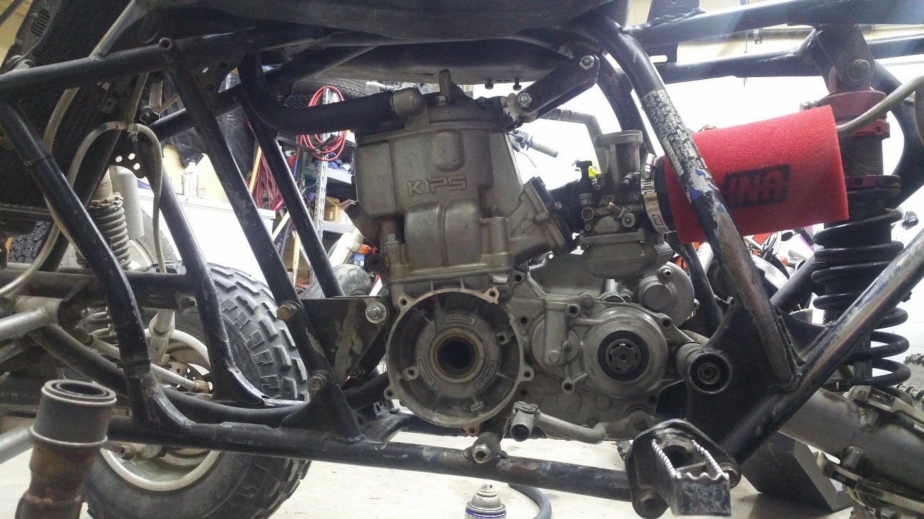

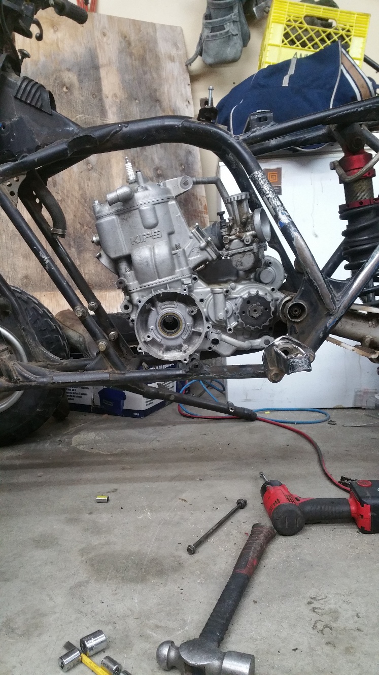

I did this project a couple years ago but just got around to finding all the pictures and doing this write up. Got my hands on a KX500 engine and thought I'd try putting it in a quad. I found a rolling chassis, a 1985 Suzuki LT250, the frame had a gusset kit installed, the A arms are 2" forward and 3" wider (6" total), swingarm is an 8" extended swingarm and the axle is 8" wider than stock. Front suspension are shocks from a YZ and the rear suspension is Elka.
The engine went straight into the swingarm mount, the swingarm bolt was same diameter as the KX500 bolt. Didn't have to do anything to make that mount work. Then just had to fab up the other mounts

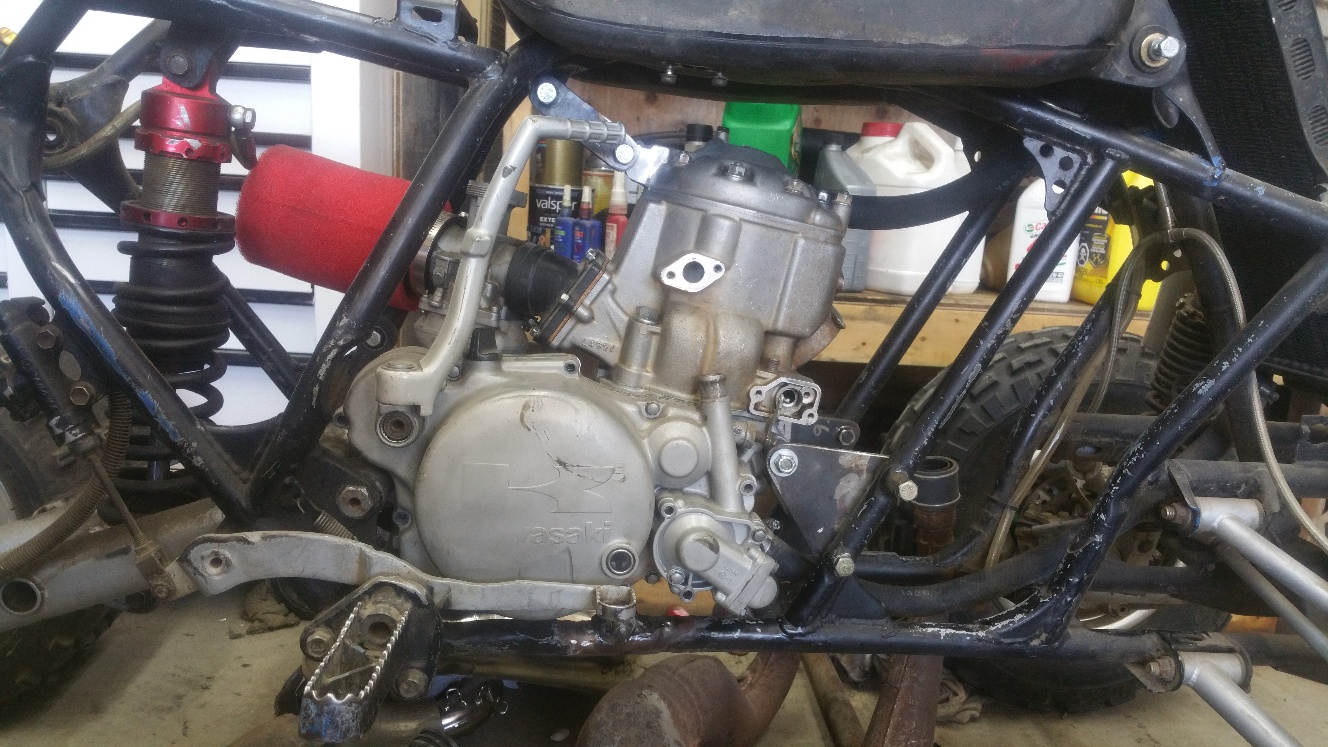

I had a head that somebody had chopped short, I think to try and do an AF conversion. I welded on an aluminum rod

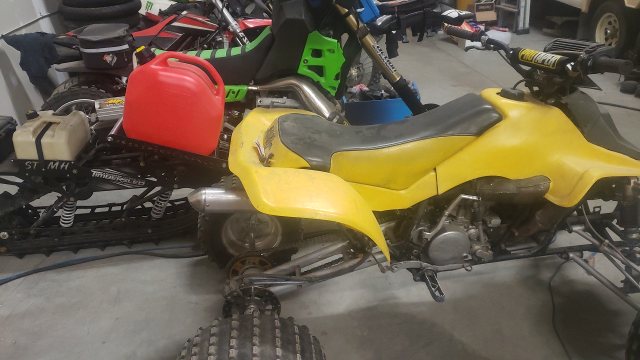

After that trip to Idaho I added a bracket on the back for an extra 10L gas can, the thing is a thirsty pig in the sand and I couldn't go very far from camp. I haven't rode it since adding the bracket, if this Rona border closure ends before winter I really want to go back to idaho
