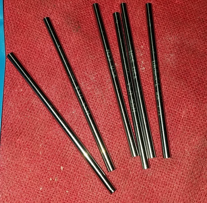

I was talking to Jeff Grabarger multi time KX500 Drag Champion about the issue and he turned me on to 4mm Drill blanks.
They are HARD :D
But... it will likely wear the drum valve slot faster than the D2 so there is a trade off.
Drums are going to be sold for a premium very soon as they will be discontinued.
So think twice before using the Drill blanks...
