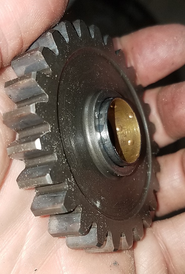

That's right folks, 26T - FITS 86-04 KX500 - 59051-1150 is no longer avalable :o
If your KX500 is 10-15 years old it's likely that the bronze bushing is worn out....
Almost every KX500 Jason and I have rebuilt over the last 5 years needed a new gear and we use to simply order a new one.
What to do....
kx guru racing kx500 86-04 kx500 kick idler gear 101.jpg (267.62 KiB) Viewed 10883 times
If you look closely you can see that this bushing is split.
So, I am looking for a trans gear of the same dimensions ID and OD... The width can be a little wider with no issues...
Just means a little grinding after the bushing is pressed in. :lol:

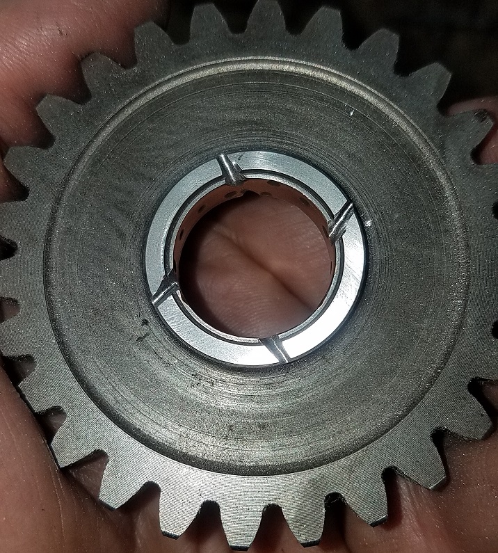

We are also working on a upgrade :o
kx guru racing kx500 86-04 kx500 kick idler gear 102.jpg (221.6 KiB) Viewed 10844 times

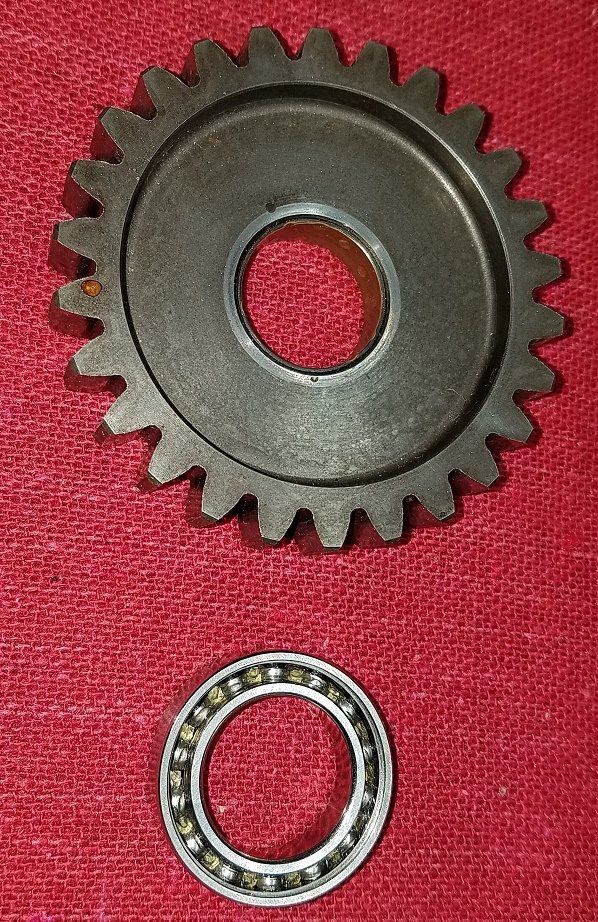

OK, we also found a needle bearing that may work but that is for a later project.

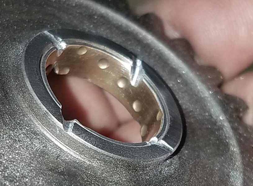

Next, I pressed in the new bushing from the trans into the idler gear.
86-04 KX500 KICK IDLER GEAR NO LONGER AVAILABLE 59051-1150 KX Guru Racing repair 102.jpg
86-04 KX500 KICK IDLER GEAR NO LONGER AVAILABLE 59051-1150 KX Guru Racing repair 102.jpg (207.63 KiB) Viewed 10806 times
As you can see, it's a bit wide but a quick trip to the grinder and sander fixes it up nice.
Also, the bushing is now just a little wider then the stock bushing.
