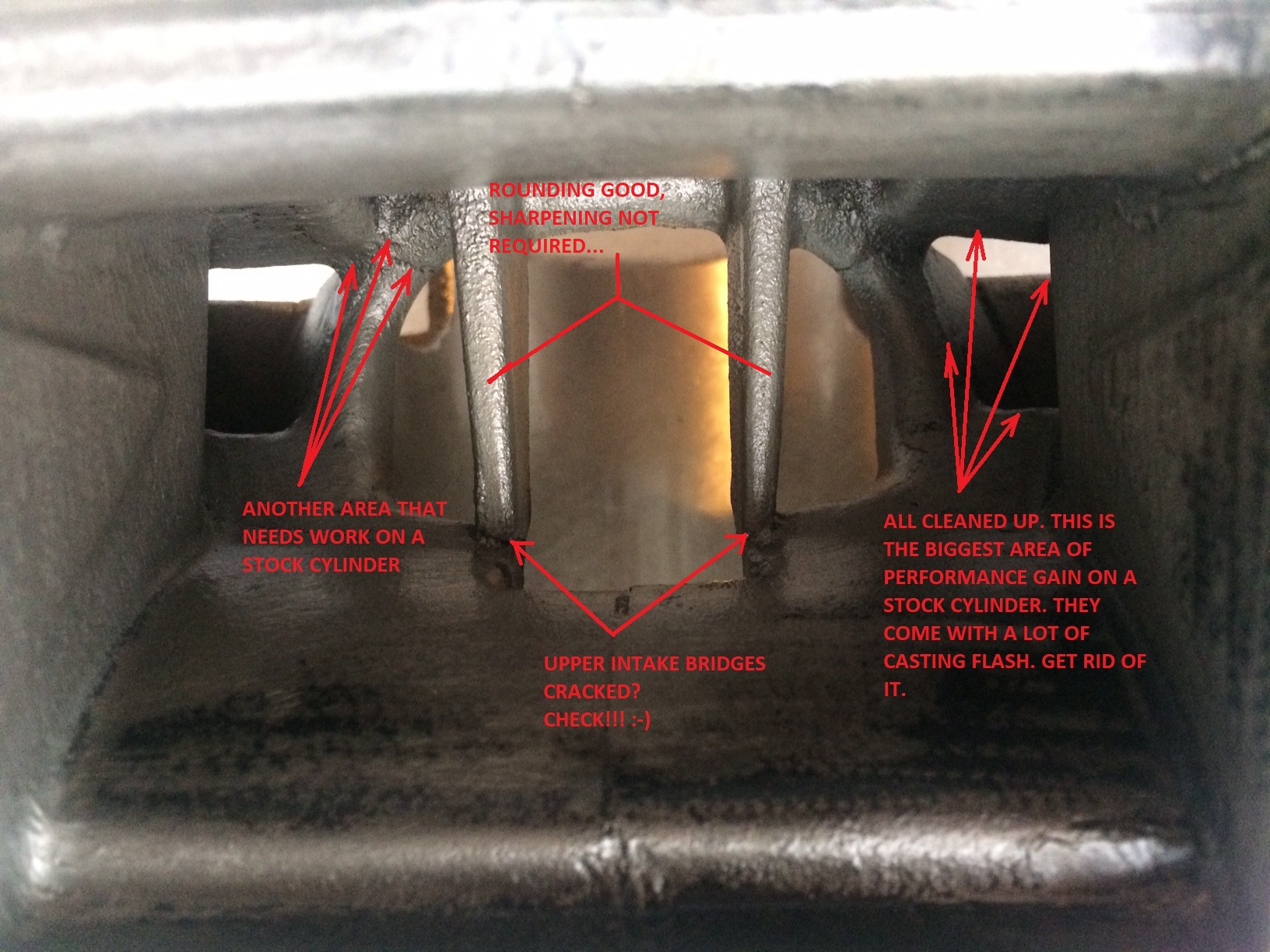

Re: SR500 Cylinder
Posted: Sat Sep 09, 2017 2:53 pm
A simple clean up as shown is all that is really necessary.

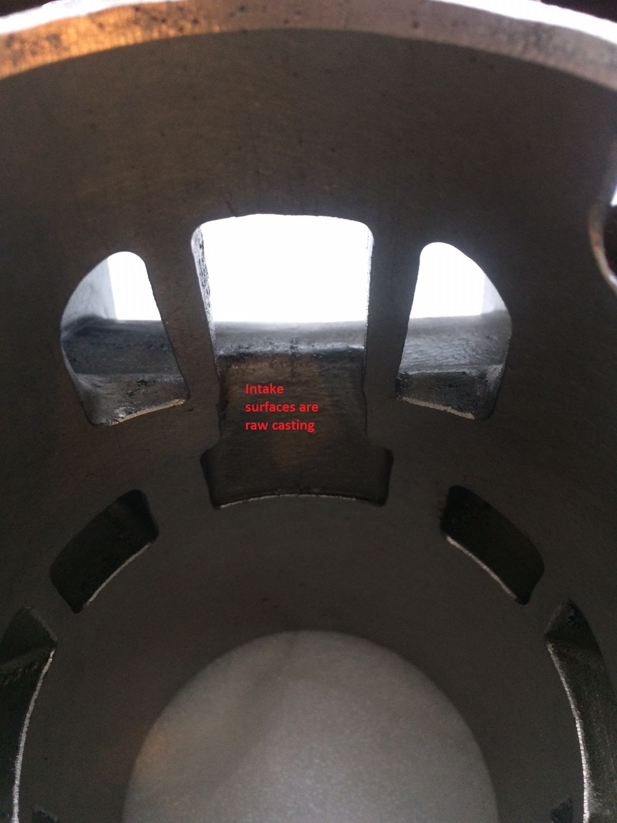

Re: SR500 Cylinder
Posted: Sat Sep 09, 2017 2:56 pm
I like to get these surfaces a bit more even but again there isn't much to do..

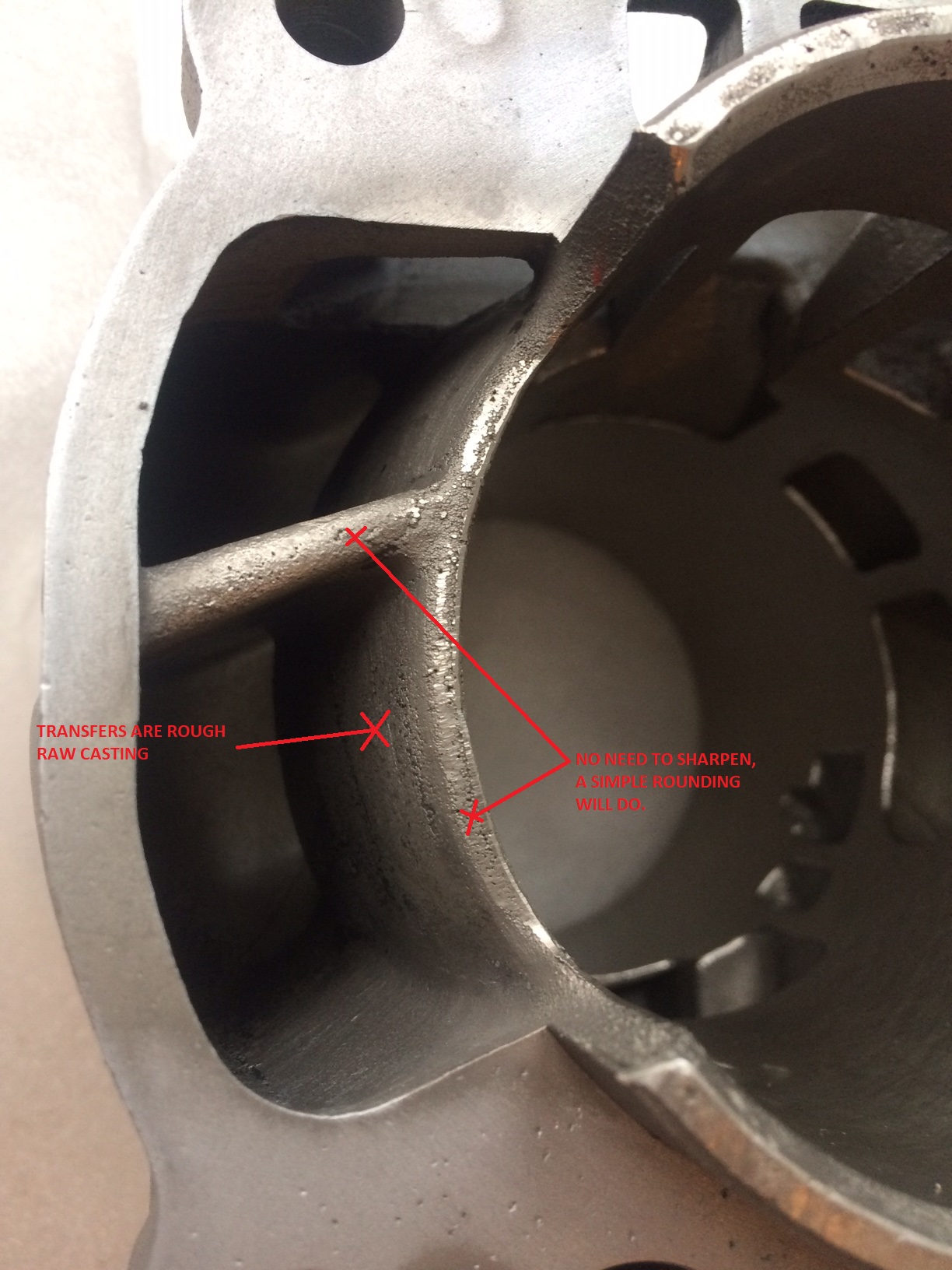

Re: SR500 Cylinder
Posted: Sat Sep 09, 2017 3:00 pm
I like to clean up the exhaust port and polish but it does not really make any HP.
Rather, by polishing the surfaces it gives carbon less chance to build up and will keep the new HP you are making longer...

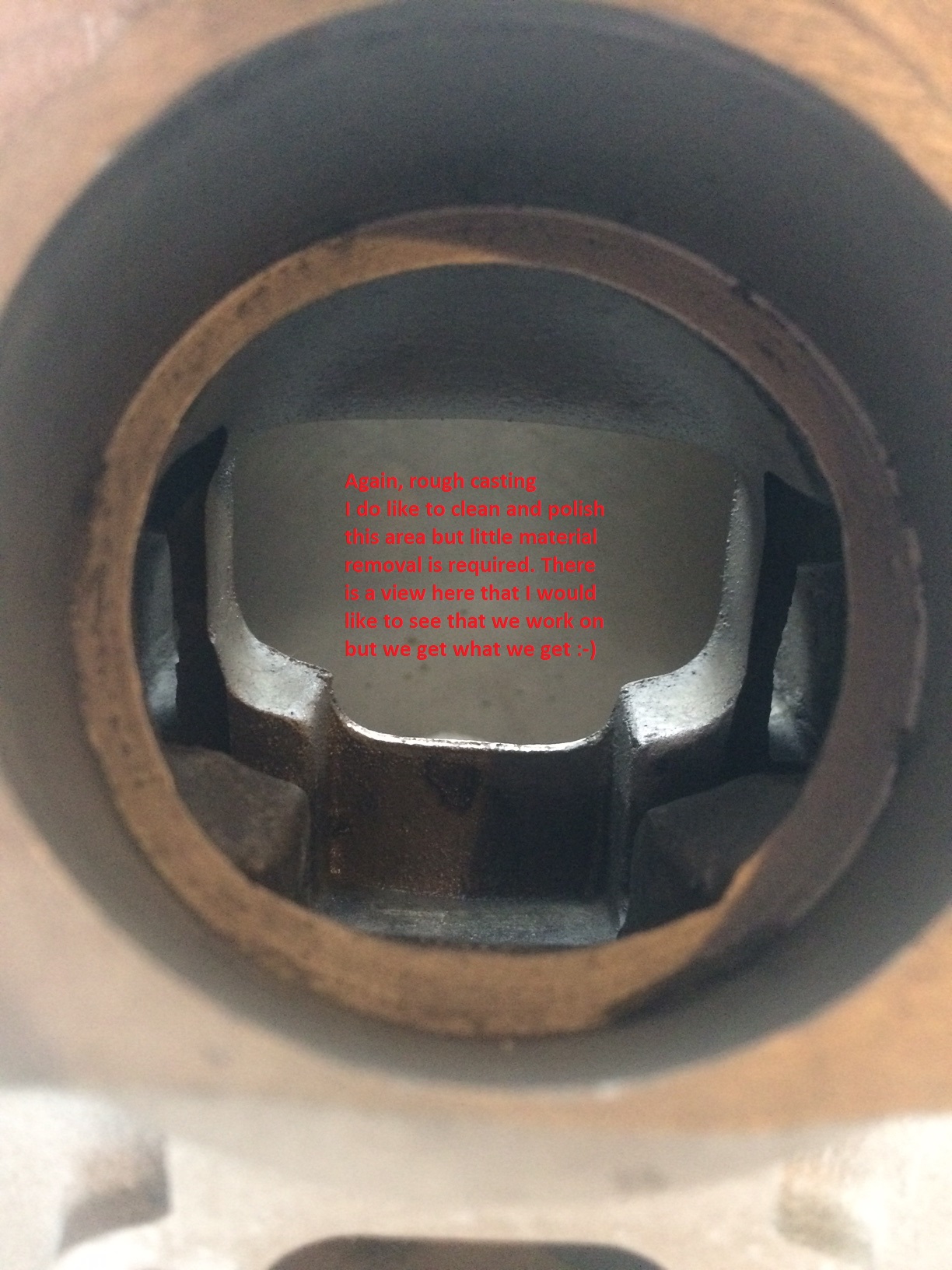

Re: SR500 Cylinder review - What can we learn?
Posted: Sat Sep 09, 2017 3:08 pm
The intake area shows the most improvement over stock.
But over all not huge gains...
