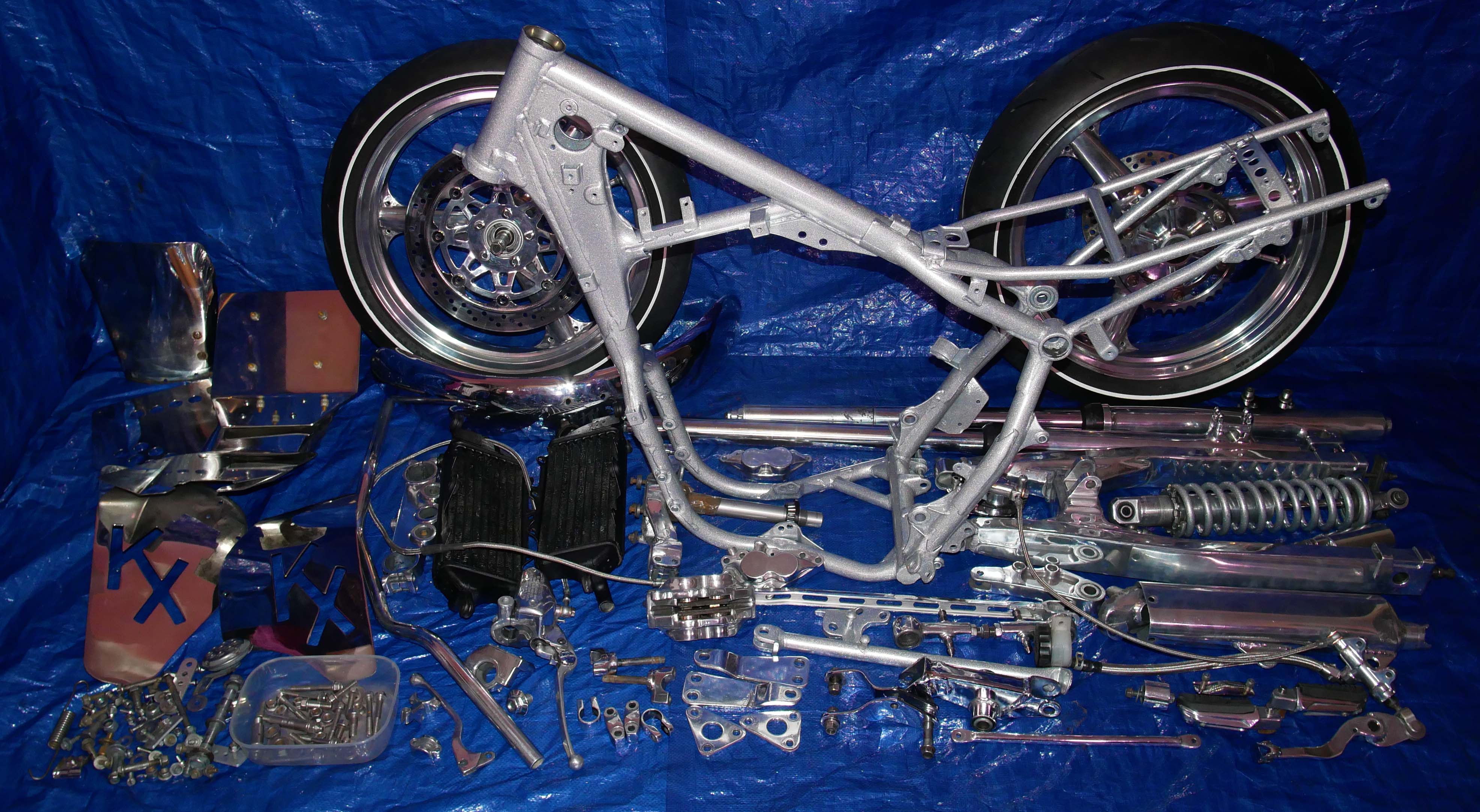

This is what I've done since dismantling the bike in January.
The frame, rear spring and side stand have been powder coated, but I polished, cleaned or painted the rest myself in my kitchen.
I've just started editing video number 12.
Polishing the front brake caliper that is in two halves, polishing the swingarm, polishing the wheels, and painting whitewalls on the tyres have their own 30 minute or longer videos as they were masses of work.
I've started dismantling the engine which needs a piston ring, but because it's a vintage bike now, I can't find one in the UK so I've ordered one from USA.
The engine will have to stay dismantled for about a month till that comes, then I can rebuild and paint it.
Still to do:
I've to decide on colours/graphics and paint the petrol tank, side panels and fairing, but I'm probably going to ditch the old fairing and do something different maybe with stainless steel.
The exhaust needs dents filled then painted, the seat will need re-covered, the electrics are a mess so need done again from scratch.
I can start building up everything in the image onto the frame so it will start to look more complete soon.

Excellent
Post the vids on Youtube but link them here...
I can't wit to see how this one turns out...
Do you have any special plans for the engine or are you going to leave it stock?

Thanks Sandblaster.
I'm trying to do this as cheaply as possible so the engine will be getting a replacement (original size) piston ring and no more.
This is the first time I've taken the barrel off since buying the bike in 1990 so (as far as I know) it still has the original piston and barrel which both measured exactly on the service limit at 85.8mm and 86.1mm.
I've only ever used it as a road bike so it doesn't need to be highly tuned like a race bike (though it would be nice to be able to afford tuning or upgrades).
The clutch plates were all stuck together but, instead of replacing the clutch (like people with plenty of money would do), I polished the small parts of clutch friction material off each metal plate so it should still work fine.
