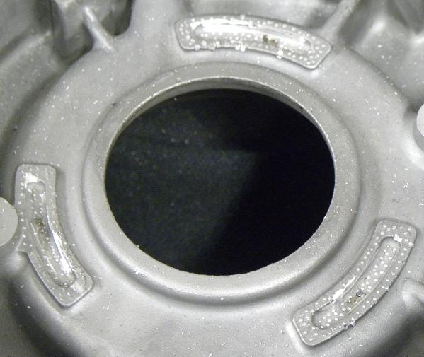

Especially look at this area:
They are known to leak occasionally.

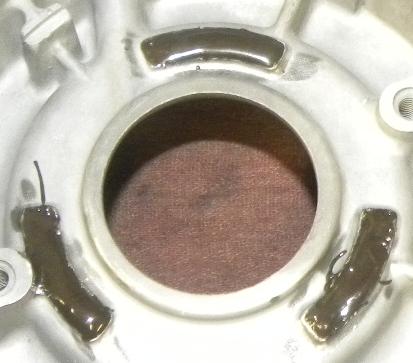

We use to use JB Weld to fill them but now use 1211 Threebond or equivalent.

I will also take the advice and JB or Threebond those areas while it is apart.

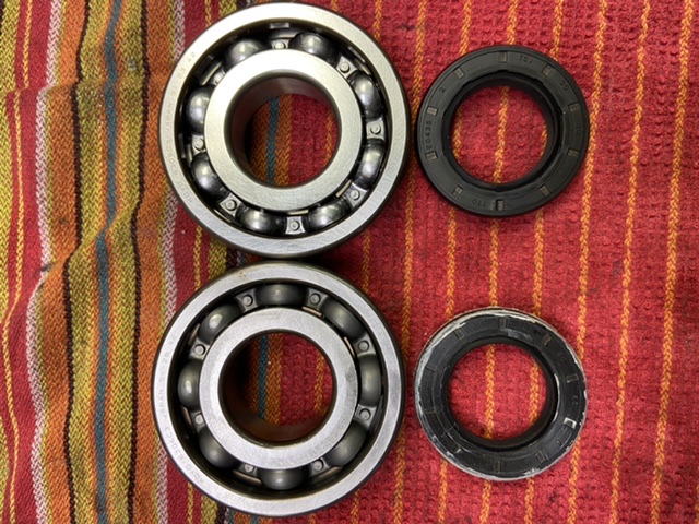

So, I went about pressing the new bearings from Moose Racing onto my crankshaft this afternoon. They went on just fine. Then I installed the new seals into the cases. I can’t put the bottom end together yet, because I had to order the bearing retention compound. Nobody in SLC had any on hand. As for that, and the questions I had in the first update, I solved that, sort of, with a call directly to Loctite Industrial Technical Setvices. The machine shop recommended the 640 formula. It sets up really hard, and will withstand 3000 Lbs of blunt shear. The other one I found is 641. Loctite says it will set up a bit less hard. It will handle 1000lbs of blunt shear before compressing and failing. So, naturally, I asked if the 640 would be better. In short, he said yes, but only if it was definitely the last time that the engine would ever be rebuilt. I asked why. He said it is because the 640 is permanent. The cases would likely break before the compound would release the bearing race from the retainer. The only release method for 640 is to heat the unit up to over 500F. He said that 641 is designed to be able to be separated for servicing. That’s why it’s significantly weaker. He assured me that it would handle the task if properly applied and cured before use.
So, I’m waiting for that magic stuff in the mail.

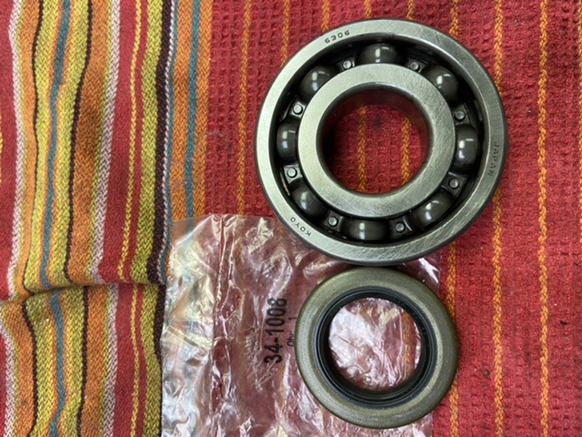

In the mean time, since they are so loose, I decided to drop one of the old bearings I had in a box from way back in about 05 into one of the holes I had just put a new Moose seal into, just to see what the clearance would be. Well, it’s not good. The inner race of the bearing, which is definitely the correct one (Koyo 6306C3) actually contacts the lip of the seal before the bearing makes it to the bottom of the retainer. This kit also has incompatible seals! Here’s a pic of the original seal and bearing from the factory, and the other is a picture of the old All Balls set along side the new Moose set.
Somehow, I had two of the original style seals, (34-1008) brand new in baggies, sitting with my old parts! I installed them, and everything clears just fine. Now I still have to wait for the Loctite 641, but things are looking up.
Thanks,
