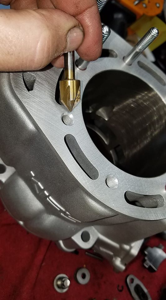

First I chamfer or countersink the stud hole approx .5-.75mm
