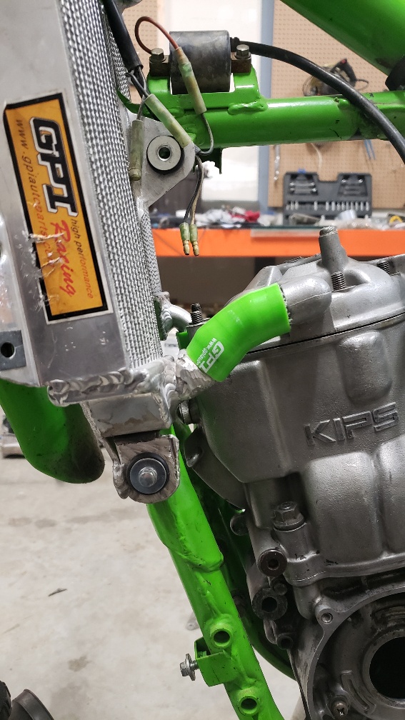

I needed some rads and was looking around to see how guys are making these notoriously poor fitting rads line up and couldn't find too much. OEM rads are an arm and a leg and I got these off eBay with a rad hose kit for $102. People say these are rads bend easy but looking at them the aluminum around the outside is about twice as thick as the stock rads, maybe a crappier aluminum? Took some pictures when I installed them.

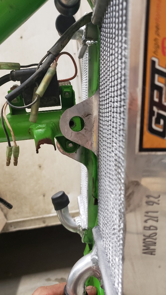

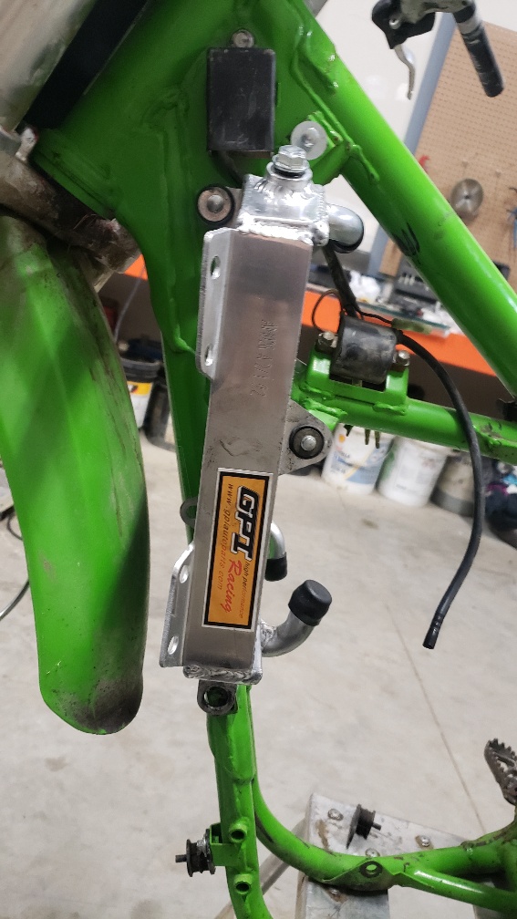

Left side had two holes that lined up well
Right side could only make one hole work so I chose the on that made the rad shroud plastic holes line up best

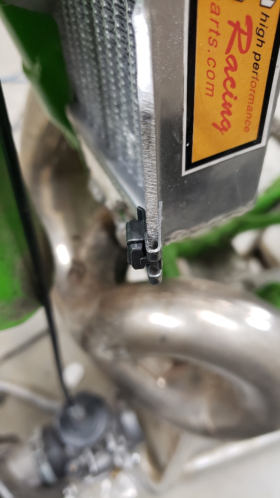

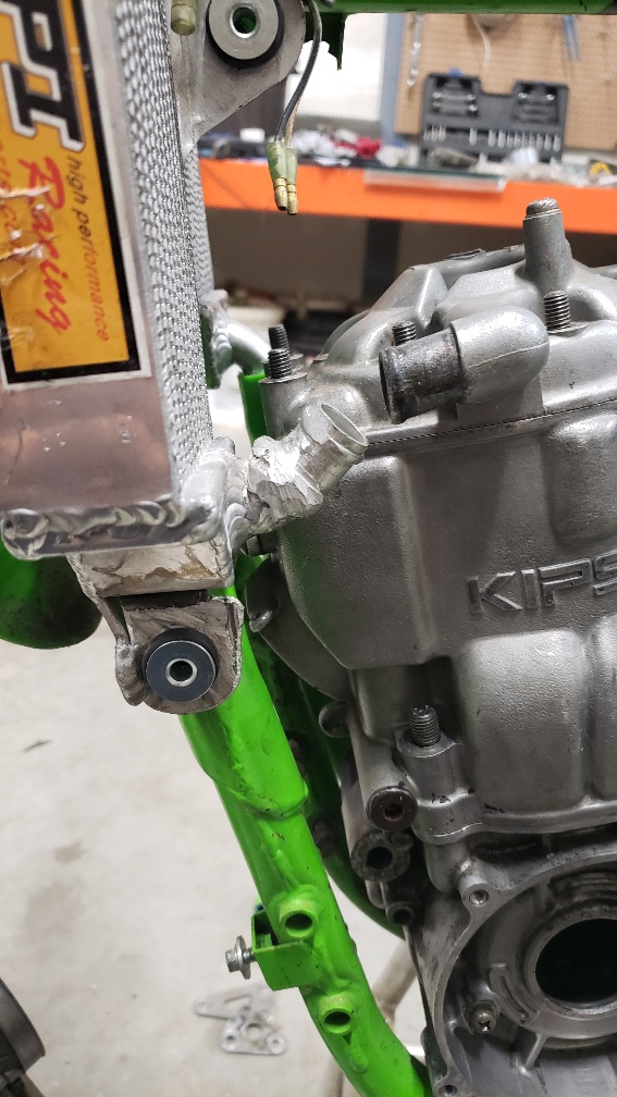

Cut off the bottom tab and spoolgun welded on a piece of 1/8"x1" aluminum long enough to suit. I vise gripped a piece of steel under my weld so the aluminum didn't drop out on me as I welded it
I did the exact same thing for the bottom mount on the right side rad

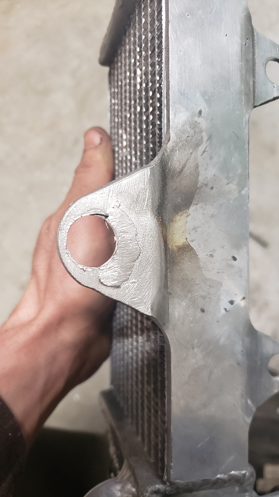

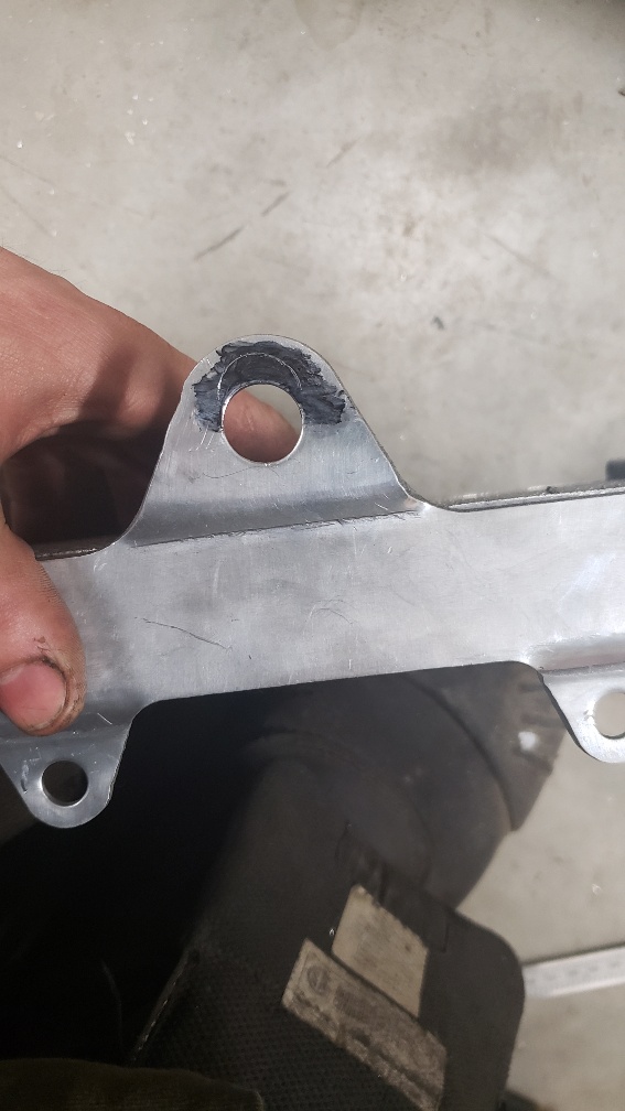

I just used a die grinder on the right side middle mount as there was enough material there to accommodate, then welded up where half of the old hole was
Plastic holes all lined up well.

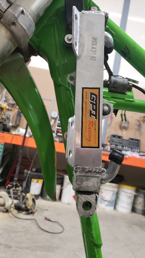

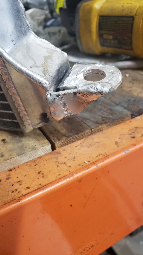

Tig welded on some mount braces, hopefully won't have to deal with cracks in the future

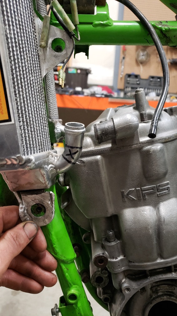

Cylinder is away getting repaired/replated, so I just used spare empty cases and cylinder to mock up and finish radiators.

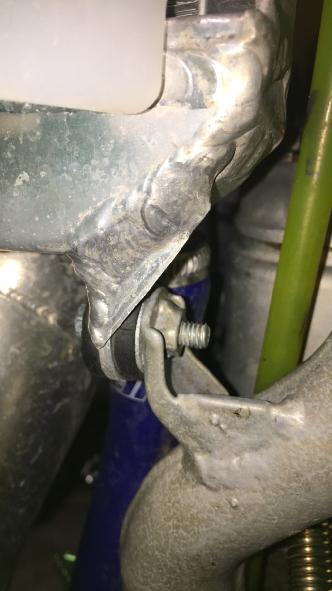

Left side lower spout didn't line up at all, cut pipe at the two lines and welded back together
Had some contamination issues with the weld, aluminum is hard, I have faith it'll seal though
All the other spouts lined up pretty well and the hoses in the kit I bought were proper length and had the right bends in them

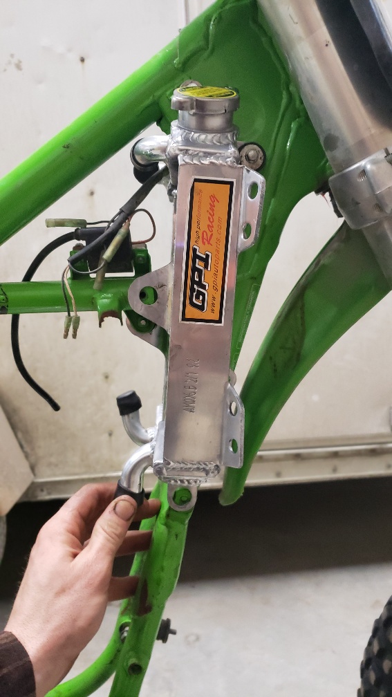

The aluminum where the rad shrouds mount was too thick for the little nut clips
Just shaved them down a bit
