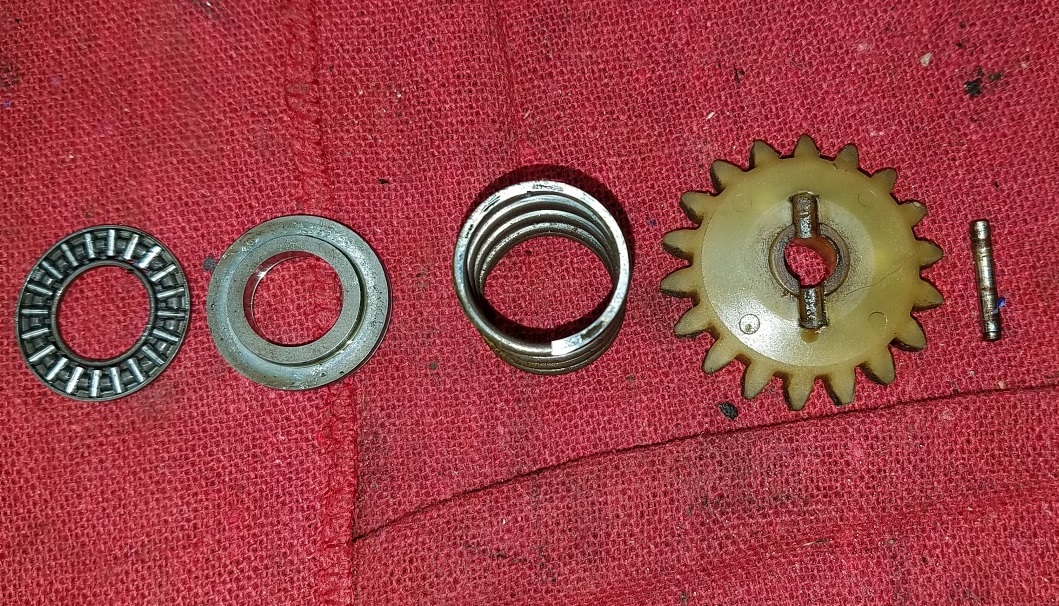

Let's take it apart and see what it looks like inside..
First, depress the plastic gear until you fully expose the small steel pin, then pull the pin out..
KX GURU RACING GOVERNOR REBUILD 102.jpg (193.56 KiB) Viewed 13709 times

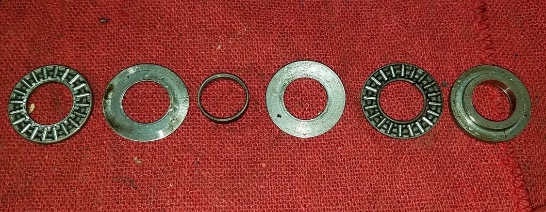

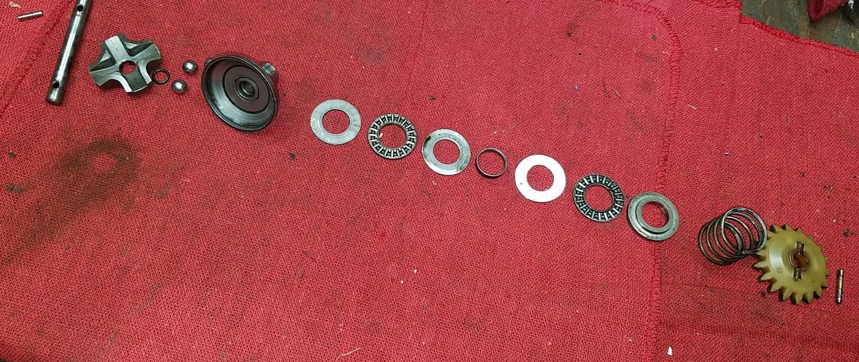

Re: KX500 GOVERNOR REBUILD, WHY BOTHER?
Lay the parts out on your work bench in the order they come off the shaft.
KX GURU RACING GOVERNOR REBUILD 103.jpg (421.42 KiB) Viewed 13708 times
KX GURU RACING GOVERNOR REBUILD 104.jpg (424.44 KiB) Viewed 13708 times
KX GURU RACING GOVERNOR REBUILD 105.jpg (326.81 KiB) Viewed 13708 times

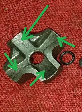

Next I will show area's that I look at and some polishing that I do... Not that it is completely necessary but hey, I like they way things looked polished :lol:
Take a look at this pic.
You can see that the ball bearings roll right down the center...
That is a area I like to polish.
You don't need to polish the entire channel but the area in the middle of each channel can be cleaned up.
KX GURU RACING GOVERNOR REBUILD 108.jpg (70.71 KiB) Viewed 13706 times

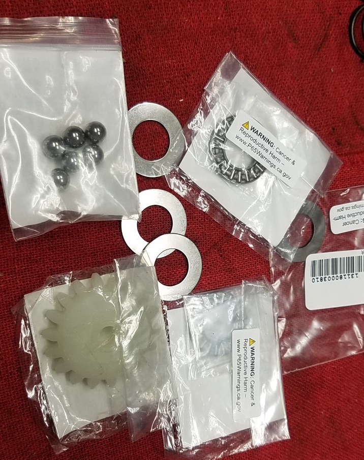

Here is a list of parts that I automatically replace.
The prices are full retail as of 9-6-19.
Most parts houses will sell them for less.
1) SPRING,GOVERNOR 92081-1934 5.58
4) SPACER,15X28X1 92026-1238 6.54 each - total 26.16
2) BEARING-NEEDLE 92046-1252 11.48 each - total 22.96
1) GEAR-SPUR,GOVERNOR 59051-1213 - 12.04
1) RING-O,5.5X1.5 92055-1343 - .45
Grand Total: 67.19
Of course, depending on wear, you may need to replace additional parts as well...
