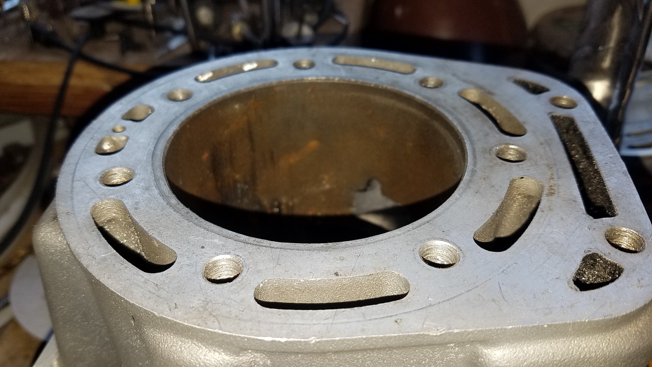

5. Over tightened head nuts.
Take a look at the pic below.
This is how a standard cylinder looks after the studs have been pulled.
Over tightening head studs can cause the aluminum around the studs to pooch out slightly.

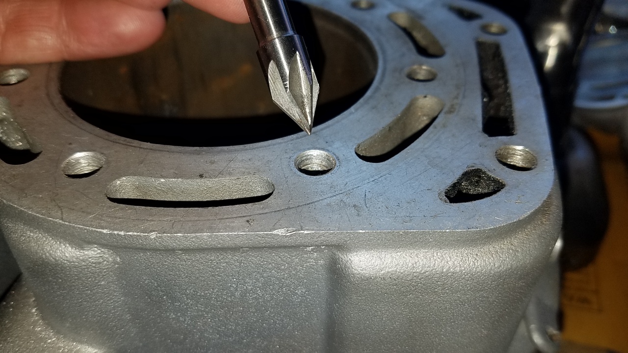

The fix is to take a counter sink (Doesn't really matter which degree you use) and chamfer all the holes around the studs.

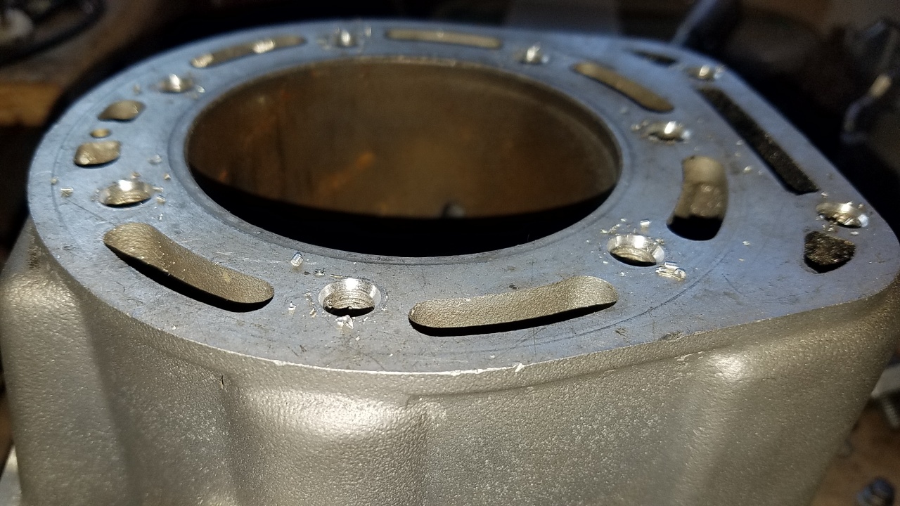

This is what it will look like when done..

Just for grins, I like to clean up some of the areas where the water passages transfrer from the head to the cylinder.
DO NOT get carried away.
Just clean the very edge up enough to insure there is no material ready to come loose and go through your water system.
