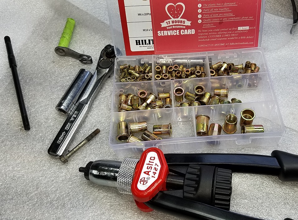

Nutserts! Rivnuts!
Whatever you want to call them, they are the answers.
KX500 01 PLAY BIKE 122.jpg (420.58 KiB) Viewed 7882 times
KX500 01 PLAY BIKE 123.jpg (206.3 KiB) Viewed 7882 times

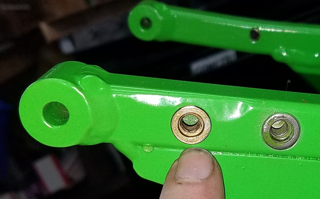

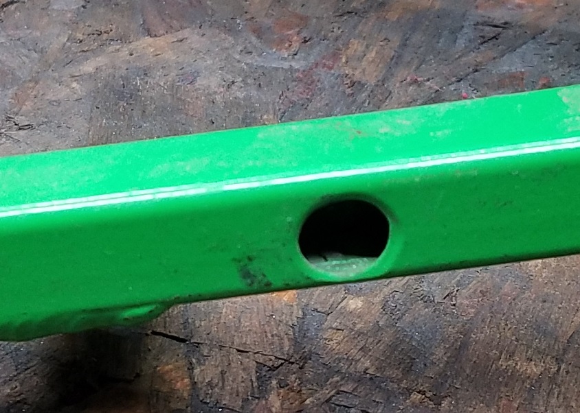

I was asked if the M8 inserts would fit into the sub frame.
My knee jerk reaction was yes but I wanted to be sure so...
I had a sub frame that had a hole so wallered out that a M6 insert fell through the hole :o
Obviously that wasn't gonna work :lol:
Looking at the next pic it appears as if there is enough room.
KX GURU RACING KX500 SUB FRAME REPAIR 101.jpg (244.51 KiB) Viewed 7876 times

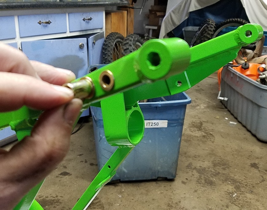

Perfect... The big drawback is the oddball size bolt but better that than some of the back yard repairs I have seen employed 8-)
KX GURU RACING KX500 SUB FRAME REPAIR 103.jpg (180.95 KiB) Viewed 7876 times
