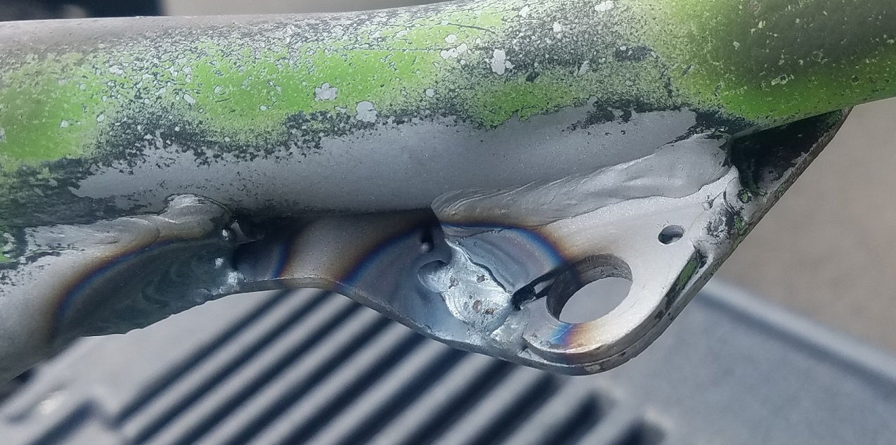

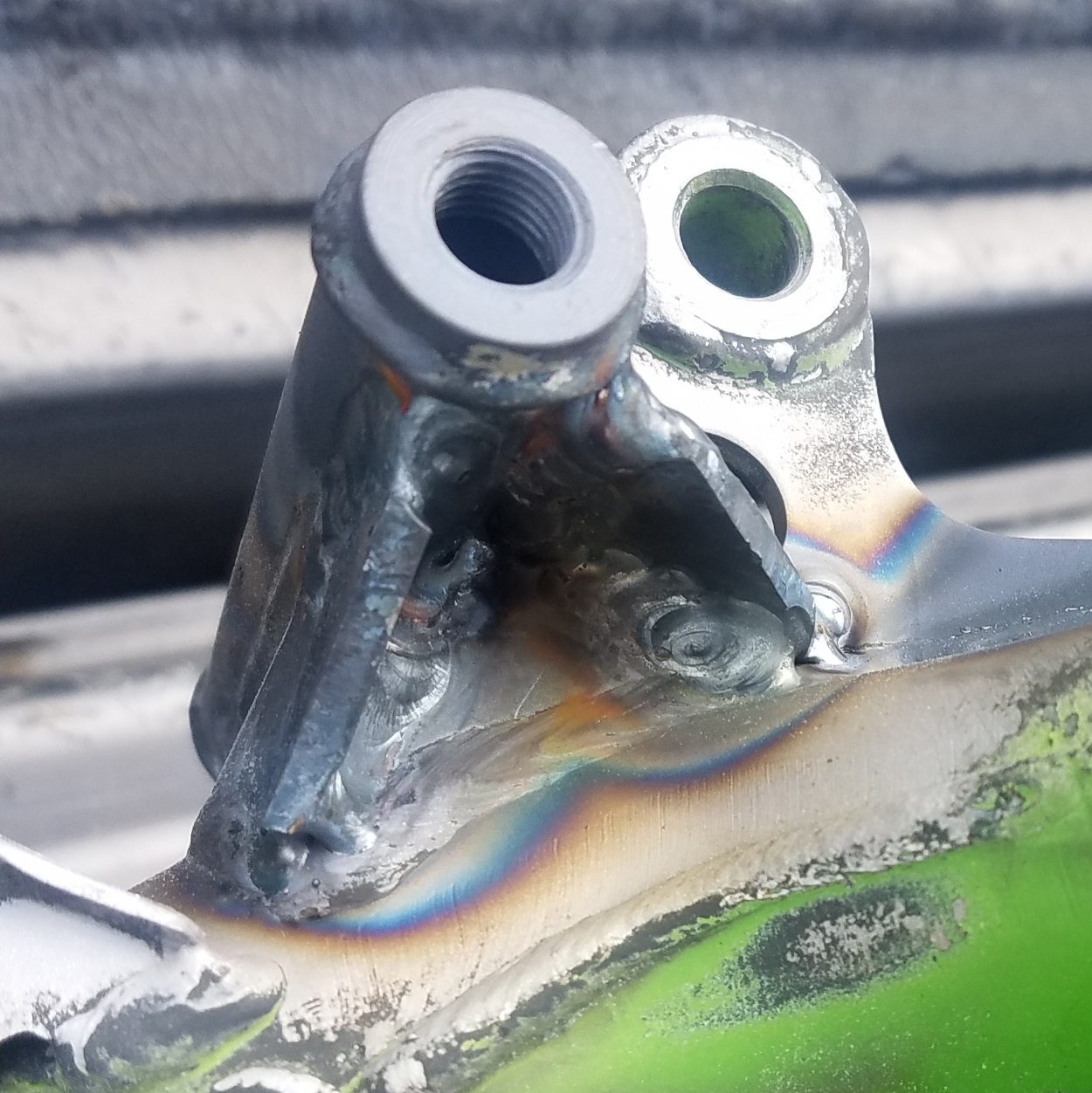

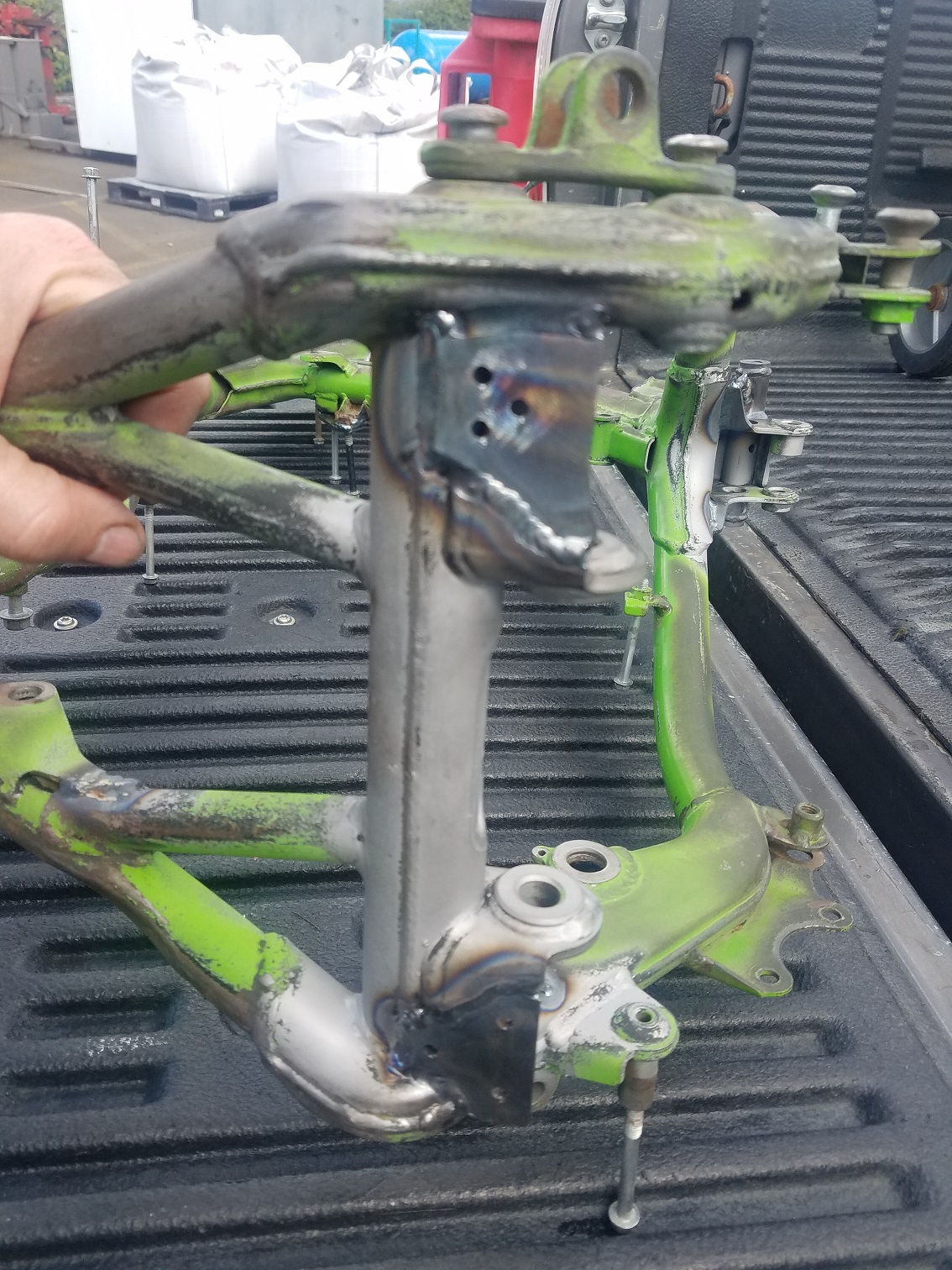

After disassembly I sent the frame to the weld shop with a Jason Tanner (541-653-5334) gusset kit.
A week later the frame was done and I dropped it off at the powder coater.

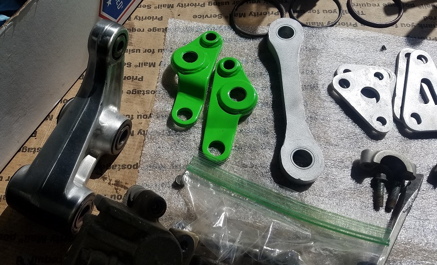

While I'm waiting for frame, sub frame, and shock spring to come back I started cleaning, prepping, and lubricating everything that needs attention.

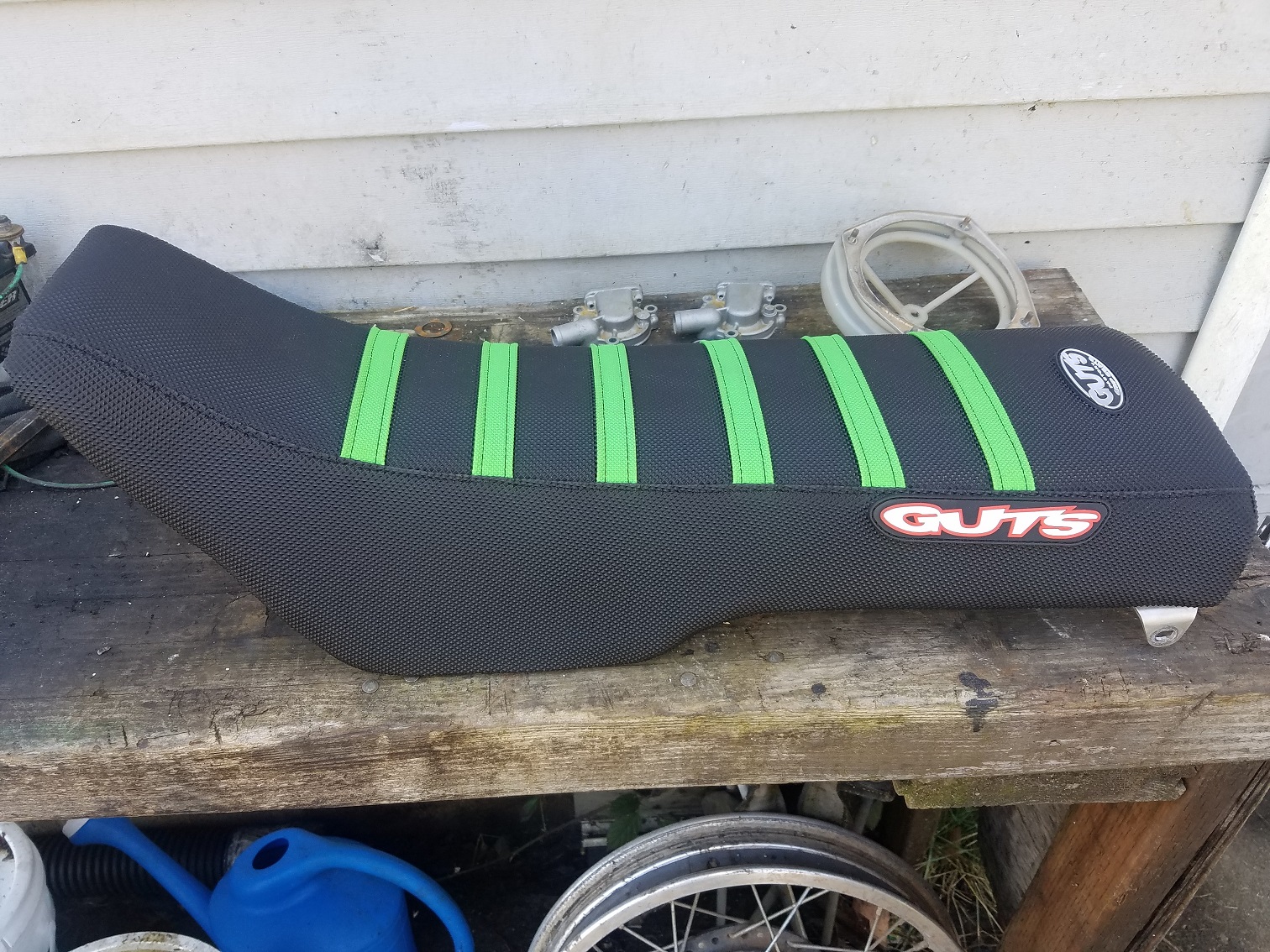

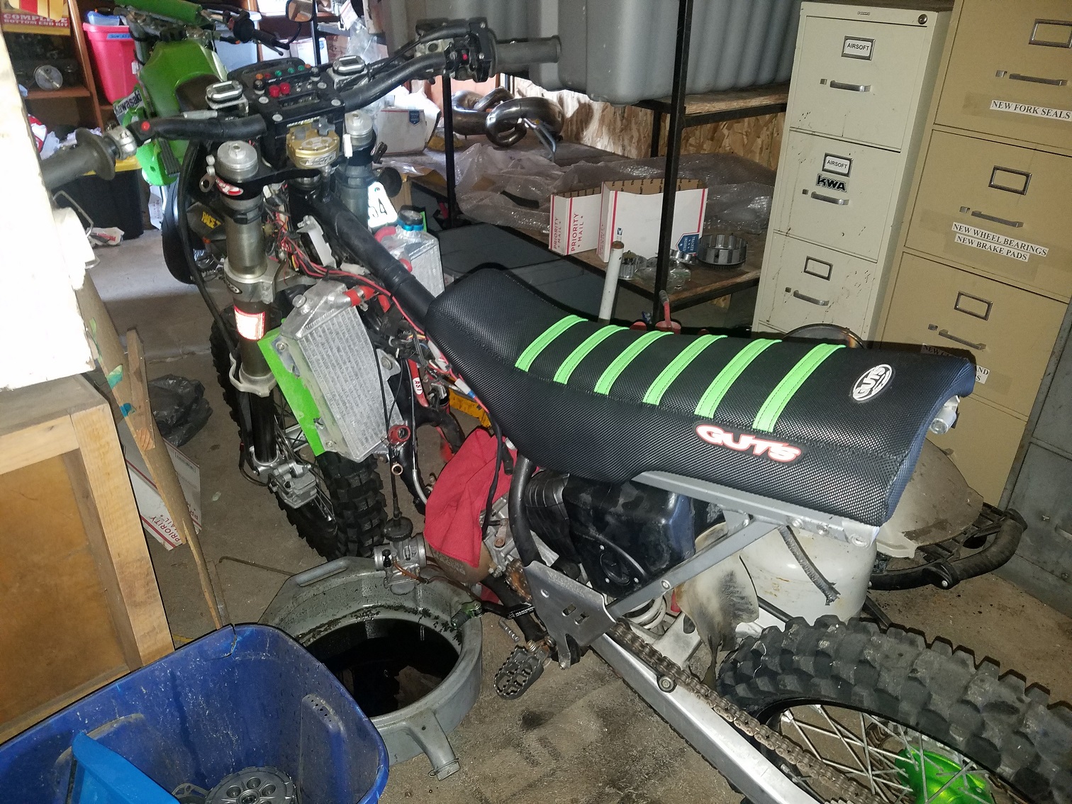

I started with getting a Guts racing seat and foam kit...
I went ahead and sat the seat on my bike since my bike needs a new crank...
After seeing the seat and sitting on it... I want one for my bike 8-)

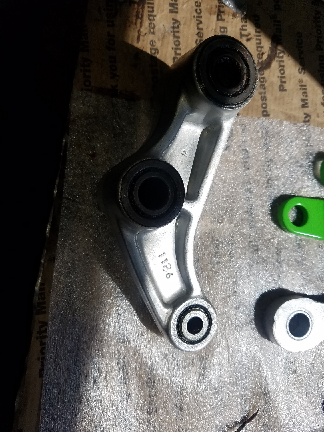

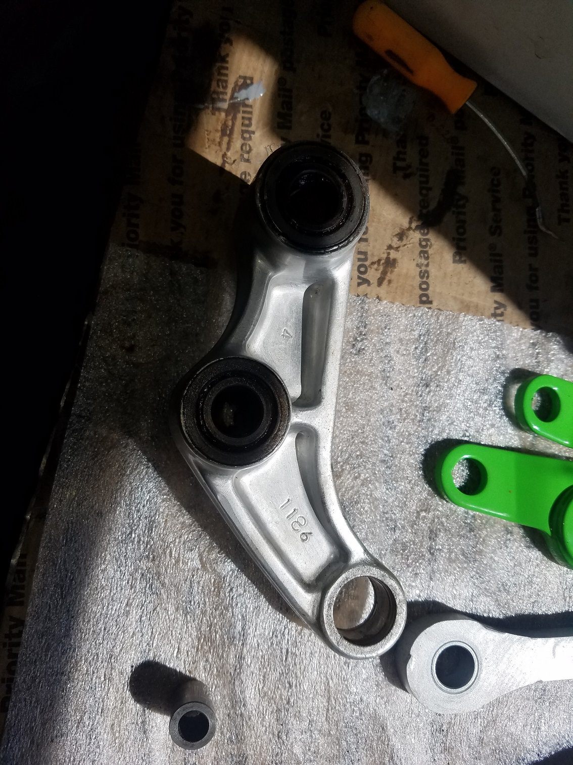

The linkage bearings were all great except for the small bearings.
No problem, I had new bearings and seals in stock :D

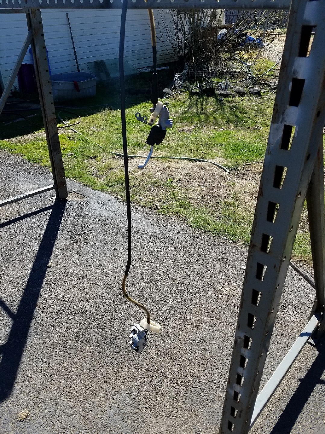

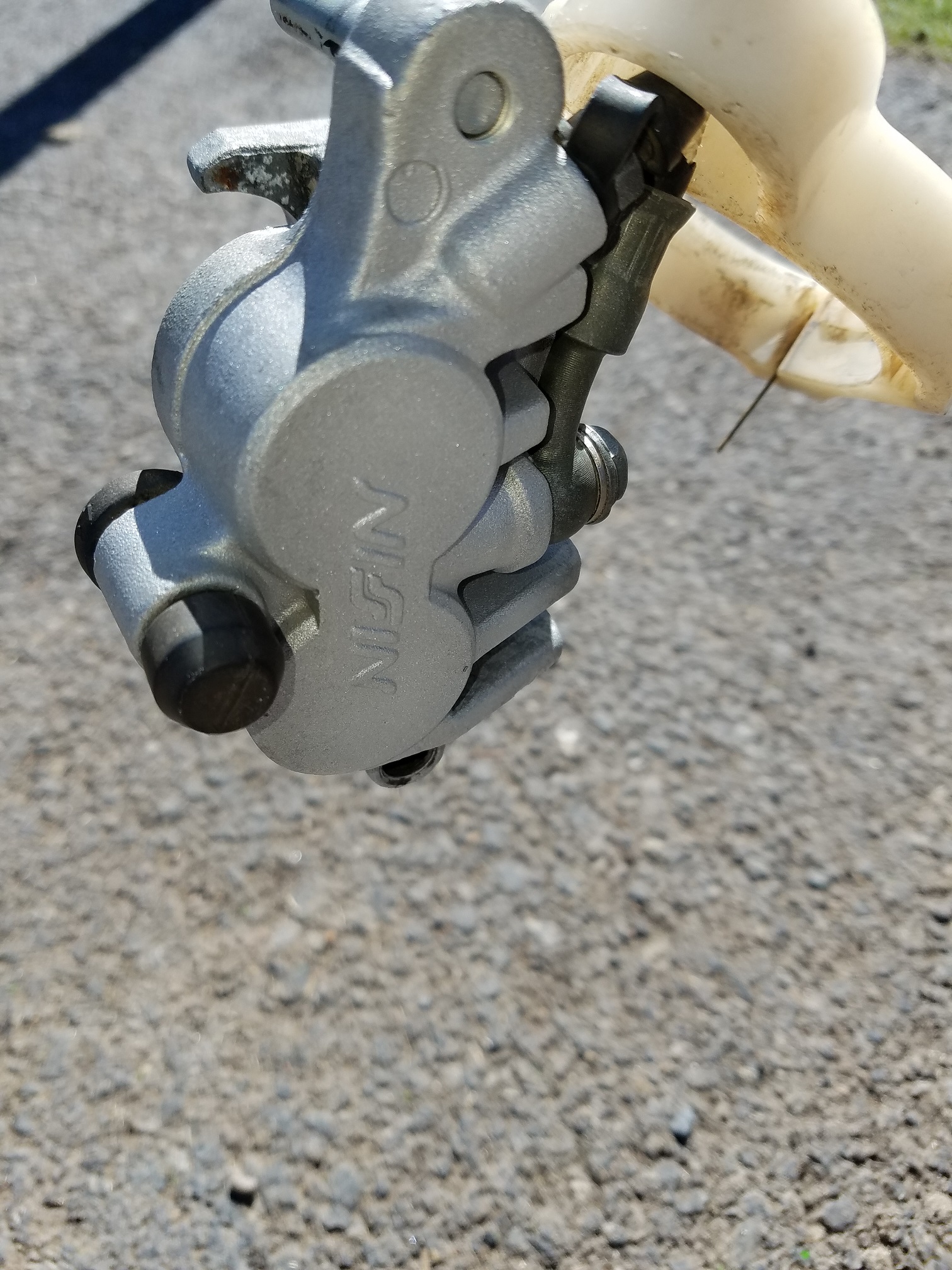

Yep.. Every part is being serviced including the brakes.
Clean, remove the pistons, clean, reinstall with new fluid.
A part that is often overlooked is the pad braking surface.
The braking surface is very porous which fills with dirt, grease, whatever...
All that garbage hurts your braking performance.
These pads are good so I cleaned them up and I'll reinstall them..

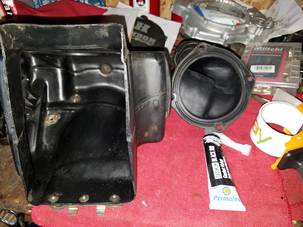

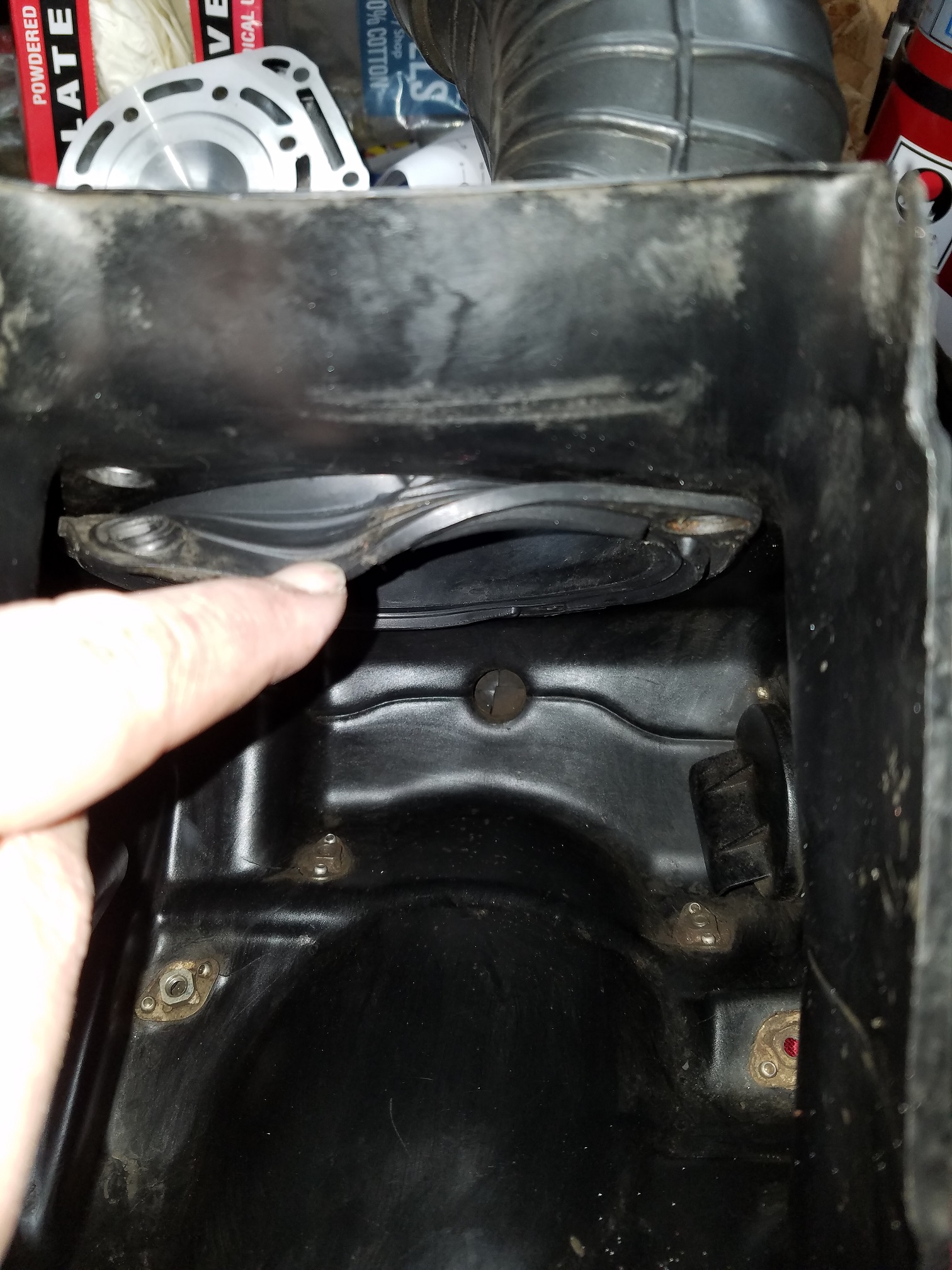

While I had the air box out I disassembled it and scrubbed everything...
Shhhh.... Don't tell the wife... :lol:
Re: Play bike KX500.
It's really important that when you are putting the rubber boot back on that you seal it up.
There is nothing worse than destroying your new top end because of a leaky air box... :o
I seal the boot on both sides of the boot where it touches the box.
That will make sure that no dirt gets through...

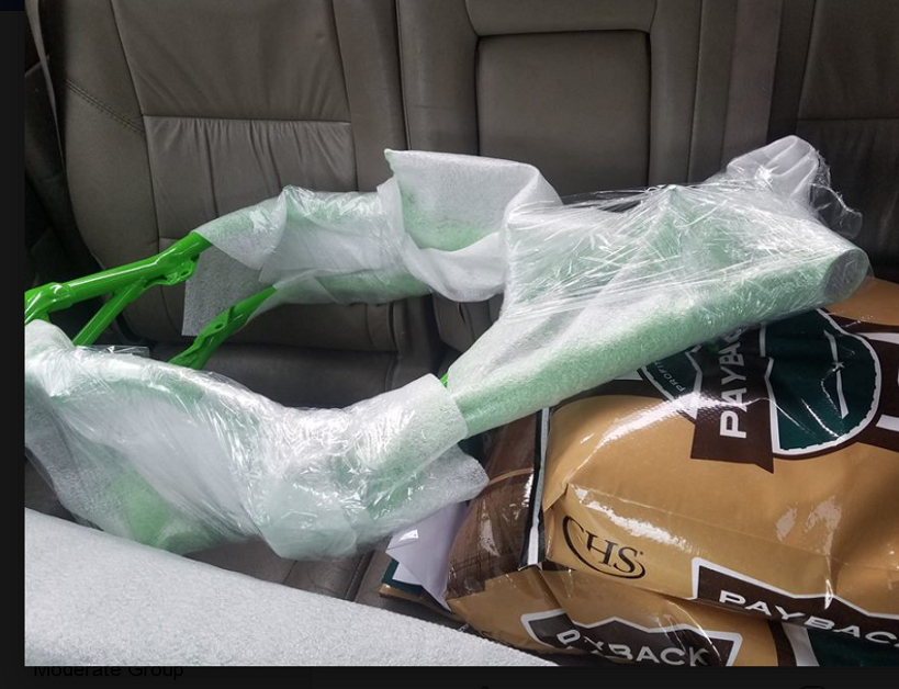

Just got the frame back from Karim Powder coating.
I will check it out better tomorrow...
