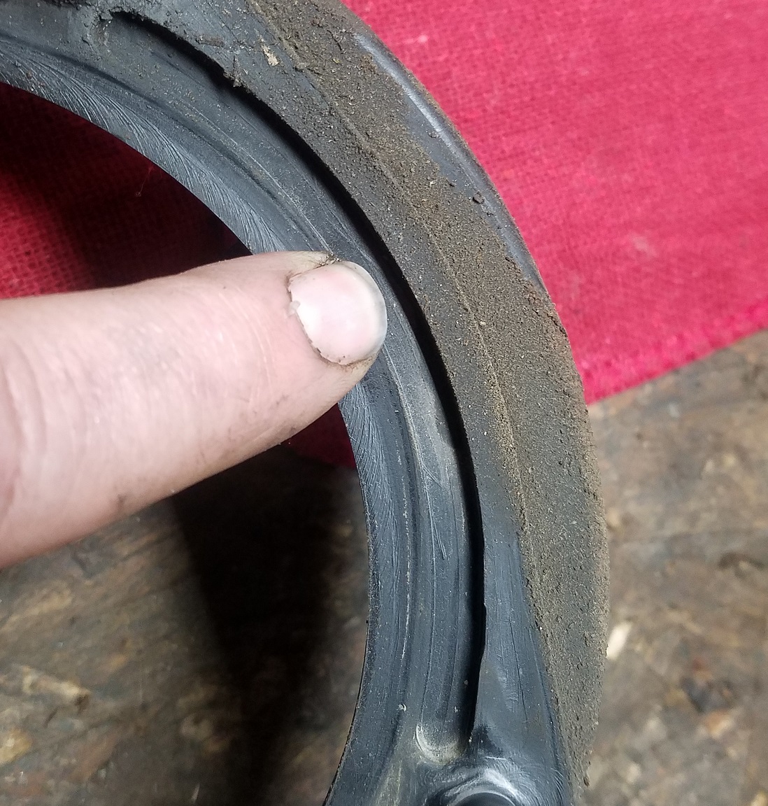

Think about this.. That rubber is what a minimum of 14 years old... most will be older, some, a lot older.
Rubber shrinks, plastic fatigues, and dirt starts leaking in.
Thankfully this air box hadn't leaked yet but it was 18 years old and had low hours on it.

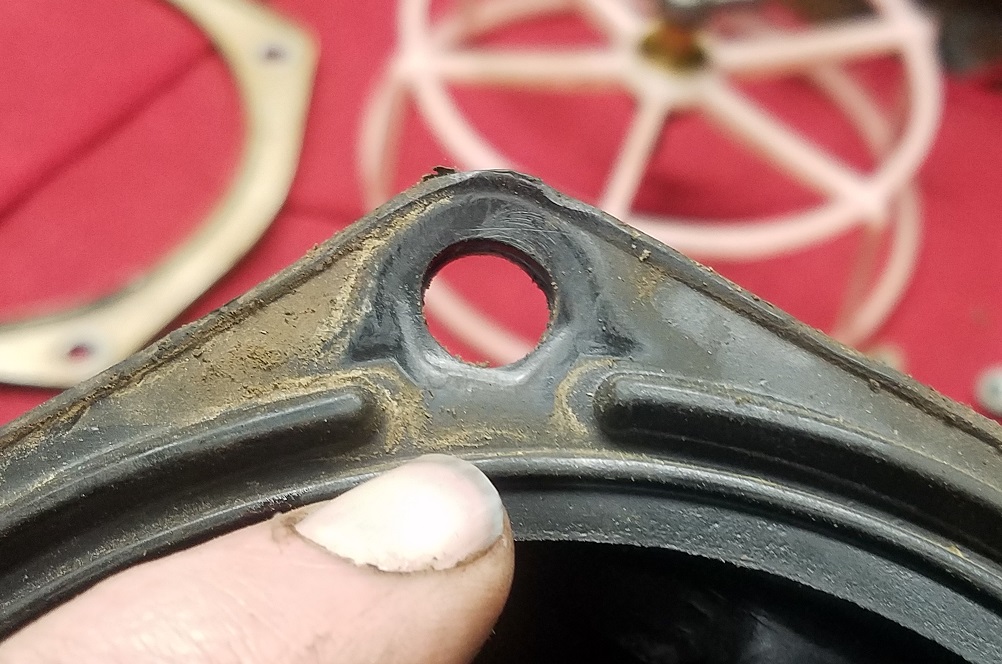

You can see on the next two pics how dirt starts working it's way through to the inner air box and straight into your engine.

On this next pic you can see how the plastic warps, allowing for the dirt to penetrate..
