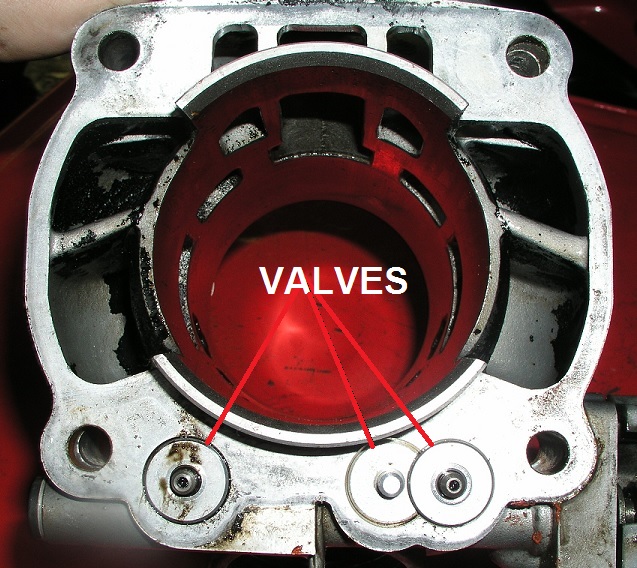

89-04 is easy.
If you have a 3 valve set up it's 89-04 and they are all the same.
89-04 KX500 CYLINDER.jpg (162.47 KiB) Viewed 10086 times

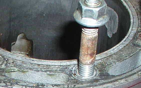

The 88 is the only year of the 3 that uses 8mm standard head studs like this:
88 kx500 cylinder head studs.jpg (88.4 KiB) Viewed 10086 times

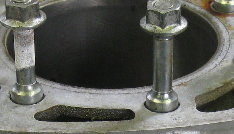

Both 86 and 87 use counter bored studs like this:
86-87 kx500 head studs.jpg (98.94 KiB) Viewed 10086 times
