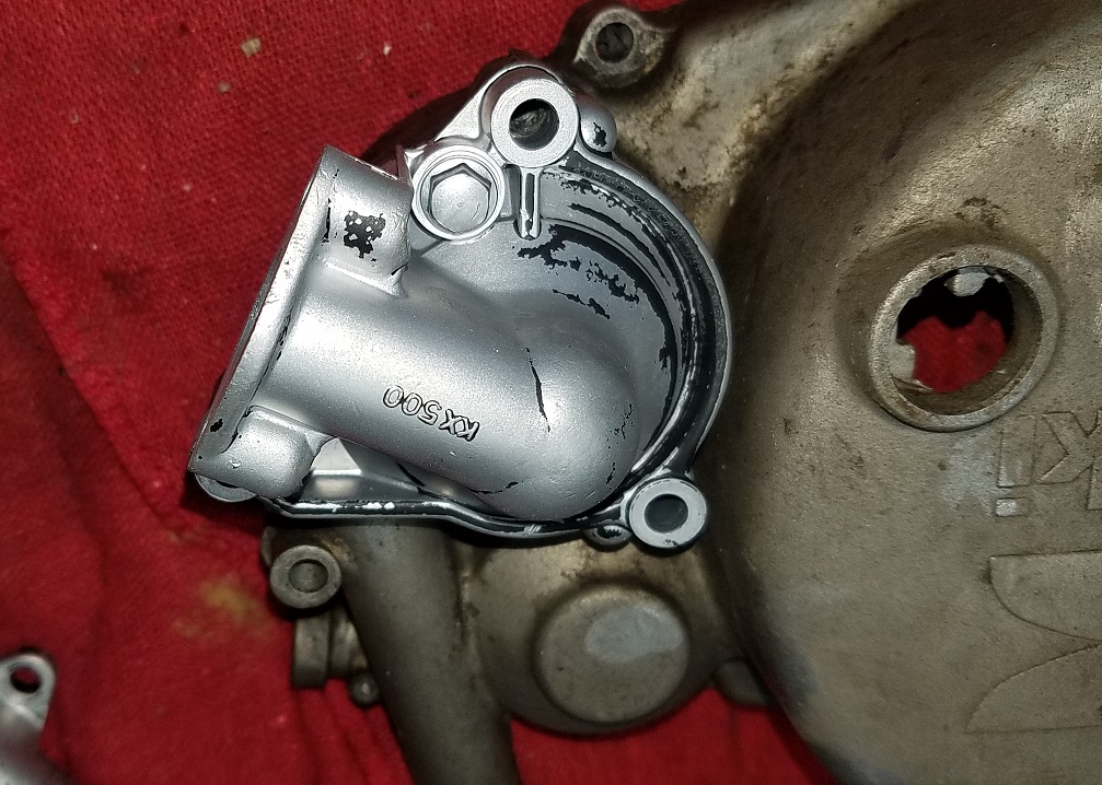

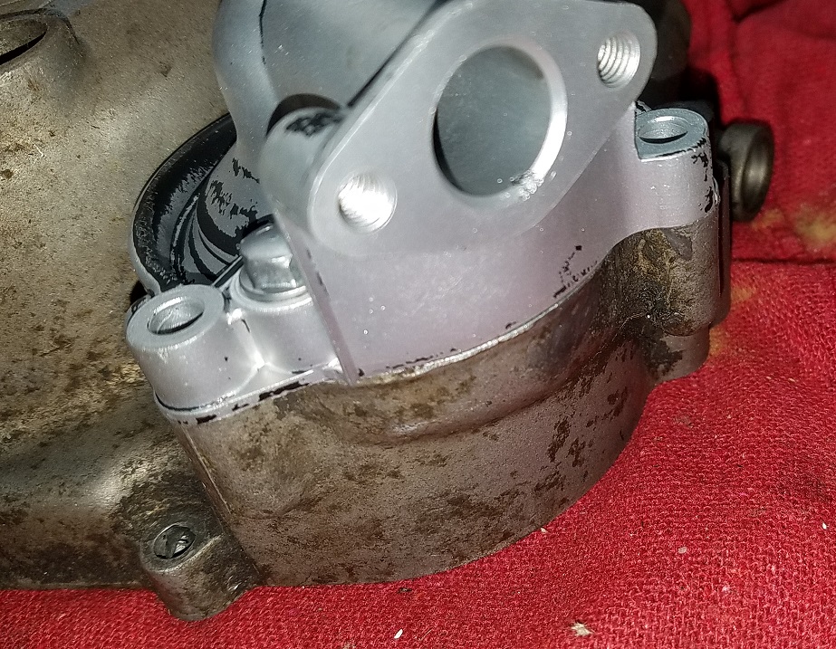

Here is a clear disadvantage of the early model pump cover..

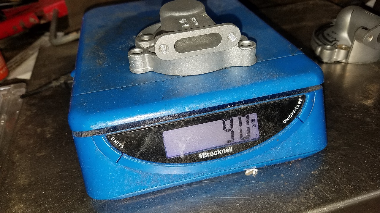

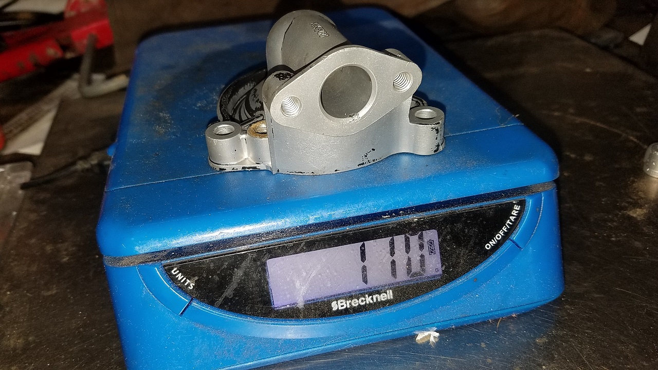

110 grams for the older, 90 grams for the newer...
If every gram counts....

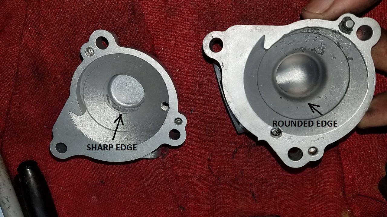

Here's a quick look at the inside of the covers.
First, look at the sharp edge vs the rounded edge..
KX GURU RACING KX500 WATER PUMP COVER 85-86 ON A 89-04 105.jpg (486.48 KiB) Viewed 9554 times
Then look at the intake shape... Round always beats oval for water flow :lol:
KX GURU RACING KX500 WATER PUMP COVER 85-86 ON A 89-04 106.jpg (357.4 KiB) Viewed 9554 times
