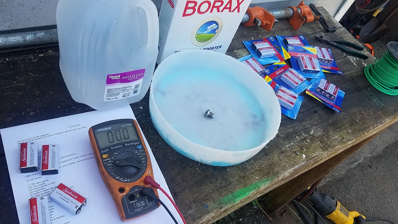

I went to Walmart and then the dollar store.
I picked up some Borax (I needed very little) $6.00
Distilled water $1.00
(20) 9V batteries $10.00
Plastic pan... I used a bucket because my wife got a angry look on her face as I was trying to walk out with some Tupper Ware
After watching another Youtube vid I found out that you can color your titanium at much lower voltages.
That means far less batteries were needed.. (4)
Here is what I picked up:
0-15v brown
17-28v dark purple
20v nice purple
23v starts purple to blue
25v royal blue
32 starts to ligten into the blue
35v blue to silver
42-45v metal grey with a tinge of green
51v gold
58v deep gold
60v starts turning copper
65v pinkish
68v pinkish purple
69v vibrant purple
70v sharp purple
75v dark purple
80v still purple..
85v purple and torquoise
88v turquoise
91v teal
95v teak with hints of green
100v teal with more green
111v turning silver..
120v looks like the original color.
To go back to lower voltage colors you need to strip off the color and start over.

As you can see, 9V batteries when new are a bit high on voltage but should be good enough for this initial test.
I put enough water into the bottom of the pan to cover the bolts I wanted to anodize.
I sprinkled in about 2 table spoons of Borax... probably too much but whatever.. it's cheap
Then I used two alligator clips to attach the wires to the two ends of the battery terminals.
On one end of one of the wires I stripped off about 5 inches of the insulation.
I'm pretty sure I could anodize faster if I used a better anode such as a spoon soldered to the wire.
But this will give me an idea.
Then I dropped in a bolt to the solution and made sure it was covered over.
The I touched the bolt with the opposite wire..
Here is a vid showing the results...
https://youtu.be/NGc0g3jkjHw
