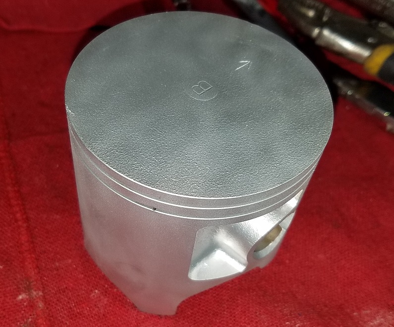

Clean up is very important... Before I even start I have vapor blasted the piston and baked it in the oven at 350 degrees for two hours.

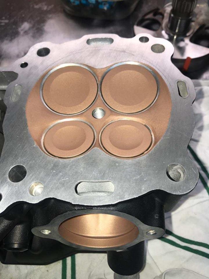

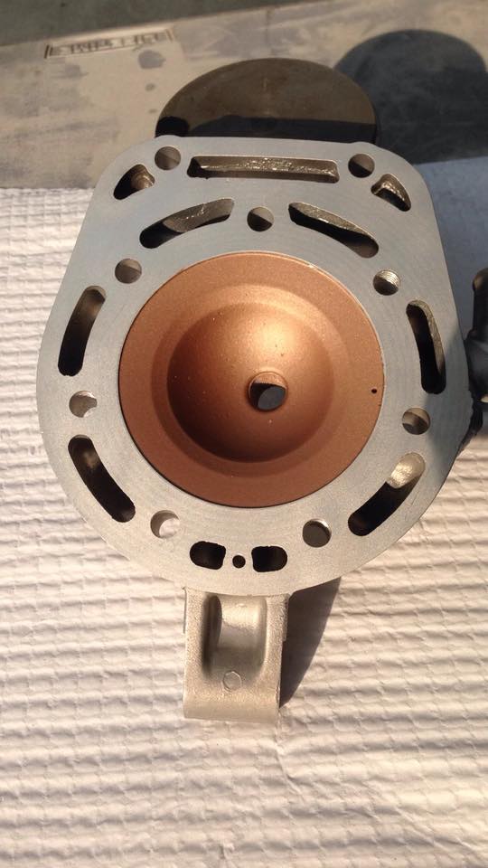

There are many builders that use Cerakote on the heads and in the exhaust ports.
Yes, I will be doing the same as part of my testing..
This was done by Jason Meyers CR500 expert.

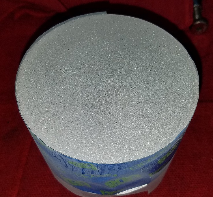

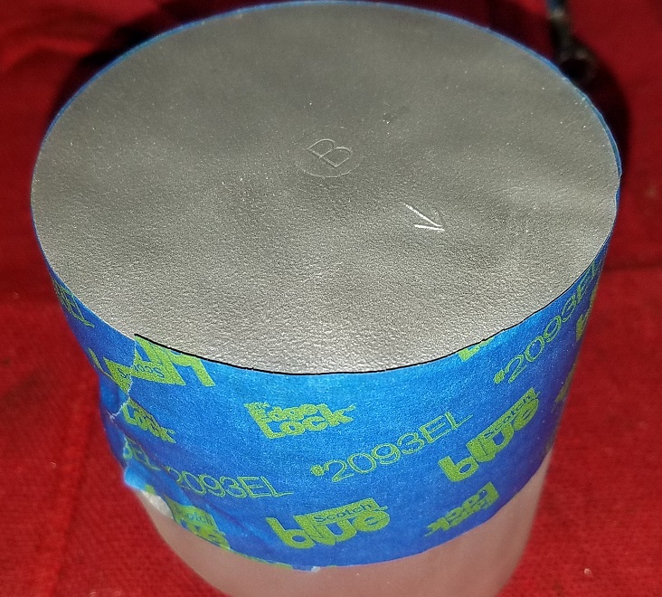

I traded some work for this never used cheapo blast cabinet.
In the directions is says not to use use aluminum oxide.
Guess what I'm using... Yep Aluminum oxide. :lol:
At 40 lbs the media comes out at a low velocity so it won't blast through the metal to quickly :?
Here is the piston ready for blasting.
Here is the results after the aluminum oxide is ran on the dome..

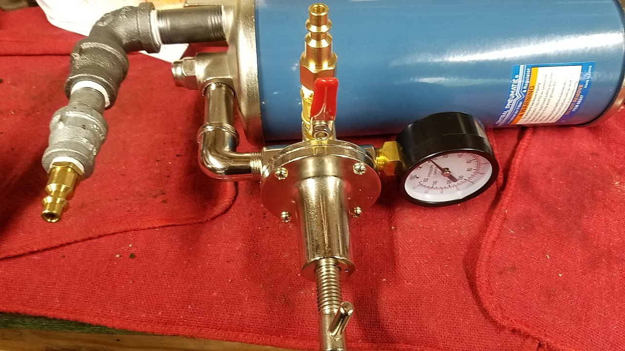

Even though I have a line dryer and several regulators I decided to have one more to be sure nothing bad get's through...
Unfortunately I didn't have everything I needed to plumb it in so down to the local hardware store.
It wasn't easy but we got there... :lol:

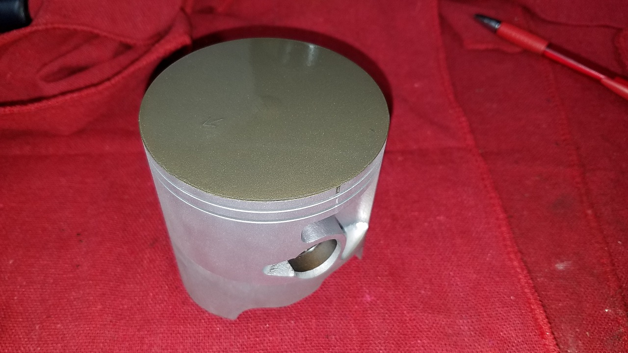

Ok... two coats and ready for the oven..
let sit for 20 minutes, then bake at 175F for 20 minutes.
Last, turn up the heat to 300f for 60minutes then let air cool.
Once cooled we will resume testing 8-)
