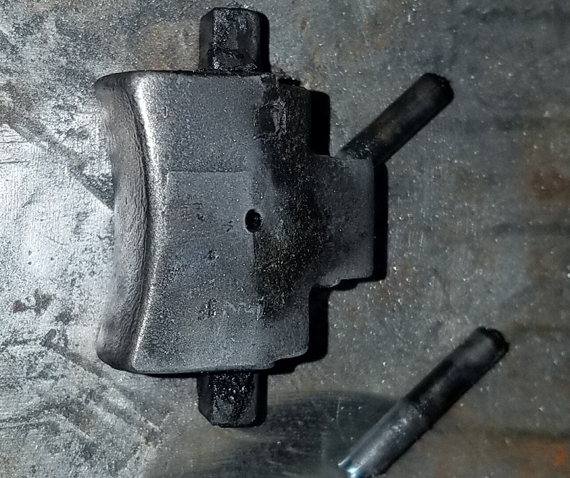

Probably one of my biggest things I have to share is not to remove any more material then you have to.
The center flapper is cast steel and has little pin holes and is generally very rough...

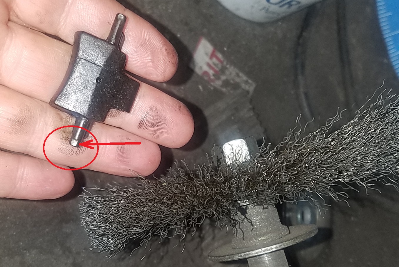

The first thing to do is remove the pins.
You can see from this pic that the ends are very worn.
Remember, for ever .001" of wear you loose .002" of lift.
It is not uncommon to see these worn .020" or more :shock:
.020" of lift will reduce your port timing probably about 2 degrees and create that annoying KIPS rattle which in turn is creating turbulence from the flapper dancing around. Yes, you are loosing HP if you hear that KIPS rattle.

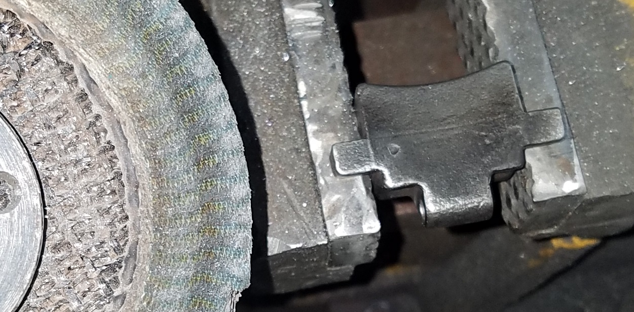

The first thing I do is give the center valve a quick run on the wire wheel to knock some of the carbon and gunk off so I can see what I am working with.
KX GURU RACING KX500 EXHAUST CENTER FLAP 102.jpg (191.19 KiB) Viewed 14697 times
That's better...

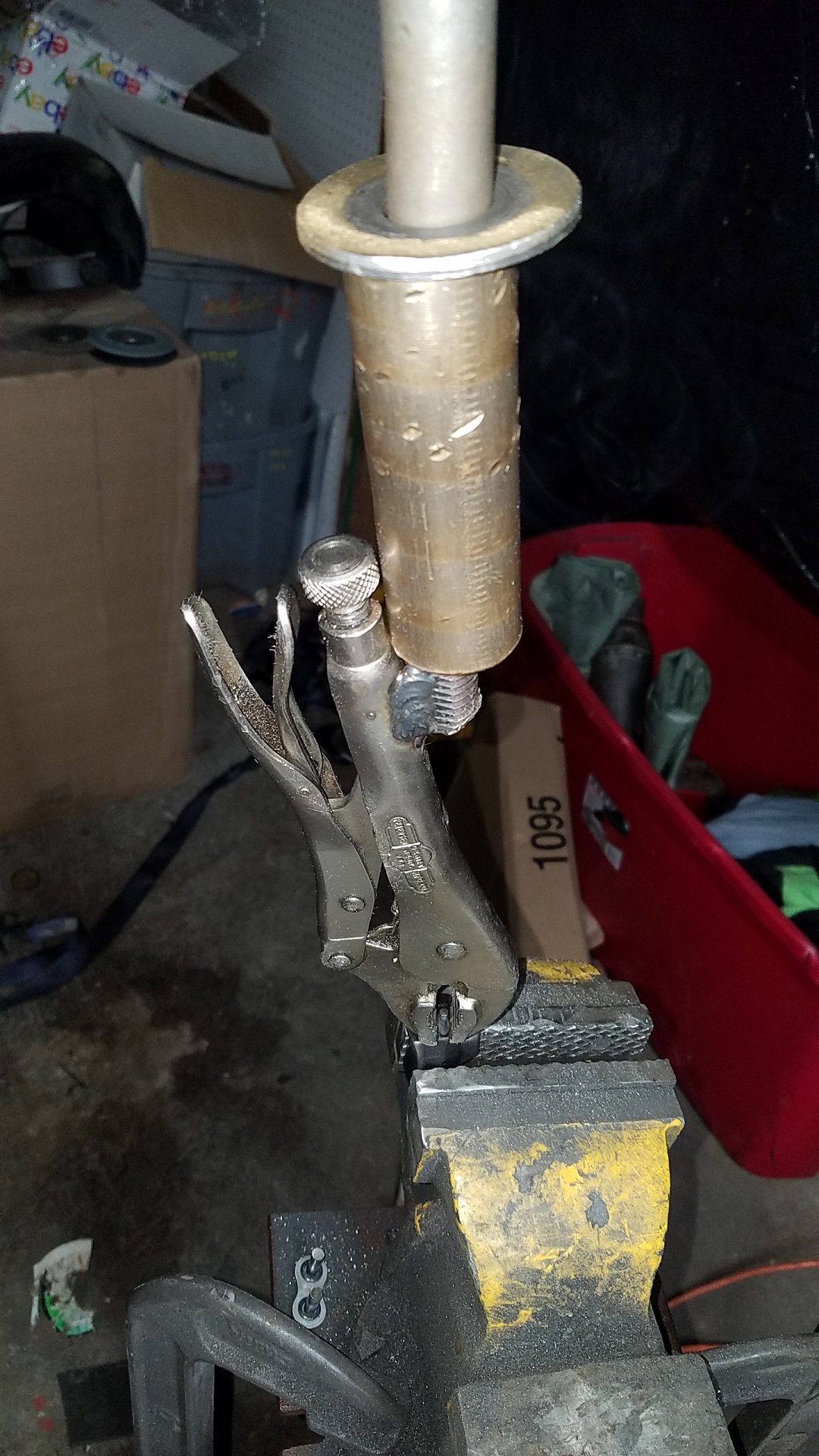

Next, it's time to remove those worn out pins.
So I use a Slidegrip, Map Gas, and a vice.
Before you pull the pins out, measure them and record it.
I like to make mine about 1mm or .040" longer then stock per side.

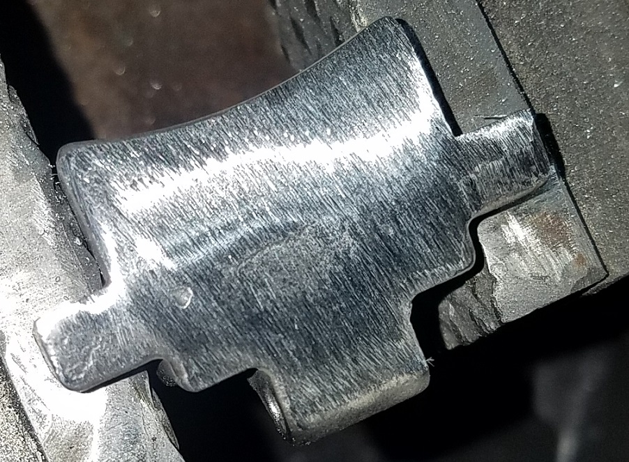

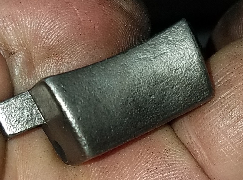

Because the center valve is cast steel it is very rough.
So I use a hand grinder with a fine flap wheel on it.
Remember... You only need to take of a skim... just break that rough surface texture off.
Don't worry if there are some pits and casting flaws... It won't matter...
KX GURU RACING KX500 EXHAUST CENTER FLAP 110.jpg (329.47 KiB) Viewed 14690 times
Re: How to clean and prep your KX500 exhaust valves
Posted: Thu Apr 12, 2018 4:21 am
As you can see, it looks rough but it's not really that bad :lol:
KX GURU RACING KX500 EXHAUST CENTER FLAP 111.jpg (309.44 KiB) Viewed 14689 times

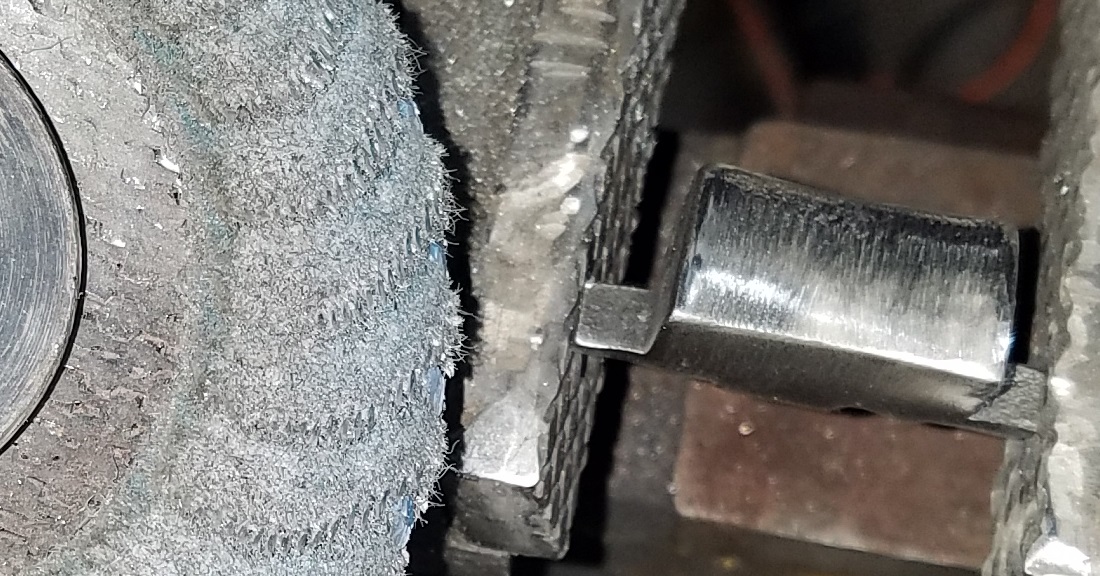

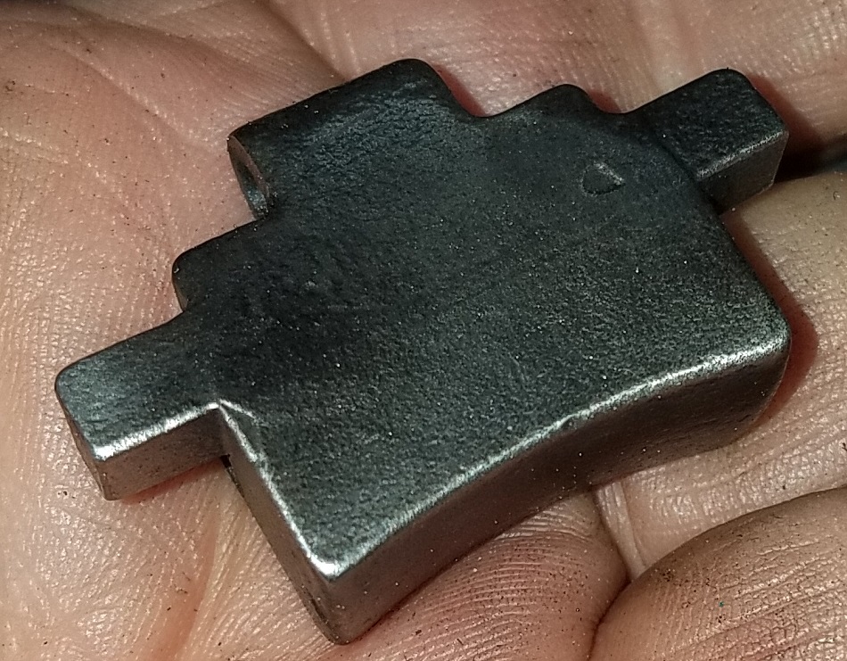

After I get the two surfaces cleaned up, I switch to another flapper wheel which is made from a Scotch-Brite type material.
KX GURU RACING KX500 EXHAUST CENTER FLAP 112.jpg (290.08 KiB) Viewed 14689 times

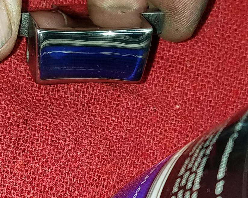

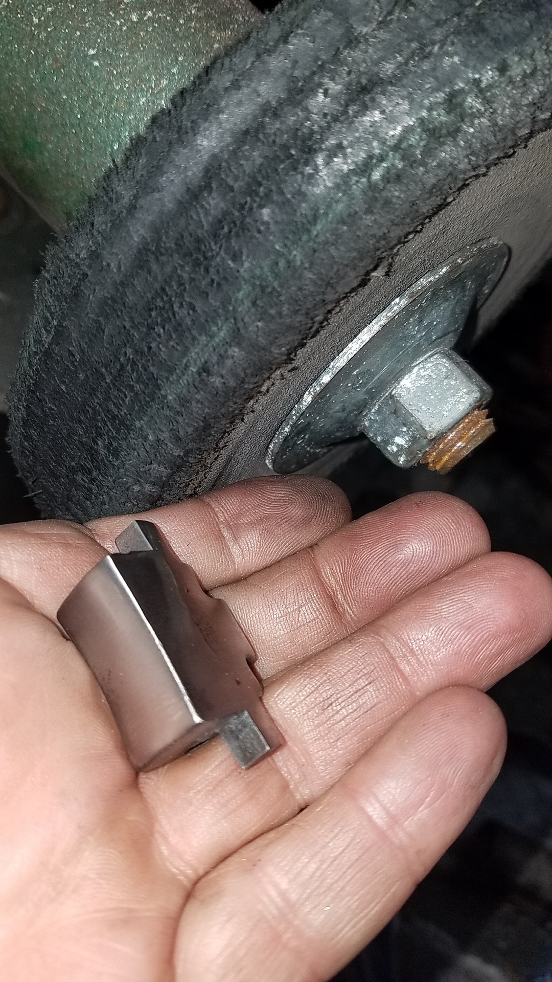

After the flapper wheels are done I run it on a bench grinder or polisher with a cloth wheel.
I use some green polishing rouge.
KX GURU RACING KX500 EXHAUST CENTER FLAP 113.jpg (762.35 KiB) Viewed 14689 times
KX GURU RACING KX500 EXHAUST CENTER FLAP 114.jpg (230.75 KiB) Viewed 14684 times

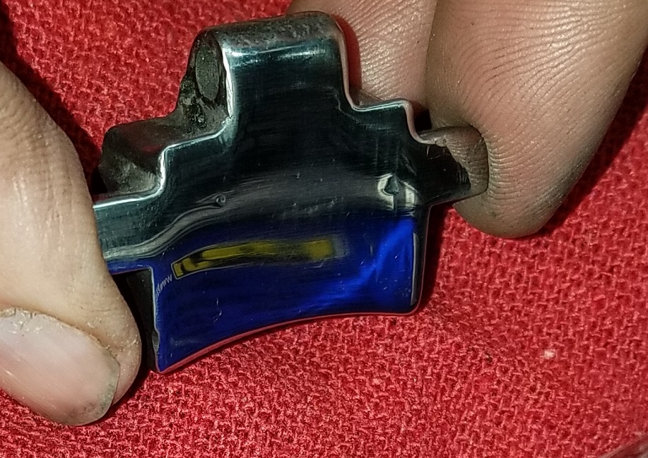

So, the more time you spend, the better and smother it will look.
It took me about 20 minutes for the disassembly and polish.
10 more minutes of time would have been crazy 8-)
Just go easy with the grinders, less is more.

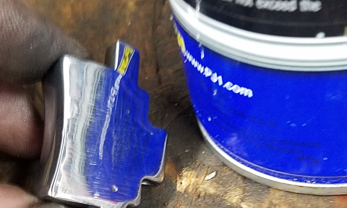

Here is about 5 minutes more on the polisher..
KX GURU RACING KX500 EXHAUST CENTER FLAP 117.jpg (300.58 KiB) Viewed 14646 times
KX GURU RACING KX500 EXHAUST CENTER FLAP 118.jpg (297.89 KiB) Viewed 14646 times
As you can see, you get diminishing results.
Sure, it is better and I could get it better yet but for me it's plenty good enough for what it does :lol:
