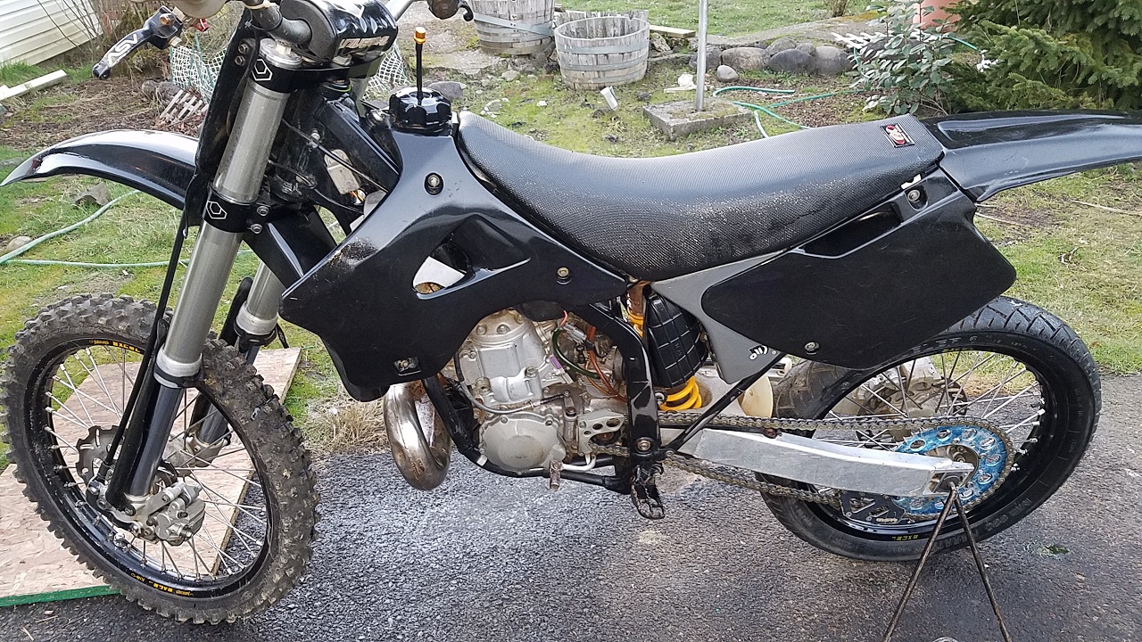

Jason has had this bike kicking around for a lot of years...
In 1998 this was the bike of the year.
It is well worn and the top end is completely clapped out.
I've always focused on the KX500's but we are going to see what we can do on this KX250...
Before we do anything it is getting the air cleaner cleaned up, fresh fuel and oil, new plug, and a street tire on it.
Then it is headed to the dyno so we can have a good laugh at it..

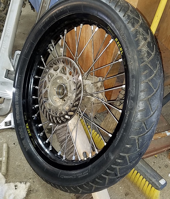

After the clean up and start up, Jason decided that he wanted to use a different wheel and tire for the build...
I guess he was concerned about the extra weight..
After installing the tire he discovered that the bearings were junk.
I just happened to have some new mid 90's Yamaha YZ bearings which fit perfectly..
But, he will have to re-use his seals because the YZ seals are a larger diameter then the Kawi seals..

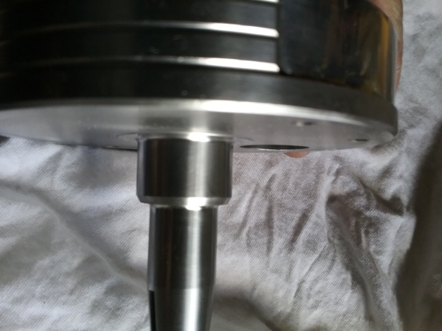

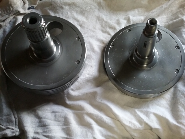

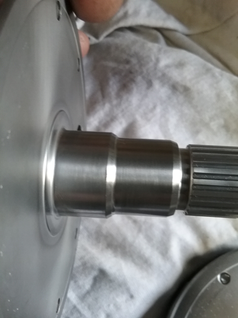

Ok... Jason cleaned and polished the crank and rod.
Remember, send them off dirty and they generally come back dirty.. :shock:

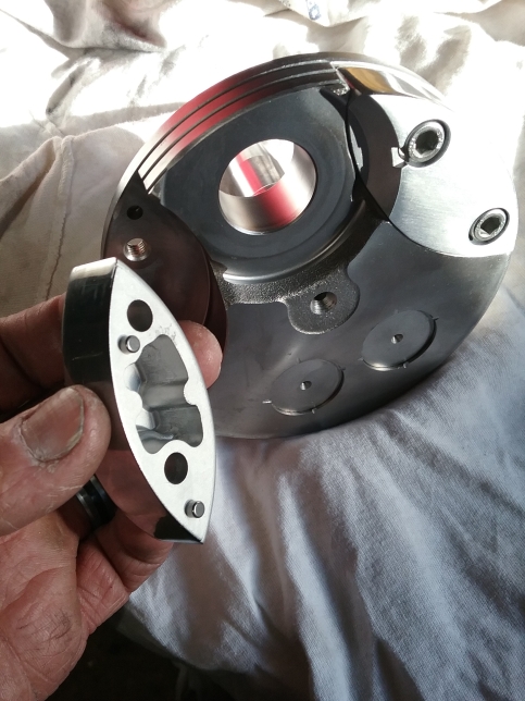

Well... we are a step closer to dyno results.. Steve Parris just finished cutting the crank webs...
60something
Posts: 65
Re: Project Clapped out 1998 KX250... what works?
Post by 60something »
What's the purpose of the cuts in the crank ?
1987 Kawasaki KX500
The original idea was to push more of the charge up the transfers.
What those guys found out was that there was only so much charge in the lower end and sweeping it up the transfers did not produce more charge.
In fact, a lot of guys gained a little bottom end but lost a lot of top end most likely due to increased turbulance.
The idea behind this design is to compress the charge, then send it up the transfers.
Steve Parris has a patent on this design.
According to Steve he is getting about 7 HP gain with a KX250.
So, we shall see what the dyno says.
I'm very excited.
If we can get 4-5 HP I'll be thrilled.
