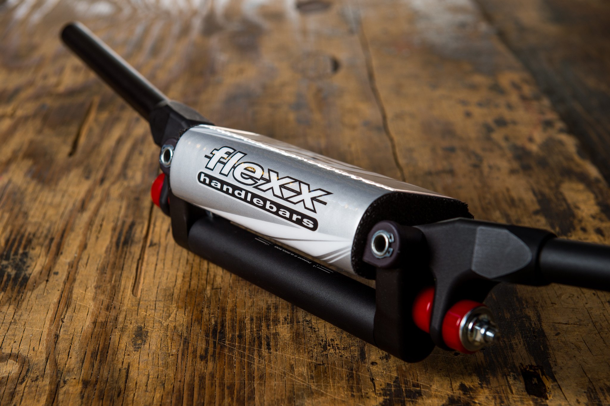

If you have more money to throw at it you can get some flex bars..
flex bars.jpg (400.97 KiB) Viewed 10962 times
A newer product that I have no experience with is MAKO 360 Handle Bar Mounts.
It looks like a great product because it completely dampens the bars from the rest of the bike.
If someone has tried it, let me know...
Maybe a combo of the Flex Bars and the Mako?
