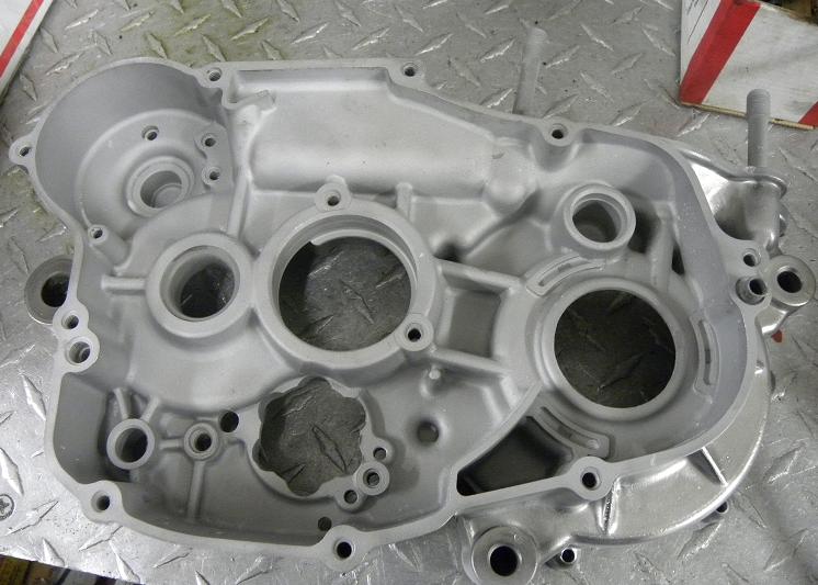

Re: Prepping a set of KX500 engine cases for rebuilding

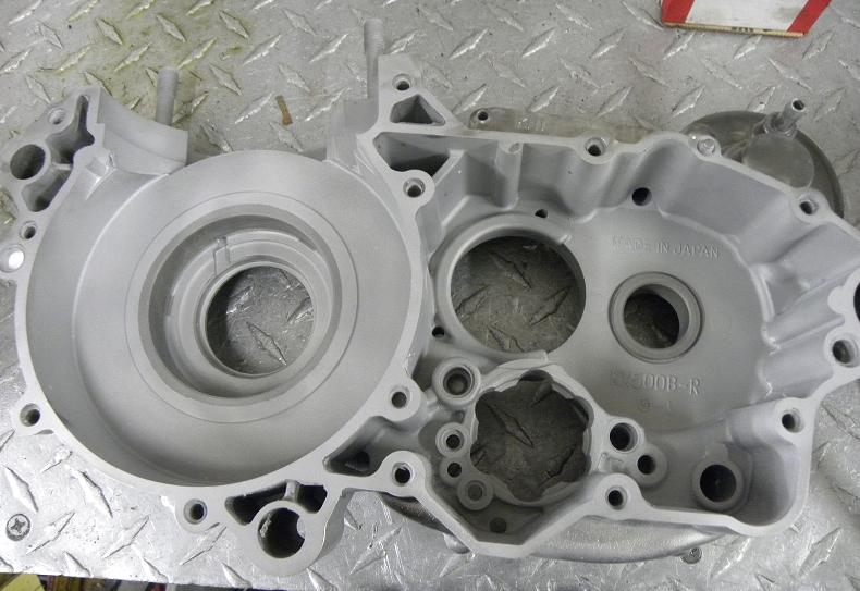

I don't want them highly polished just a nice natural finish. (Again, this was before Vapor blasting)
You can see it in this pic.
ENGINE CASE PREP 1.JPG (43.73 KiB) Viewed 10466 times

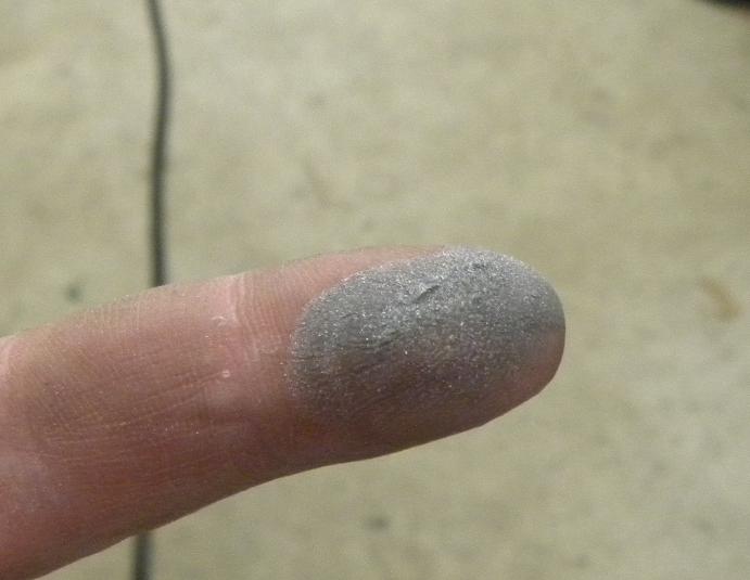

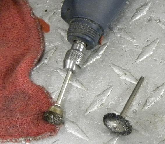

Since I first sand blasted the cases and was warned about particulates being embedded into the surface of the aluminum I took out my trusty Dremel tool and some wire wheels and went to town.
wire wheel 1.JPG (48.72 KiB) Viewed 10145 times
After about 5-10 seconds I started noticing some particulates...
I wouldn't want that junk floating around the inside of my engine :o

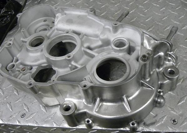

After about an hour I have one side done...
wire wheel 3.JPG (101.99 KiB) Viewed 10145 times
I sprayed some WD-40 on a rag and wiped of the surface.
It's a smooth as a baby's back side :D
I will in time finish the other side (After my Dremel cools off) then I will put it in my parts washer under high heat to hopefully remove any detritus I missed and I will run a small wire brush down the oil holes ect.
Might even make sure the cases are flat before reassembly :D

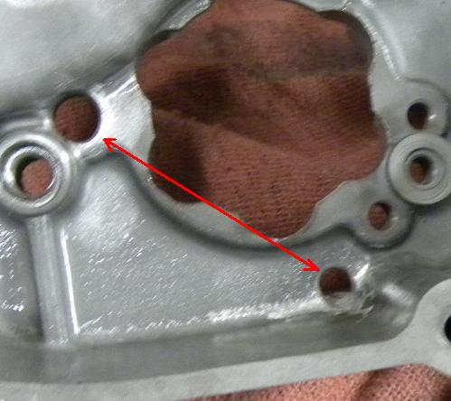

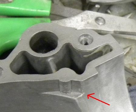

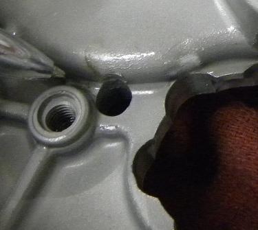

When spending that much time looking around my engine case I started noticing a few details...
case refinements 1.JPG (12.41 KiB) Viewed 10144 times
Does it hurt to leave it?
Apparently not as Kawasaki thought it was ok to leave.
But I don't like it.
Should it be removed?

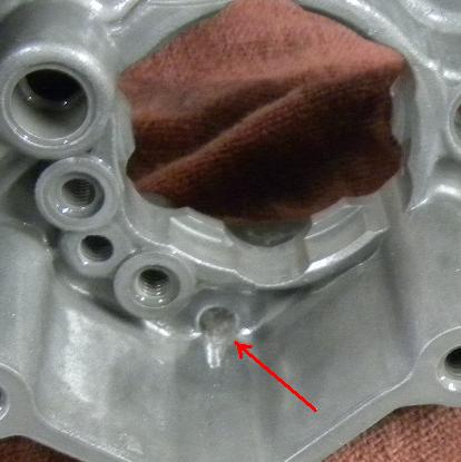

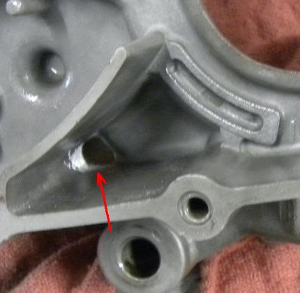

What about this oil hole.
Believe it or not I have a set of new factory cases and this hole does not even go all the way through.
It's as if only part of the hole got drilled :(

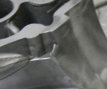

And this hole:
case refinements 3.JPG (11.09 KiB) Viewed 10144 times
Should these be clean up, enlarged, or polished?
YES!!!

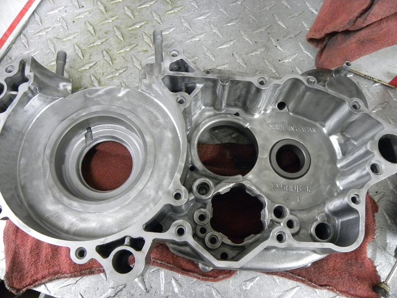

I did a bit of clean up on all the oil galley holes.
I did not enlarge any of them but merely cleaned up the approach and on some the exit holes.

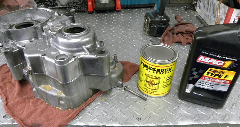

I use 100 grit "very fine" if the cases are not to bad.
For bad cases I use 60 "Medium"
ATF works great as a oil but I have used 30wt, and 10-40 :lol:
What you do is mix up a small bit of the yellow powder with the oil.
Mix it well.
I like to take a small block of wood and screw the bottom case to a wood table top or a small piece of plywood.
Then I liberally apply the Timesaver/oil mix to the mating surfaces of the cases.
I then put a bolt loosely into the end of one of the cases.
Then I move the top case back and forth several times.
Next, move the bolt to the other end of the cases and again move the top case back and forth several times.
I do this in the same pattern that I torque the case bolts.
Around and around we go.
Then check once in a while.. Add more Timesaver as required..
