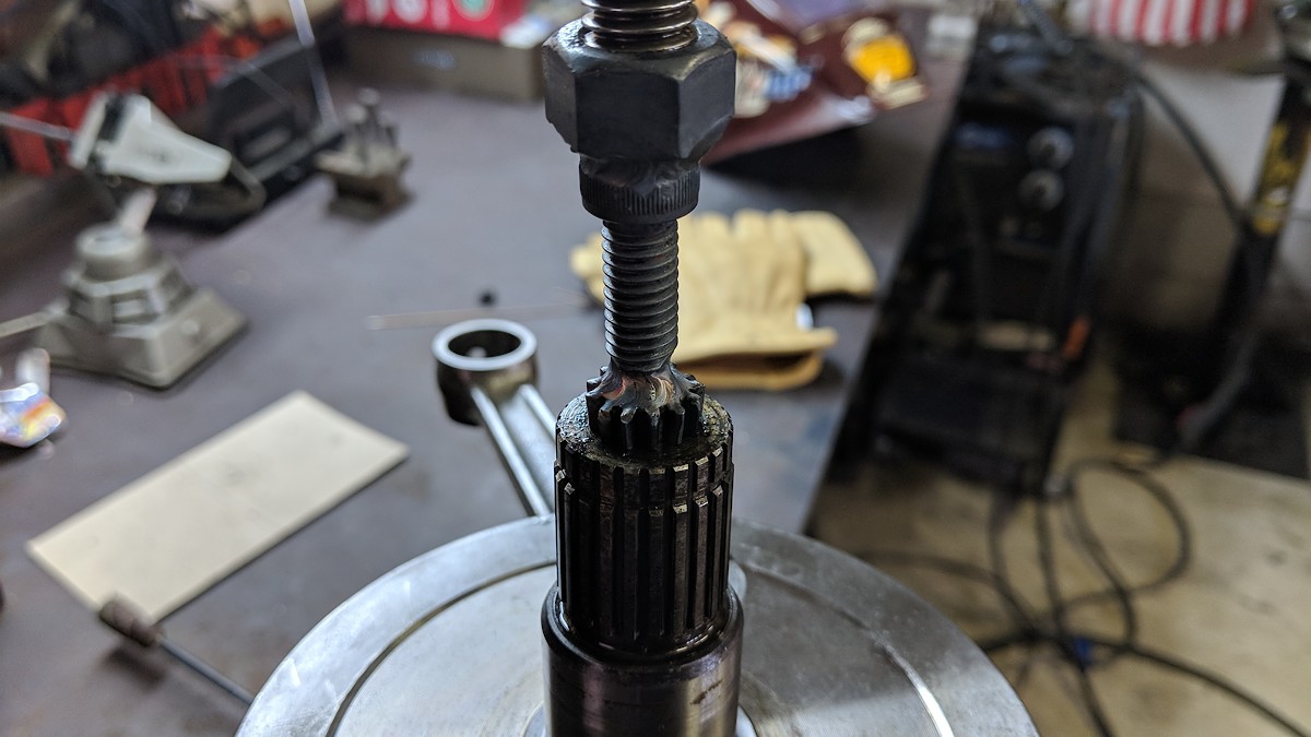

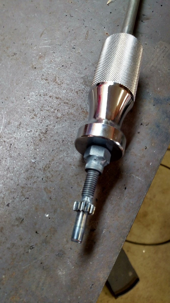

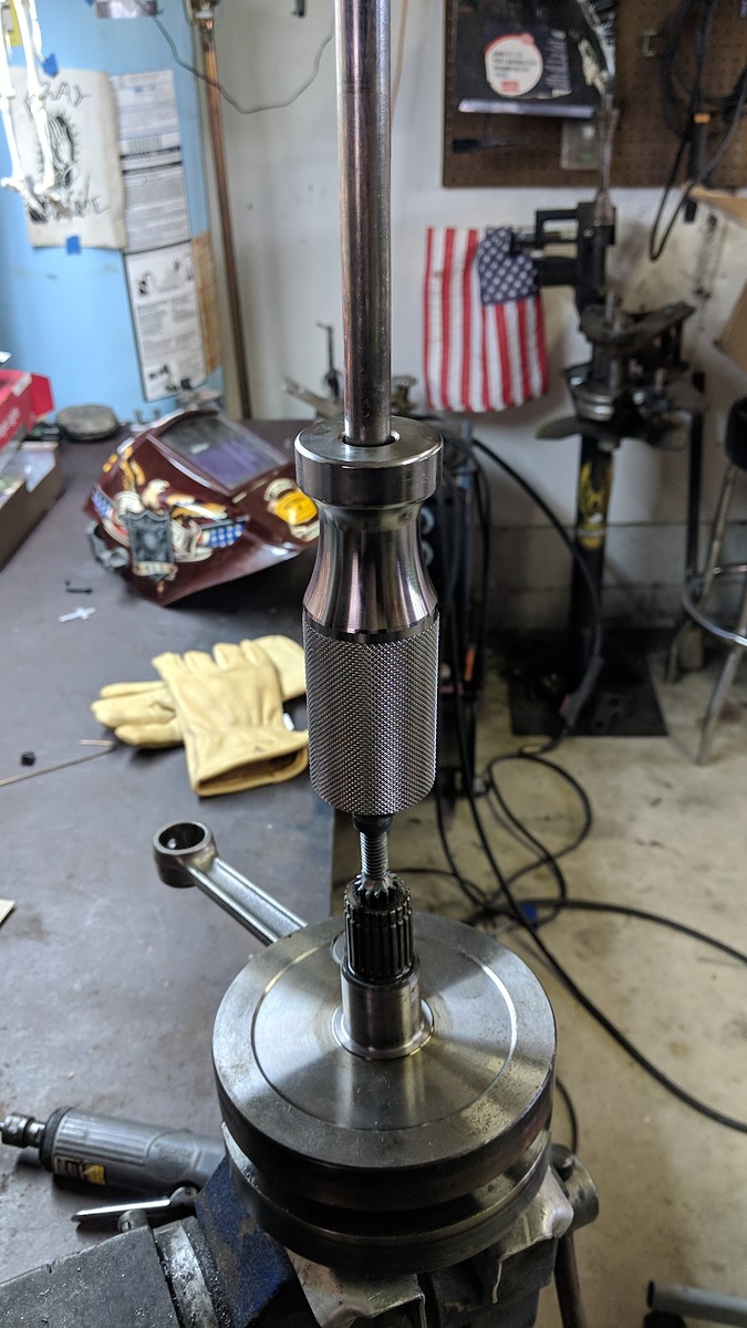

I'm going to weld a nut on, heat the crank a little and try to slide hammer it out.

Propane heat was not enough, had to fire up the oxy/acc torch.
Re: KX500 Crank Gear Spur for impeller/water pump. Question
Very nice.
You can certainly weld a lot better then me.
Most of the time guys break them off which is why they need to replace them :lol:
Great job!
