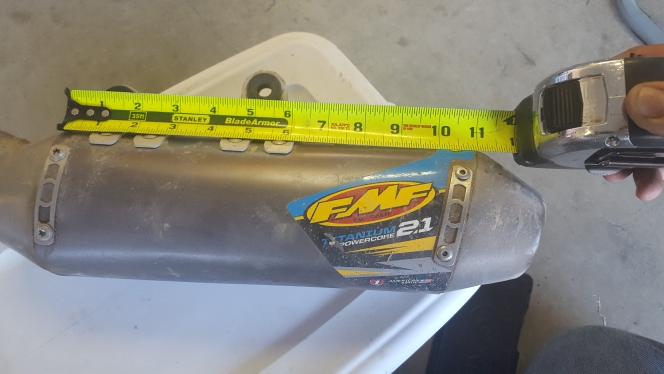

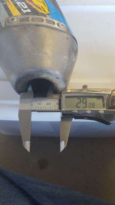

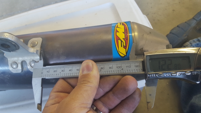

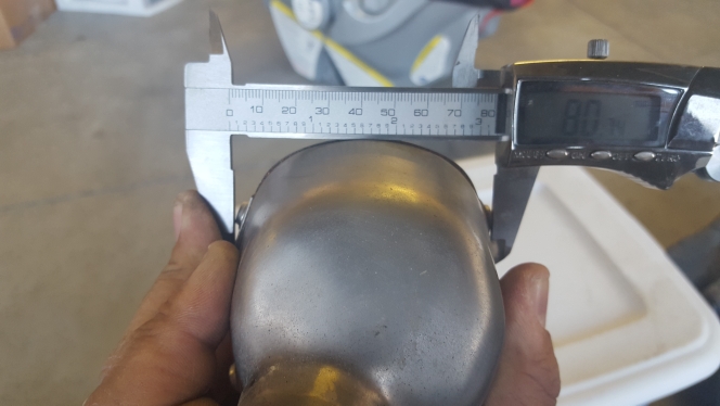

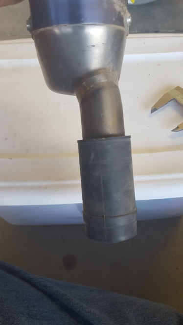

Ok guys.. We had a lot of requests to get FMF to make some custom mufflers like the one they did for Sean Collier's The Beast!
Unfortunately FMF isn't able to mass produce these mufflers at this time...
So, what are you going to do?
I say, make your own...
But how?
Well... The story goes that FMF grabbed a 4t muffler and re-rolled it for the KX500.

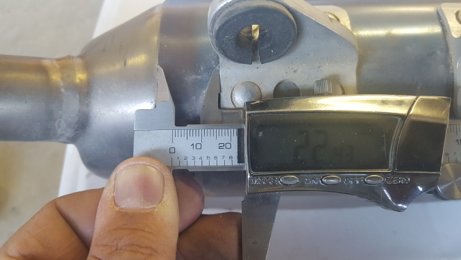

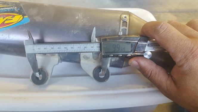

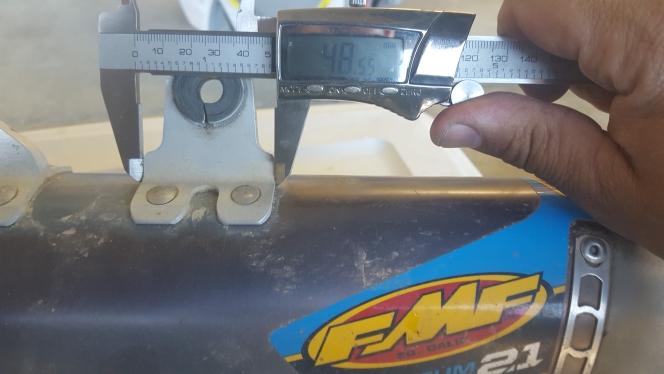

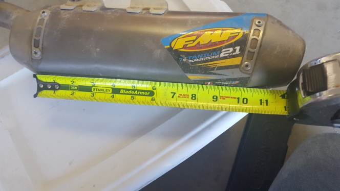

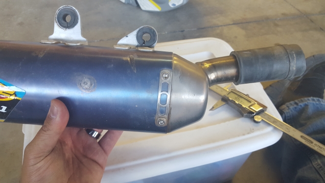

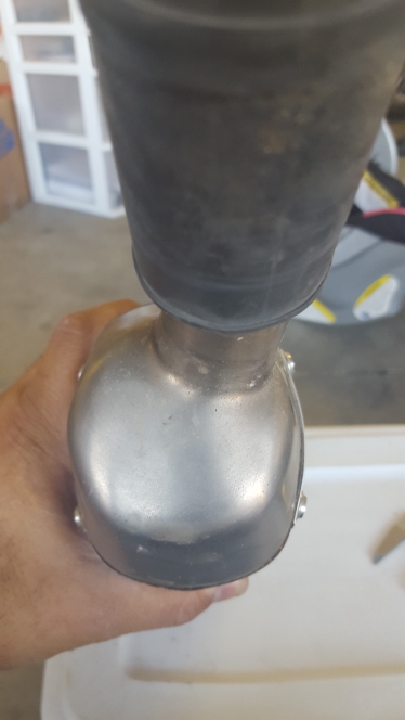

So, if you have a old FMF muffler laying around and you can cut, bend, and make some new connections... Here's some measurements for you..
WWW.KXGURU.COM SEAN COLLIERS THE BEAST MUFFLER 101.jpg (161.71 KiB) Viewed 8613 times
WWW.KXGURU.COM SEAN COLLIERS THE BEAST MUFFLER 102.jpg (155.72 KiB) Viewed 8613 times
WWW.KXGURU.COM SEAN COLLIERS THE BEAST MUFFLER 103.jpg (150.32 KiB) Viewed 8613 times
WWW.KXGURU.COM SEAN COLLIERS THE BEAST MUFFLER 104.jpg (158.57 KiB) Viewed 8613 times
WWW.KXGURU.COM SEAN COLLIERS THE BEAST MUFFLER 105.jpg (148.85 KiB) Viewed 8612 times
WWW.KXGURU.COM SEAN COLLIERS THE BEAST MUFFLER 106.jpg (144.42 KiB) Viewed 8612 times
