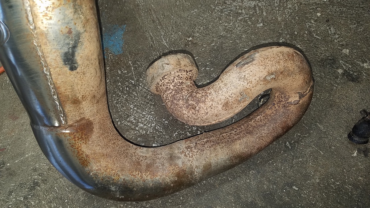

Here is a pic of a expansion chamber that is in really poor condition.
So, how do you get one like this clean?
Believe it or not I got this one to this point in about 30-45 seconds..

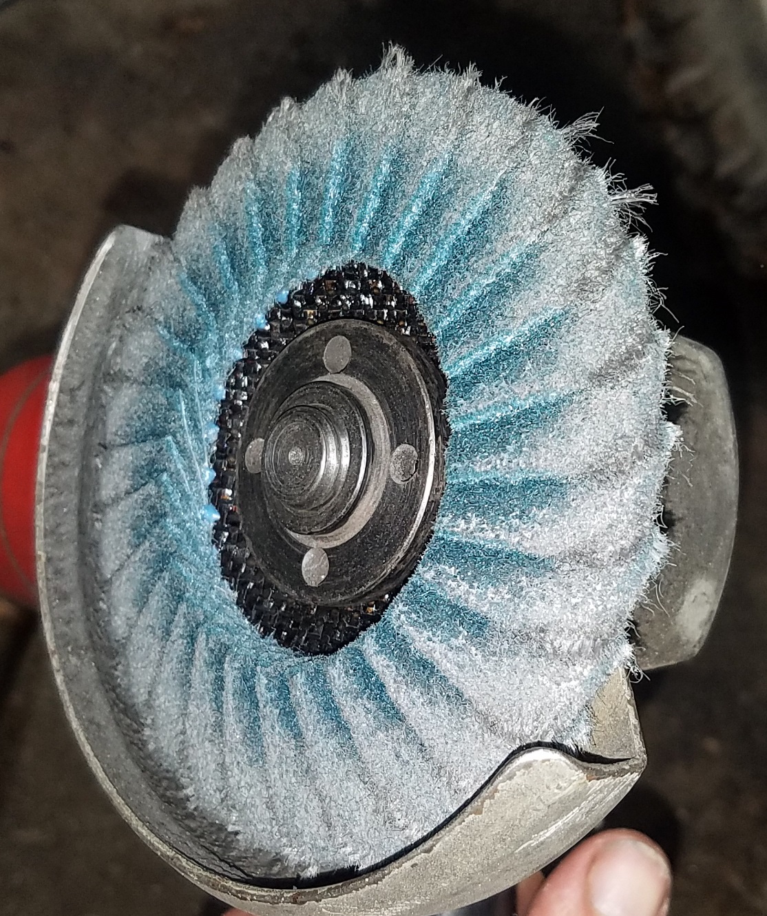

Just need one of these..
Here is what the flapper is

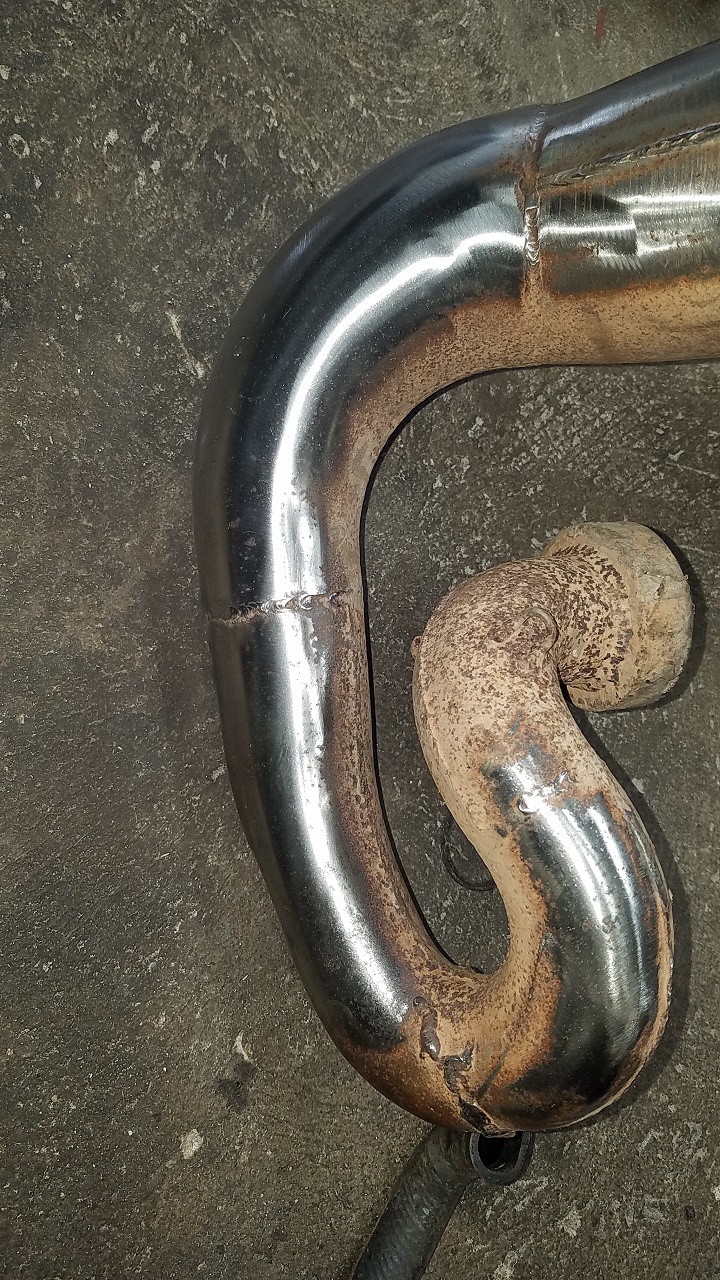

Here is another section of the pipe..
This took 15-20 seconds

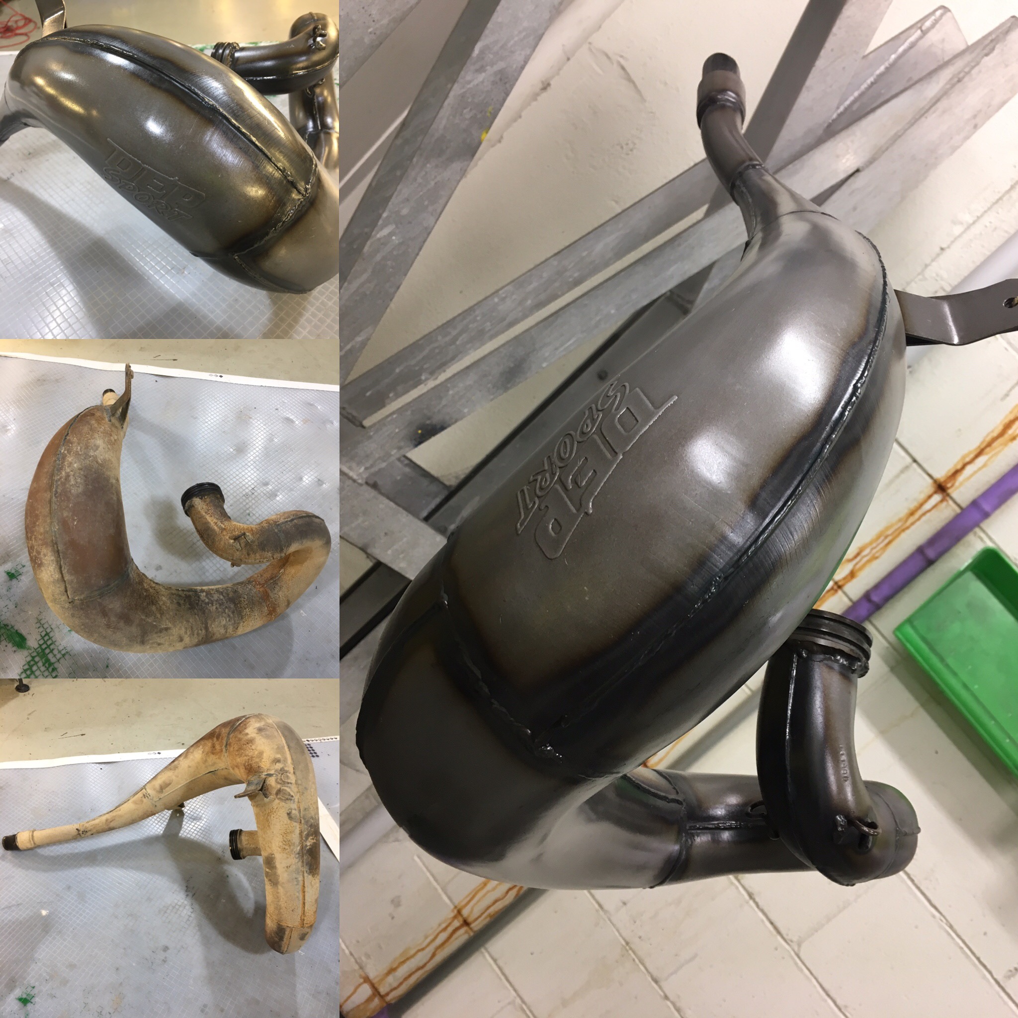

Re: How do you clean up your expansion chamber?
Posted: Fri Nov 10, 2017 3:48 am
