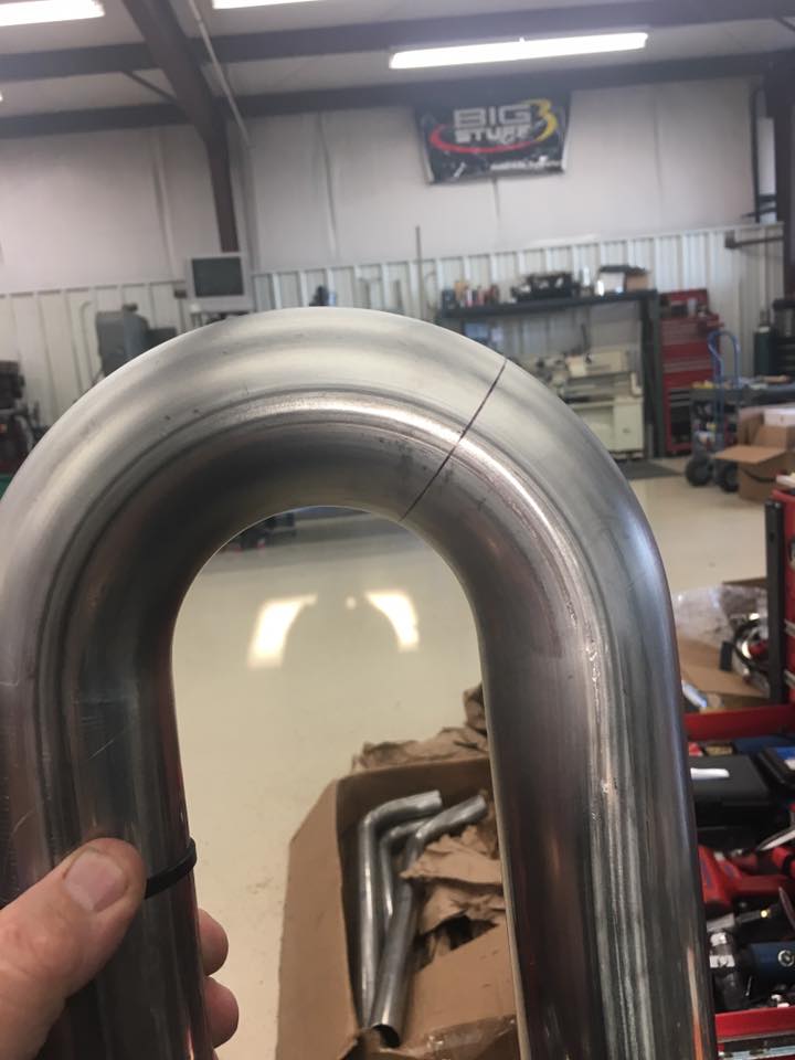

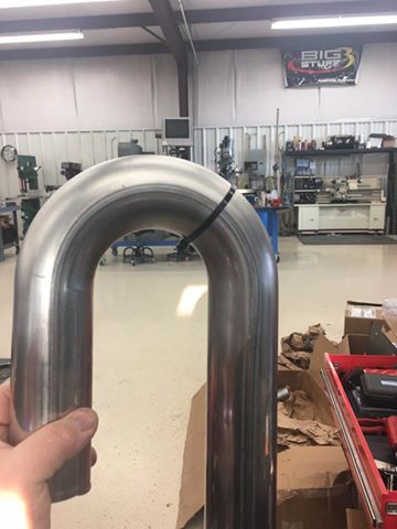

Charles Wooten from Facebook shared this simple easy trick for marking and cutting pipes and keeping it straight..
Here is his words..
Want to share a little trick i use when building headers or cutting tubing in a radius ..... take you a simple zip tie and tie it around the tube and it allows you to slide it back and forth to set your angles along the way its keeps your cut lines stright to cut all your cuts tanget so all your bends line up as they should
