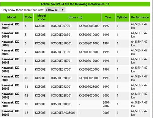

Still i have a question about the frame ids since their different here.
Heres one for example KX500E-000282.
Didnt find any numbers from the forums that would explain which year model would it be. Maybe im just too thick? :?
I guess ill just find out if i can even get one of these on the road legally and hope one comes on sale!
Re: New guy... tips appreciated
Posted: Thu Aug 17, 2017 1:55 am
I have very little on Non US frame numbers but I can tell you that it is PRE 92
