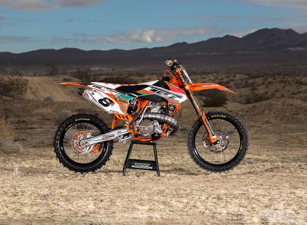

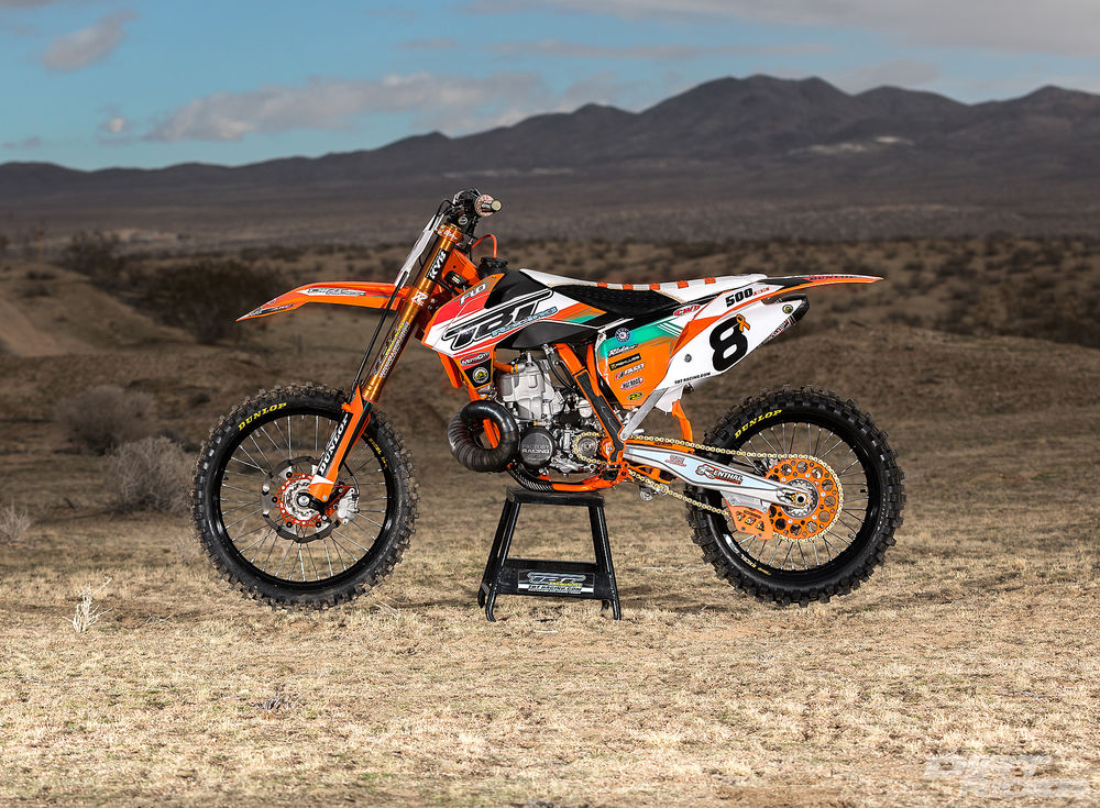

KTM 350 with a KX500 Engine
This is not my build:-)

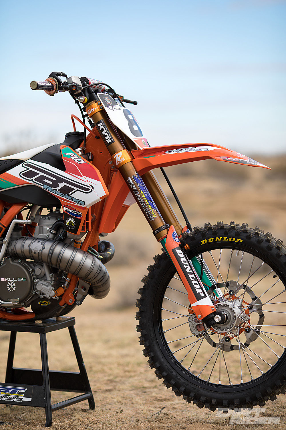

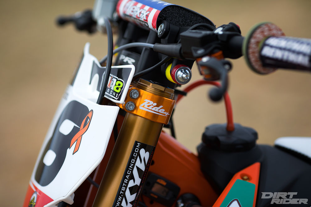

1.Suspension: TBT Racing kyb pfs2 conversions. Valved for vet MX. Not the same forks in the photo!!!!
2. Shock: TBT racing Bladder kit and re-valved for vet MX.

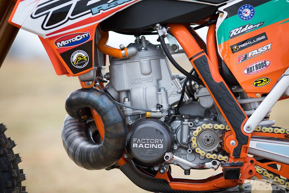

3. Motor: Crank balanced and trued by CrankWorks with a Hot Rods connecting rod. Cylinder had the ports cleaned up and re-plated, head was cut as well! Every bearing, shift forks and many of the gears were replaced. The cases were media blasted and polished for that "factory" look.
4. Custom seat concepts seat

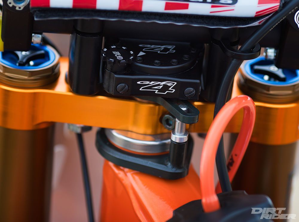

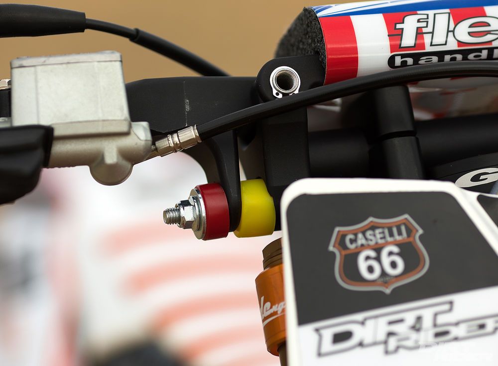

5. GPR stabilizer
6. Fasst Flex bars and foot pegs
7. TM designs slide and guide kit
8. Renthal chain, sprockets and Grips
9. Dunlop MX3S tires
10. Boyeseen Rad valve and ignition cover

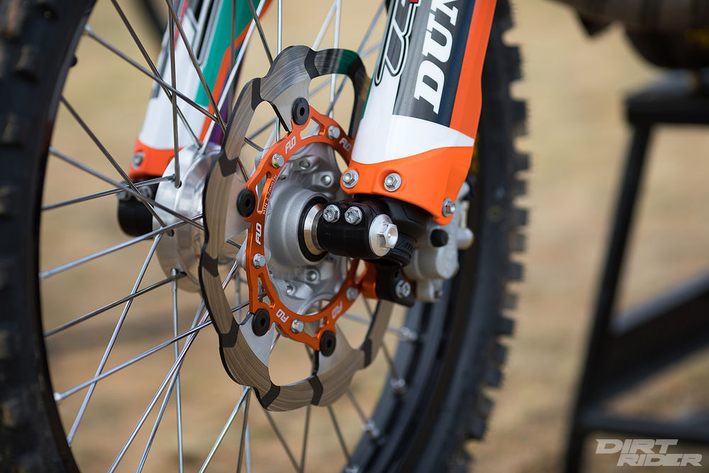

11. FLO 270mm big rotor kit
12. Brand New Excel wheels with OEM hubs
13. ARC Memlon levers

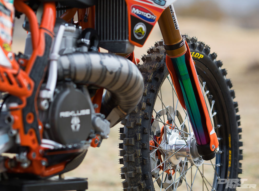

14. Rekluse clutch cover with new OEM clutch
15. Scalavini hand made cone pipe
