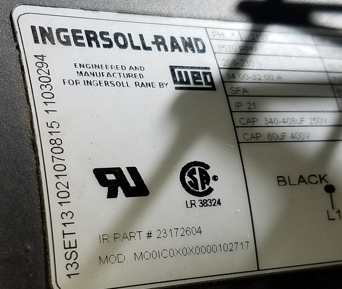

I bought a Ingersoll Rand 7.5HP 220V Single Phase Compressor 4 years ago brand new.
The motor is manufactured by WEG. The IR Part# 23172604
It has performed flawlessly.

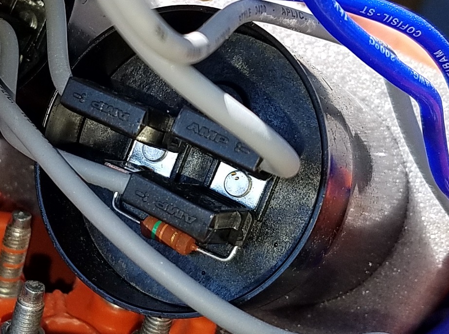

Suddenly it would no longer start up.
The voltage going to the compressor is good, the fuses in the control panel are good.
When you turn the switch on the motor starts to turn over, then quits.
So I called the company it was purchased from and they said likely it is one or both of the Start Capacitors.

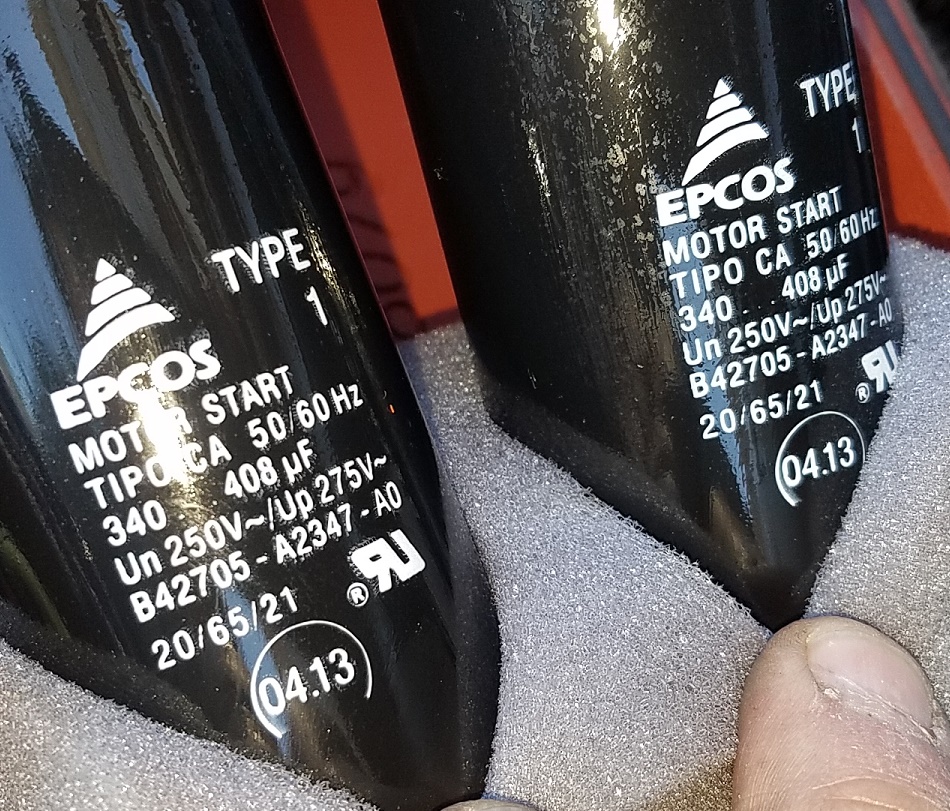

The Start Capacitors are as follows:
EPCOS
Motor Start
TIPO CA 50/60 Hz
340...408uF
Un250V~/Up275V~
B42705-A2347 - A0
20/65/21
Start Capacitor IR # 38474847
And just in case you need it eventually the Run capacitor is IR # 38474854

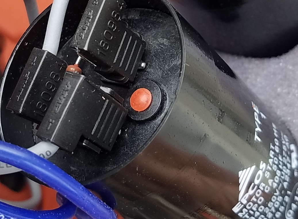

compressor 101.jpg (418.74 KiB) Viewed 19302 times
compressor 2.jpg (273.02 KiB) Viewed 19302 times
compressor 4.jpg (273.84 KiB) Viewed 19299 times
compressor 3.jpg (330.44 KiB) Viewed 19299 times

After speaking to the sales person I was told that I had the correct part picked out.
The item number Item #: CWEG340E250
I've got two of them ordered and we will see what happens...
Re: Ingersoll Rand 7.5HP 220V Single Phase Compressor
One of the other Capacitor sites emailed me back and confirmed that CWEG340E250 is the correct part.
So hopefully I'll have a compressor again next week.

Happy days!
I received the two capacitors today, had them plugged in within a few minutes.
Plugged in the power chord.
Turned the switch and it fired right up.
Not only that but it starts way faster then it was starting.
Apparently one capacitor was bad for a while putting all the load on one..

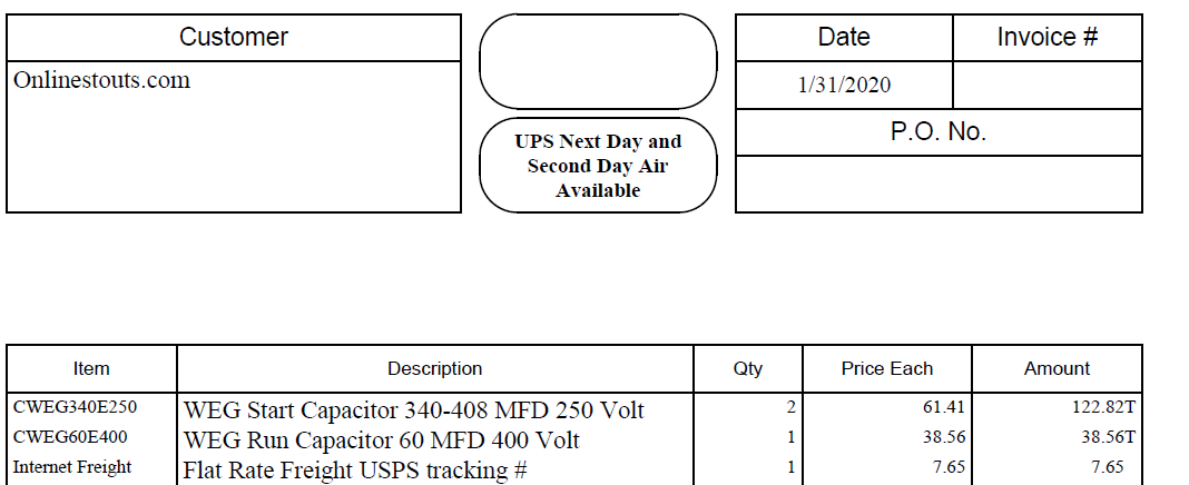

A guy named John hit me up out of the blue about this posting.
He found the info useful and hopefully you will too..
After a few emails he wrote:
Thank you, again -- your posting probably saved me a $200+ service call.
John
Here is a copy of his invoice.
COMPRESSOR CAPACITOR.png (45.6 KiB) Viewed 17512 times
