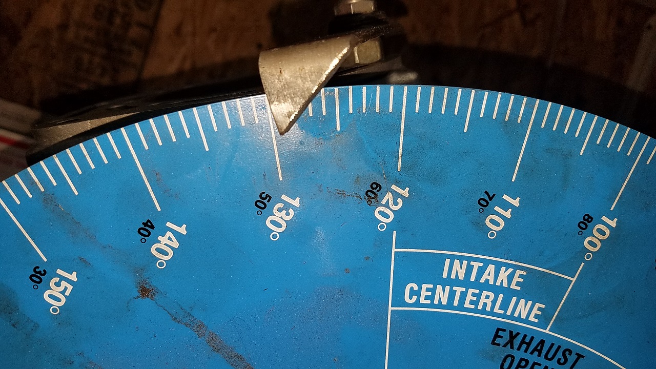

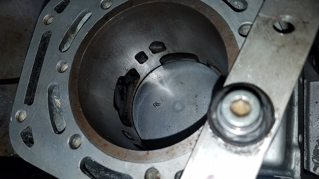

Start with the piston so that it just covers the top of the exhaust port...
KX GURU RACING KX500 PORT TIMING NUMBERS 110.jpg (414.36 KiB) Viewed 16202 times
Make sure that the indicator is lined up and record the starting number.
KX GURU RACING KX500 PORT TIMING NUMBERS 103.jpg (396.21 KiB) Viewed 16202 times

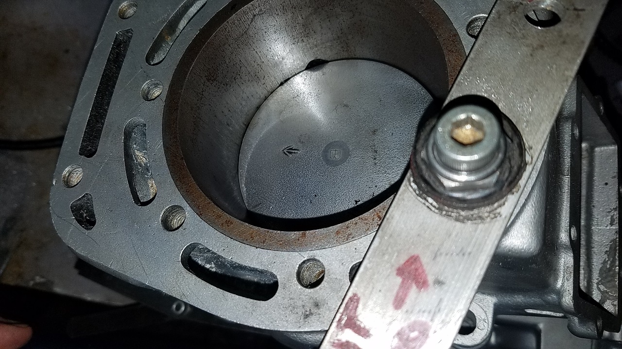

Rotate the crank backwards so that it goes all the way to the bottom of the stroke...
KX GURU RACING KX500 PORT TIMING NUMBERS 106.jpg (370.81 KiB) Viewed 16200 times
