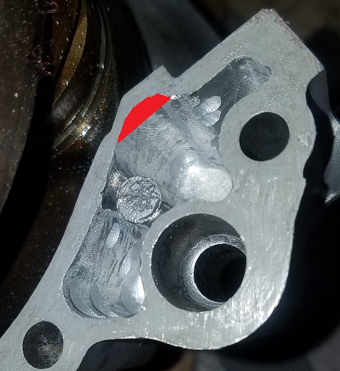

There are a few things I see that will need to be addressed.
1. The kips wall.
2. The studs
3. The transfer angles
4. The Balance factor of the crank asy.
The Kips wall is very thin as indicated by the arrow.
KX GURU RACING KX500 CYLINDER CUT AWAY 1.JPG (60.66 KiB) Viewed 11312 times
If you want to leave your exhaust port close to the same size as stock then you will need to pre weld the back side of the kips wall then machine it to the correct thickness, then bore.
Of course if you do that you will also need to shorten the length of the center Kips valve.
Which in this case is good because I want to make a few mods to it as well :lol:

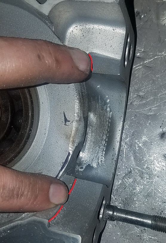

Something that I didn't think about came up... at 90mm the cylinders love to crack on a whim... Ask Motorrad...
So the best way to do it would be to sleeve it.
Another issue came up and that is 90mm is as big as you can go without modifying your engine cases :shock:
So, I'm experimenting...
Here is where the piston will hit the cases.
kx500 92mm piston.jpg (274.52 KiB) Viewed 10969 times
Another issue is this cavity...
Once you machine enough to clear the sleeve you will open your crank volume into this cavity..
KX Guru Racing 92mm kx500 piston mod 104.jpg (401.32 KiB) Viewed 10969 times
KX Guru Racing 92mm kx500 piston mod 106.jpg (215.39 KiB) Viewed 10969 times

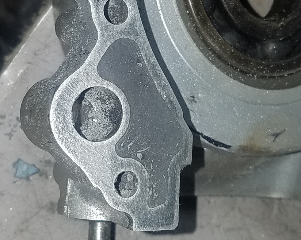

I went ahead and cleaned the area very well then added some divots for the filler to cling to..
KX Guru Racing 92mm kx500 piston mod 105.jpg (232.81 KiB) Viewed 10968 times
You can't mess up the proportions of the hardener... you open the cap and squeeze the plunger... it comes out evenly..
Just be sure to mix it thoroughly.... Then apply...

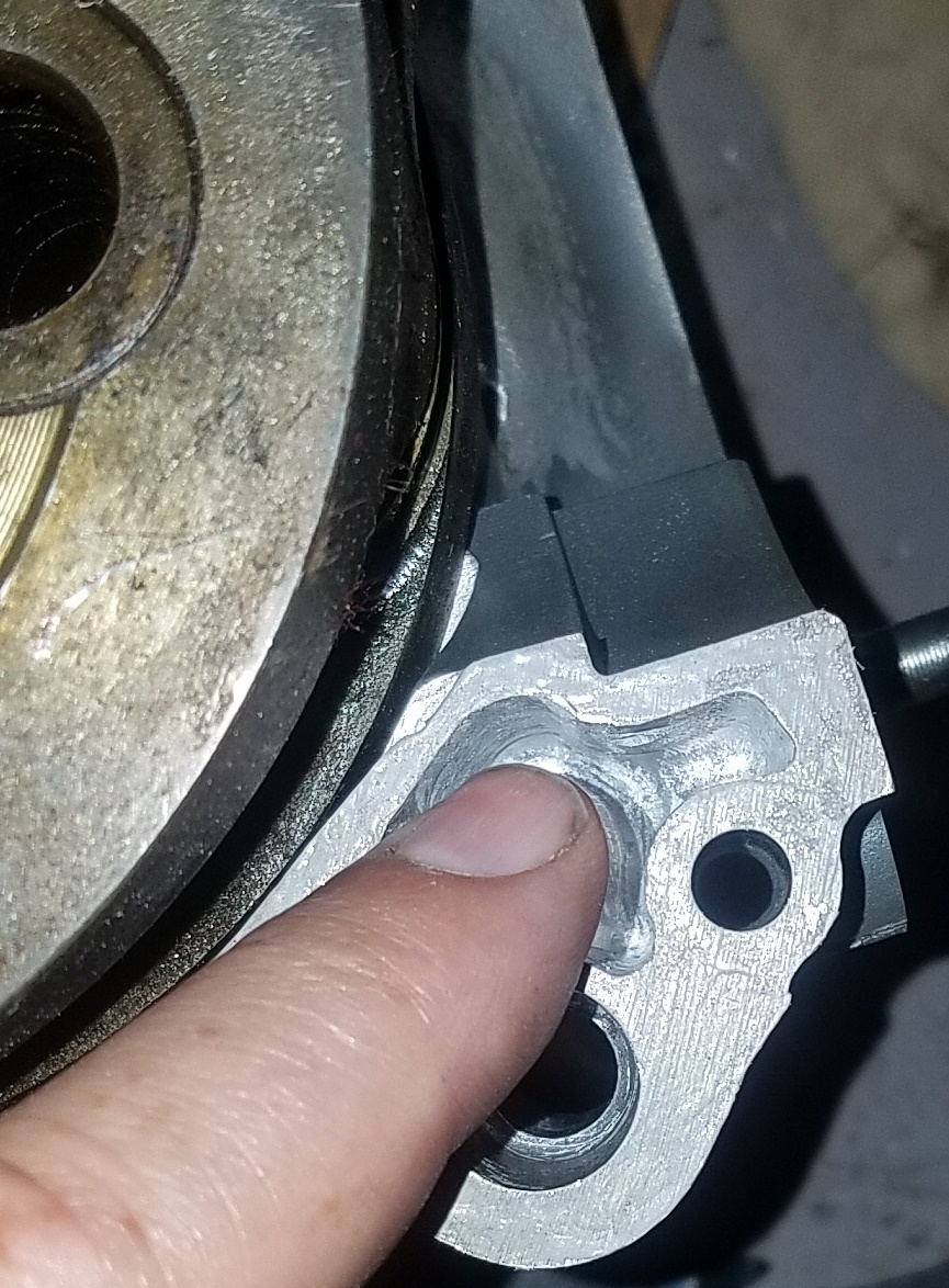

See that little space that did not get filled... uhoh....
Re: 92mm KX500 piston right here :-)
Because I didn't get the filler in the cavity evenly I had a hole that was bigger down below then it was on the surface.
So out came the porting tool and I made sure I could get to the bottom of the cavity...
KX Guru Racing 92mm kx500 piston mod 110.jpg (275.91 KiB) Viewed 10967 times
More mixing and applying...
This time I used a zip tie to make sure the filler went clear to the bottom...
KX Guru Racing 92mm kx500 piston mod 111.jpg (271.88 KiB) Viewed 10967 times
