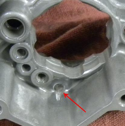

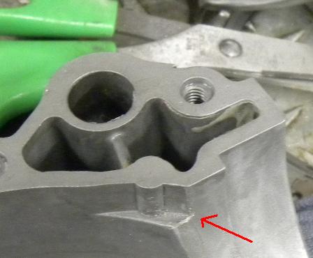

After spending a lot of time looking around my engine case I started noticing a few details...
case refinements 1.JPG (12.41 KiB) Viewed 15633 times
Does it hurt to leave it?
Apparently not as Kawasaki thought it was ok to leave.
But I don't like it.
So, I'm removing it.

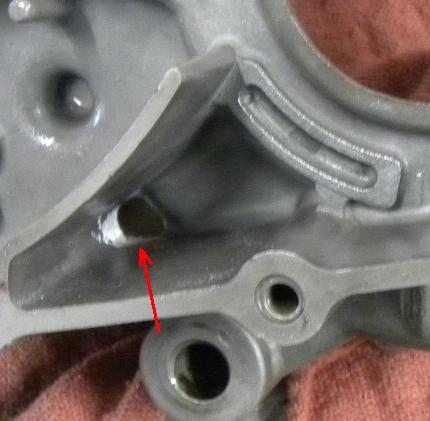

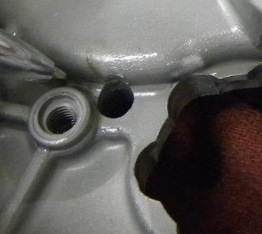

What about this oil hole.
Believe it or not I have a set of new factory cases and this hole does not even go all the way through.
It's as if only part of the hole got drilled :(

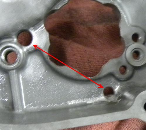

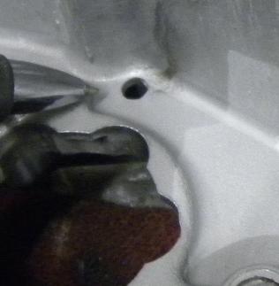

And this hole:
case refinements 3.JPG (11.09 KiB) Viewed 15633 times
Should these be clean up, enlarged, or polished?
YES!!!

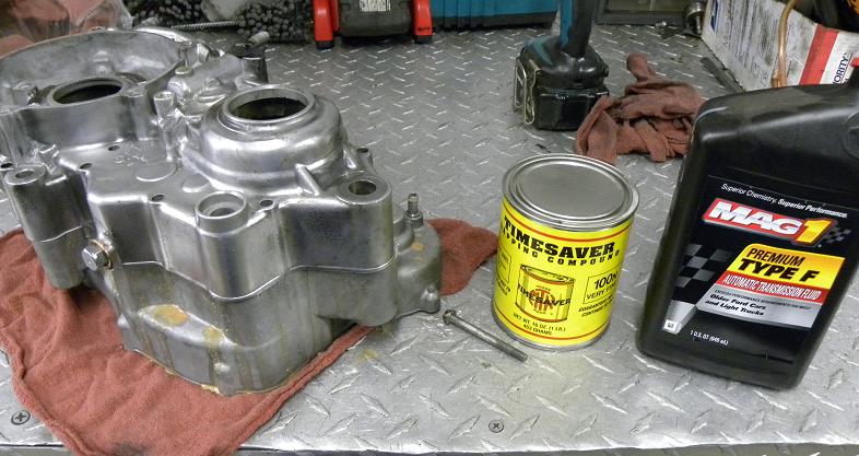

I use 100 grit "very fine" if the cases are not to bad.
For bad cases I use 60 "Medium"
ATF works great as a oil but I have used 30wt, and 10-40 :lol:
What you do is mix up a small bit of the yellow powder with the oil.
Mix it well.
I like to take a small block of wood and screw the bottom case to a wood table top or a small piece of plywood.
Then I liberally apply the Timesaver/oil mix to the mating surfaces of the cases.
I then put a bolt loosely into the end of one of the cases.
Then I move the top case back and forth several times.
Next, move the bolt to the other end of the cases and again move the top case back and forth several times.
I do this in the same pattern that I torque the case bolts.
Around and around we go.
Then check once in a while.. Add more Timesaver as required..

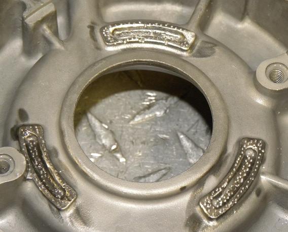

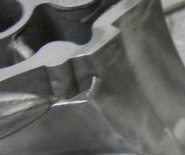

Seals aren't the only place for a potential air leak.
This is a troubled spot pointed out by Motorrad.
A small punch, cleaning, patience, cleaning, cleaning, cleaning, and some J-B Weld will fix this area up nicely.
Good vision would also help...
PUNCH CLEAN UP.JPG (40.94 KiB) Viewed 15505 times
Remember, if there is any oil or debris, J-B Weld will not stick and you've just wasted your time :o

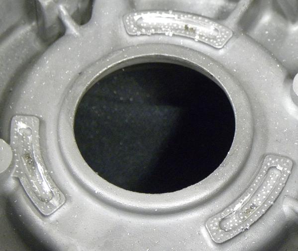

Here is the same view after clean up with a stainless steel wire wheel and carb cleaner.
