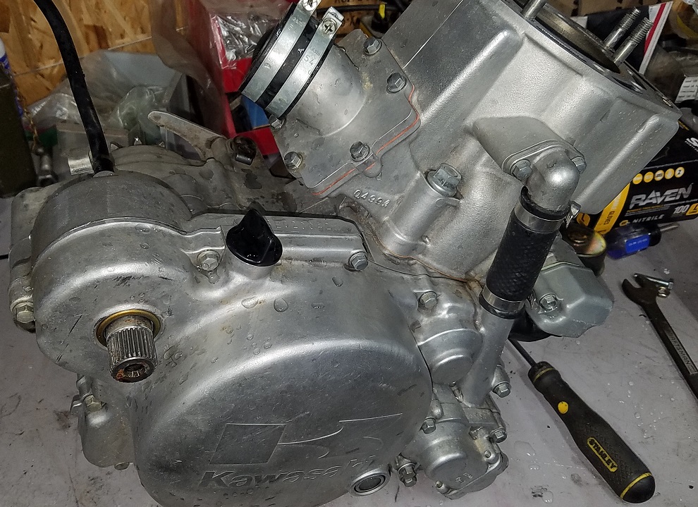

I received the engine today..
Sean Collier The Beast engine rebuild 101.jpg (416.17 KiB) Viewed 23378 times
It just needs a minor tune up :lol:

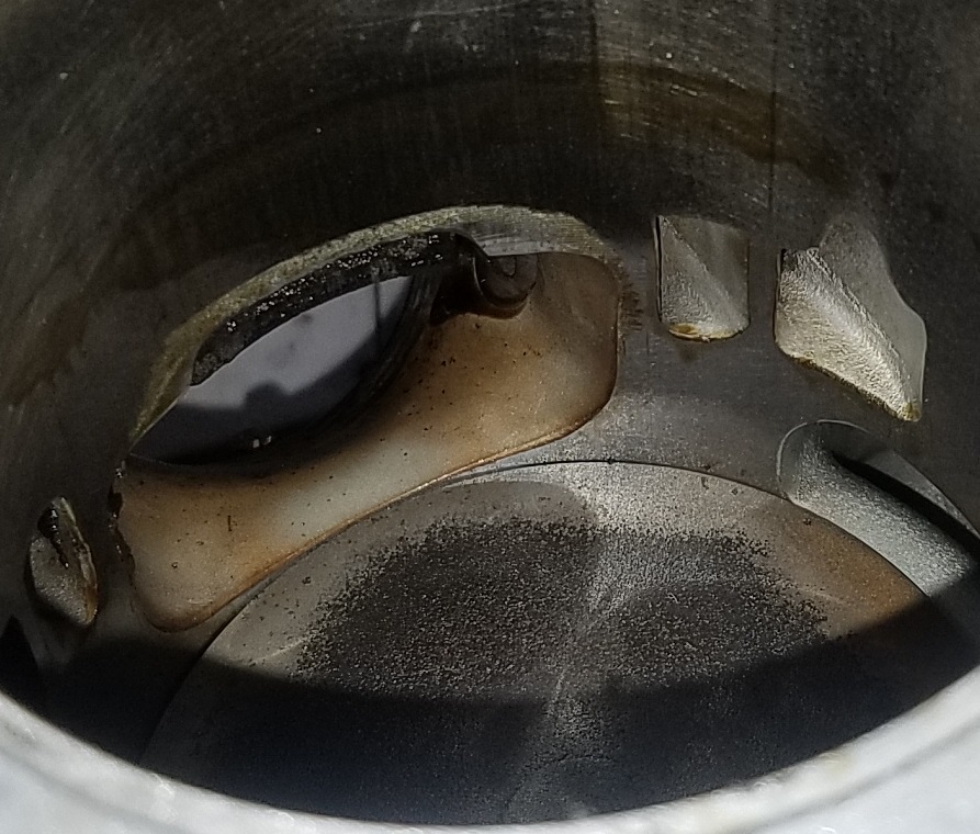

The bad thing is... the exhaust port is not looking any better...
Sean Collier The Beast engine rebuild 104.jpg (233.35 KiB) Viewed 23376 times

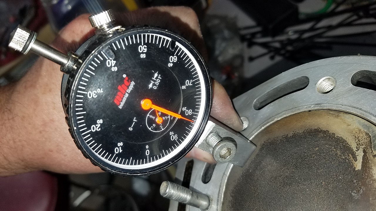

I already know the port timing so I don't have to worry about that.
But I still need to get the head squish calculated so I need to get some additional measurements..
Sean Collier The Beast engine rebuild 106.jpg (396.66 KiB) Viewed 23374 times

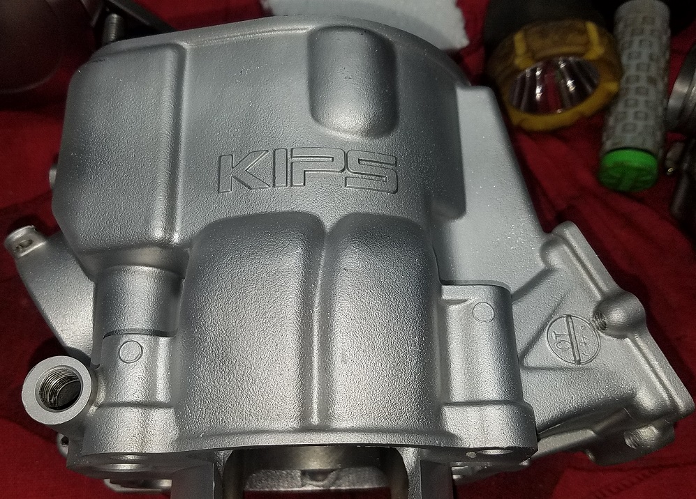

I started doing the rough porting on the cylinder today..
As you can see, this thing was ready to blow :shock:
KX GURU RACING MODIFIED KX450F REAR BRAKE CALIPER 114.jpg (212.3 KiB) Viewed 23298 times
KX GURU RACING MODIFIED KX450F REAR BRAKE CALIPER 115.jpg (230.58 KiB) Viewed 23298 times
KX GURU RACING MODIFIED KX450F REAR BRAKE CALIPER 116.jpg (349.52 KiB) Viewed 23298 times
KX GURU RACING MODIFIED KX450F REAR BRAKE CALIPER 117.jpg (147.37 KiB) Viewed 23298 times

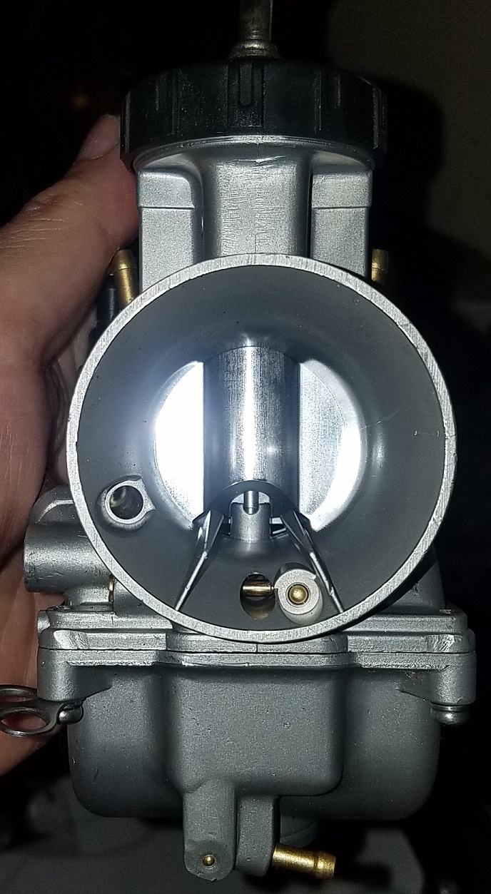

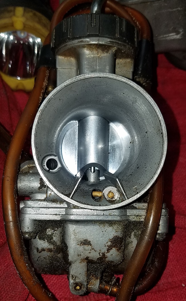

We are going to toss the stock carb and use a 97 KX250 carb 8-)
before
KX GURU RACING MODIFIED KX450F REAR BRAKE CALIPER 118.jpg (335.57 KiB) Viewed 23297 times
After
KX GURU RACING MODIFIED KX450F REAR BRAKE CALIPER 119.jpg (306.25 KiB) Viewed 23297 times

I spent a bit of time doing the rough porting the other day..
Today, Jason put his hand to the port tools and began to massage the cylinder..
No gloves, no eye protection... Nice Jason... Nice...
KX GURU RACING rebuilding the beast 120.jpg (412.5 KiB) Viewed 23282 times
Re: Sean Collier's "The Beast" Engine in for a refresh and mods.
Jason has a bit more roughing is done..
KX GURU RACING rebuilding the beast 121.jpg (254.96 KiB) Viewed 23267 times
