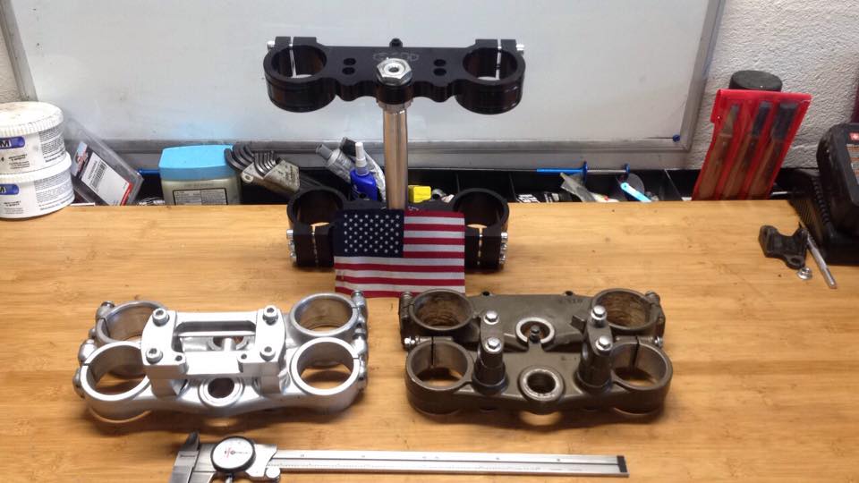

Triple Trees
I bet we all know by now, 97-04 KX500 triples are great.
But what else can you use?
BRP makes a nice after market set.
DH1 also makes some very nice clamps.
In fact, that is what Sean Collier is running on his bike.
Then of course we discussed using a 450F triple with a custom stem from Emig racing.
There is a ugly rumor that you can use some Yamaha triples.... I will be confirming that later ;-)
NOPE... YAMAHA TRIPLE CLAMPS WILL NOT FIT

Here is a note regarding the 97-04 KX500 Triple clamps.
This is wrote by Alex Ward KX Guru Racing Member..
The Newer KX 500 clamps do not fit well with the 450 forks. Close but too tight. you could bore the K5 clamps a bit to the specs I have listed or hit Alan Cameron up for a really sweet upgrade to your bike.
Triple clamp mounting hole dimensions
Stock kx 500- 2.128/2.318
Kx 450F- 2.122/2.330
DH1 conversion 2.125/2.331
