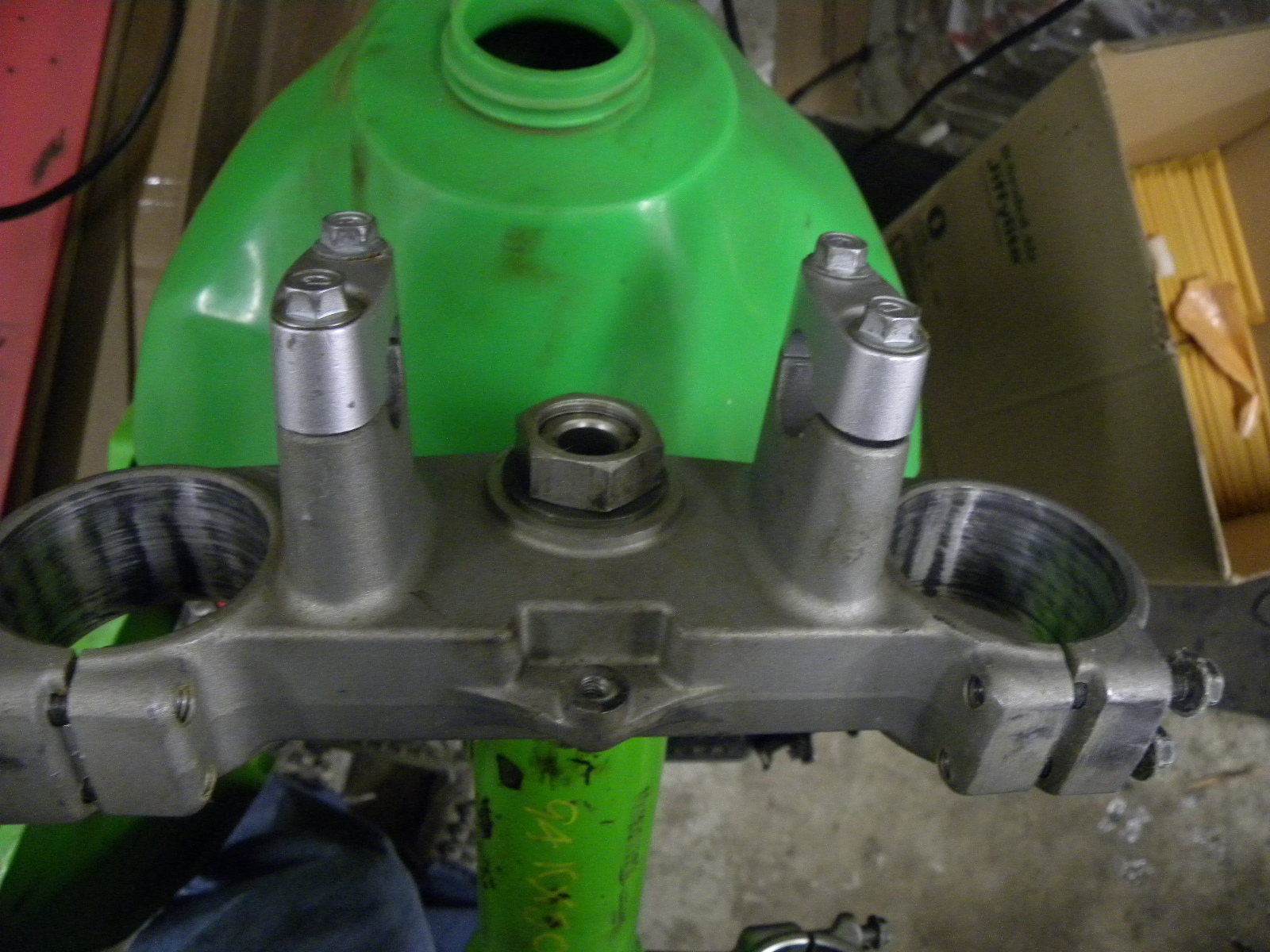

First things first, I grabbed a set of 05 YZ250F triple clamps and measured the distance between the fork tubes and they measure 190mm.
The KX500 fork tubes also measure 190mm so were good there.
Next I placed the 250F triple clamps into the head tube of a 94 KX500 frame.
Just about any year from 86 to o4 will have the same measurements.
Here is what I see.
The bottom bearing isn't big enough.
The upper bearing is too big
We seem to have plenty of top nut adjustment if we can find a smaller upper bearing.
