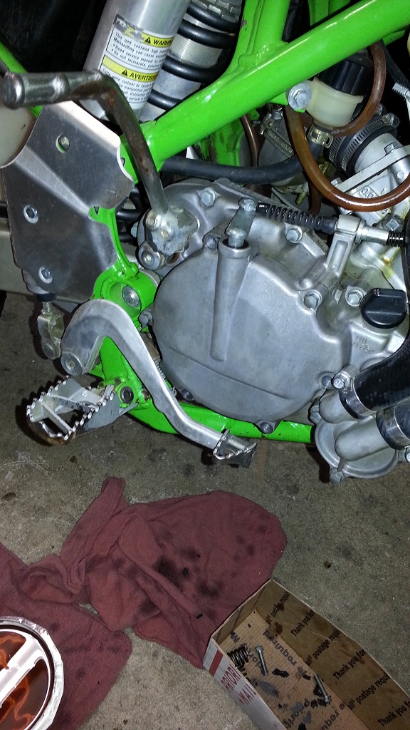

I didn't ride a whole lot before my clutch stopped working.
Took it apart and the clutch disks smell burnt.
kx100 clutch replacement 1.jpg (208.04 KiB) Viewed 4936 times

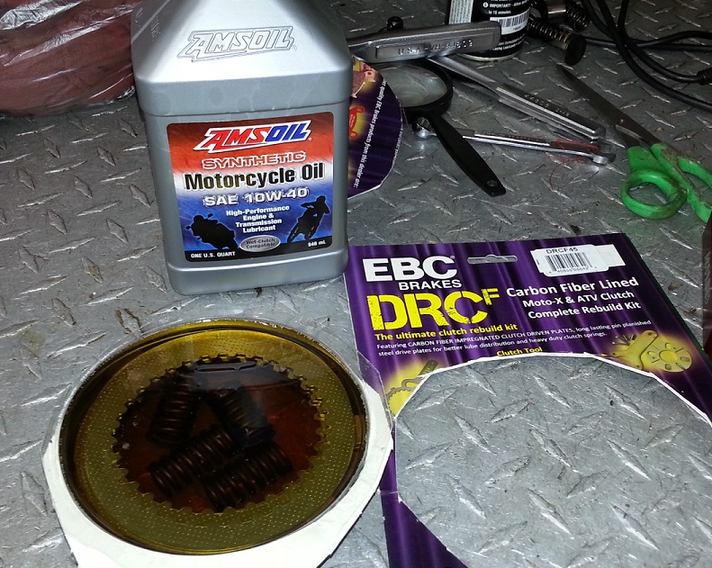

My Dad found some clutch plates and I soaked them in oil.
Dad laughed and said that I didn't need to soak the metal plates.
kx100 clutch replacement 2.jpg (249.23 KiB) Viewed 4936 times

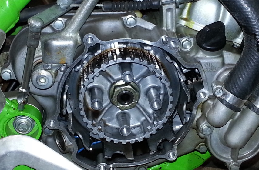

Installed the plates, put the cover on, put in the oil, go ride it.. :mrgreen:
kx100 clutch replacement 3.jpg (262.07 KiB) Viewed 4936 times
