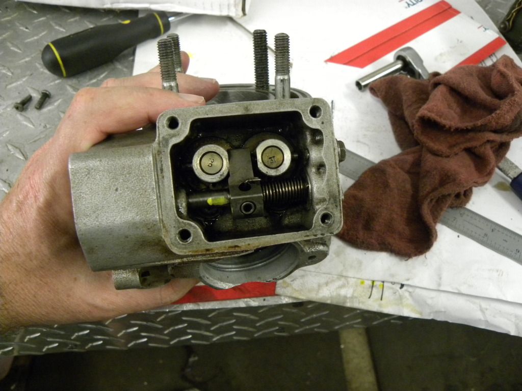

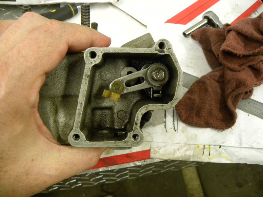

After removing your cylinder and head, this is what your valve set up looks like:

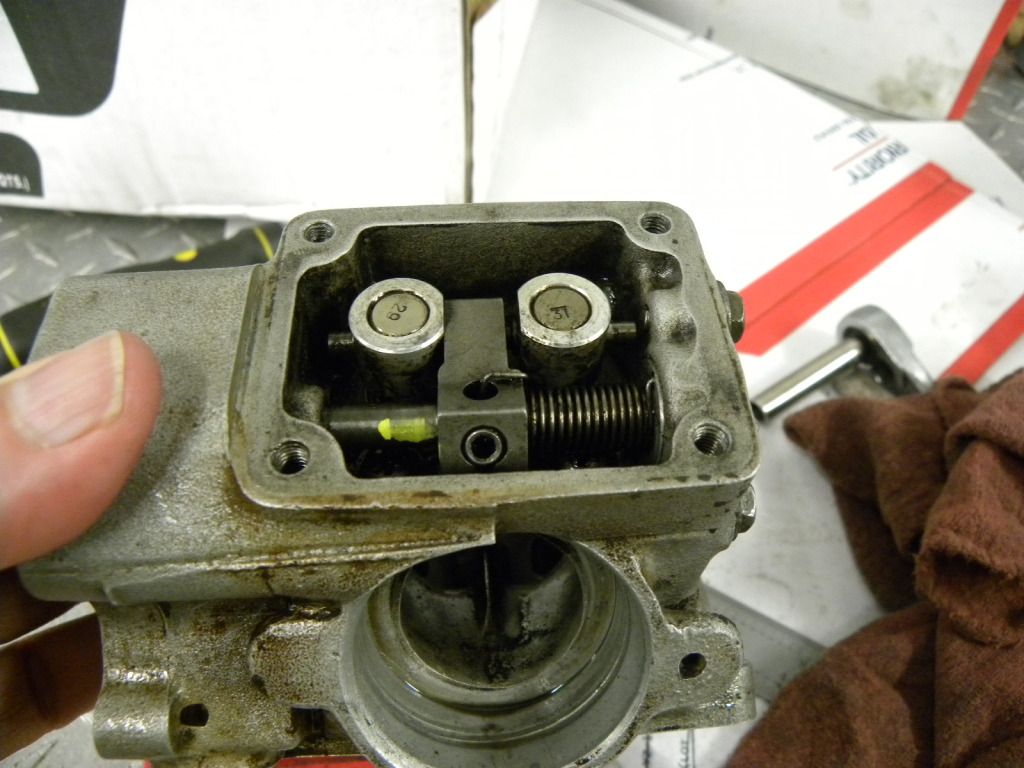

Here's some more pics with the valves push up:

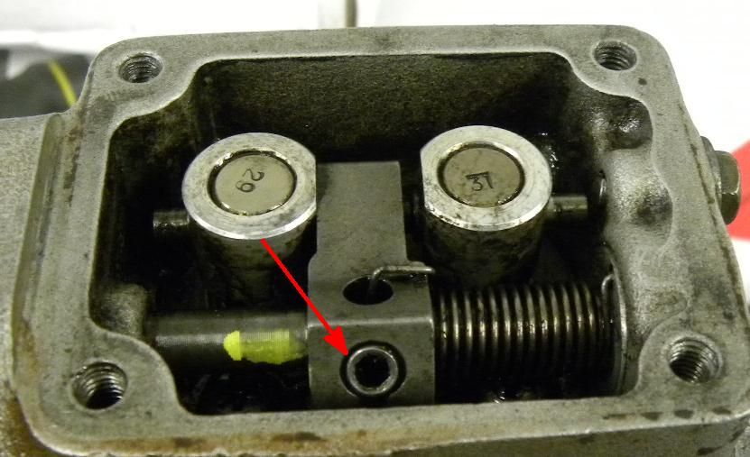

We started by removing the set screw in the middle:

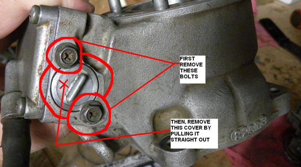

Next we removed the two left side retainer bolts and the pulled the cover straight out:

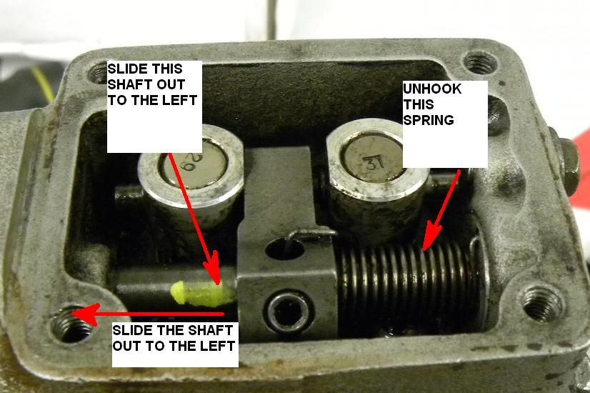

Now, unhook the spring first and then slide the shaft out to the left:
With the shaft removed you can now remove the two retaining bolts.

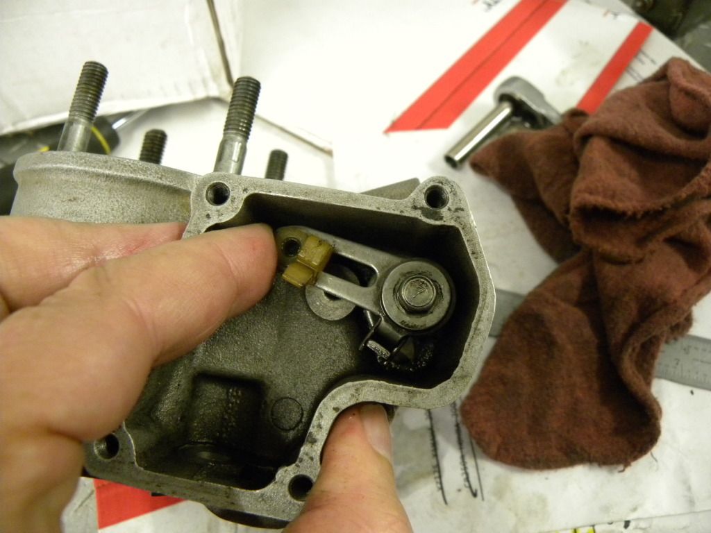

They generally come out fairly hard so you will probably need to use a impact screw driver.
Once this is done you can pull the center bar up and slide the valves out toward the front of the cylinder.
Depending on how dirty they are they might require some effort to get them out.
I had to push from the inside and pull from the outside.
A good soaking in some carb cleaner, penetrating oil, ect is a good idea.

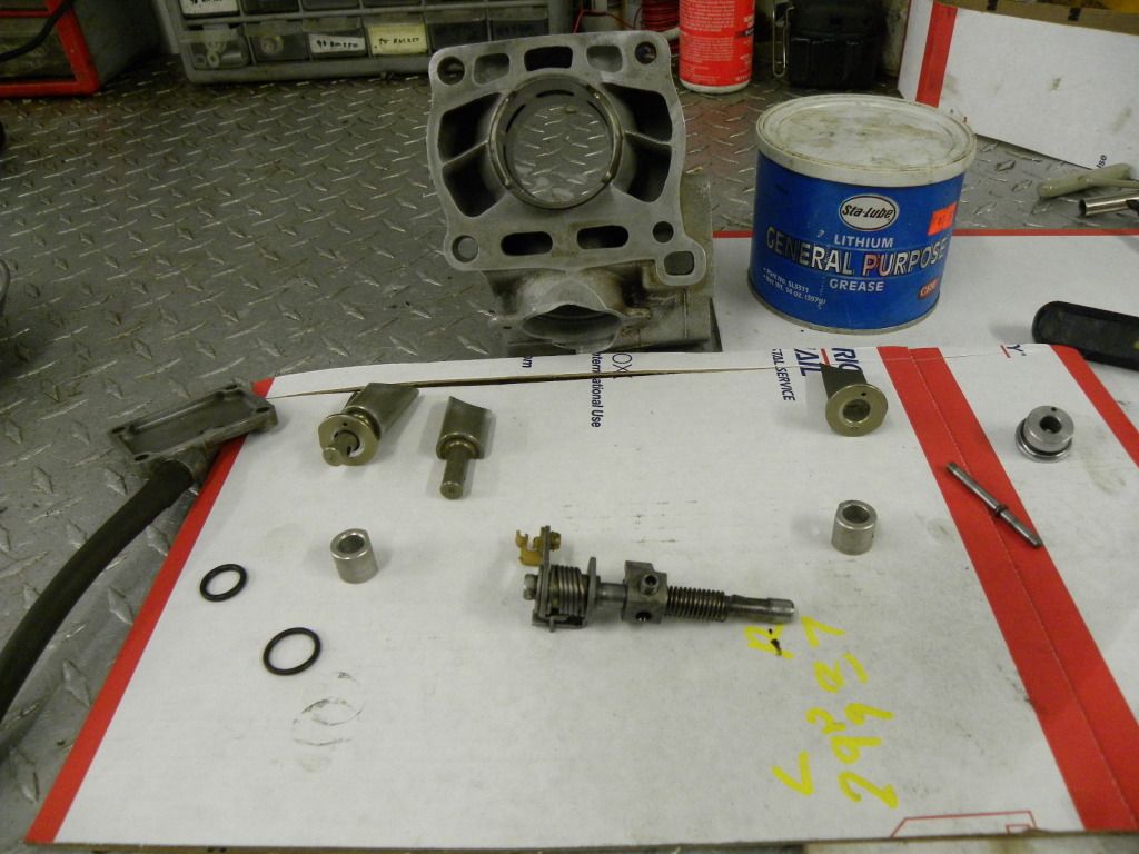

Here is a view of the shaft out of the cylinder and assembled as it sits in the cylinder:
Now, CLEAN CLEAN CLEAN!
Remember, the cleaner the valves go back in, the more power you make
Once it is clean, reassemble in the reverse order and you are ready to go.
