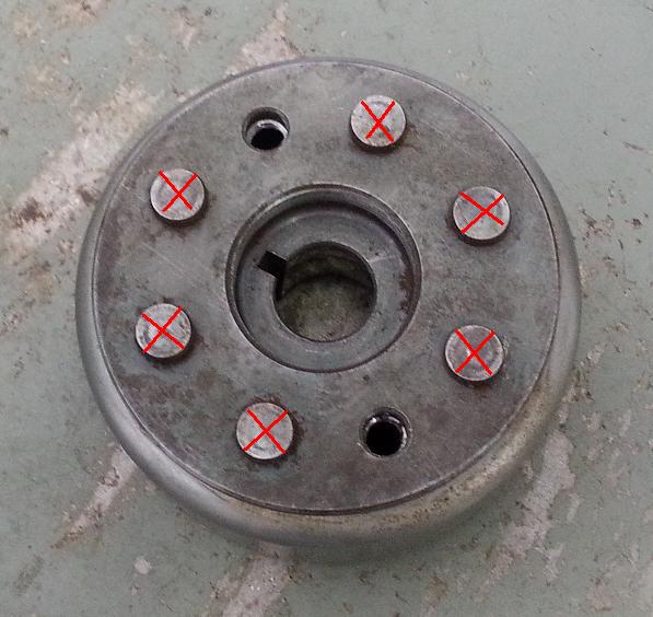

In this example I needed a adapter for a 18" automotive degree wheel to fit the the shaft on my KX500.
Since I didn't have a lathe, I decided to use a old fly wheel.
I didn't want to ruin a KX500 fly wheel so I used one from a 99 KX125.
As it turns out they are exactly the same shaft size.

Then I ground off the rivets...
