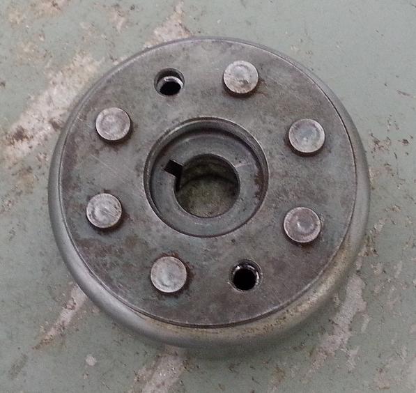

In this example I needed a adapter for a 18" automotive degree wheel to fit the the shaft on my KX500.
Since I didn't have a lathe, I decided to use a old fly wheel.
I didn't want to ruin a KX500 fly wheel so I used one from a 99 KX125.
As it turns out they are exactly the same shaft size.
degree wheel adapter for a KX500 1.JPG (50.3 KiB) Viewed 3270 times

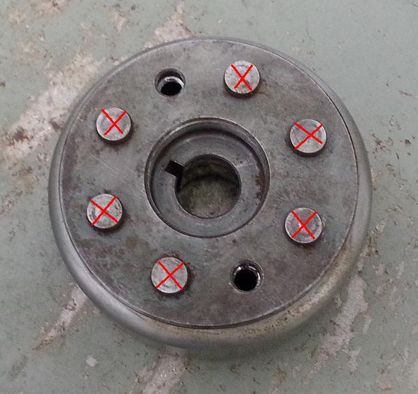

Then I ground off the rivets...
degree wheel adapter for a KX500 2.JPG (52.02 KiB) Viewed 3270 times

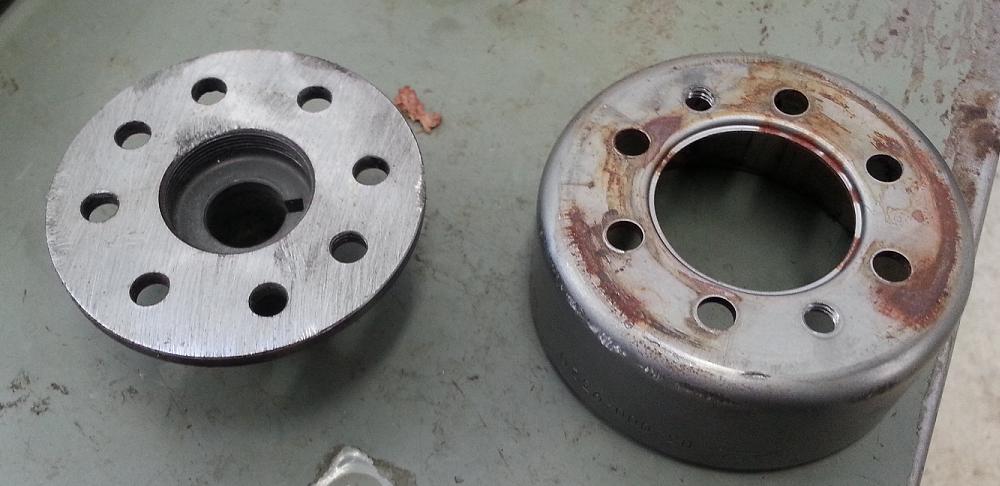

degree wheel adapter for a KX500 3.JPG (62.81 KiB) Viewed 3270 times

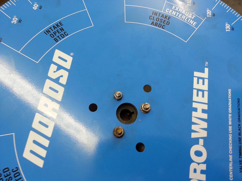

Did a test fit on the shaft to make sure nothing had changed...
degree wheel adapter for a KX500 4.JPG (69.54 KiB) Viewed 3270 times

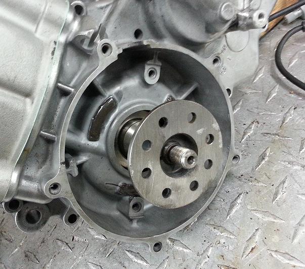

Carefully drilled the holes to maintain alignment..
degree wheel adapter for a KX500 5.JPG (27.22 KiB) Viewed 3270 times

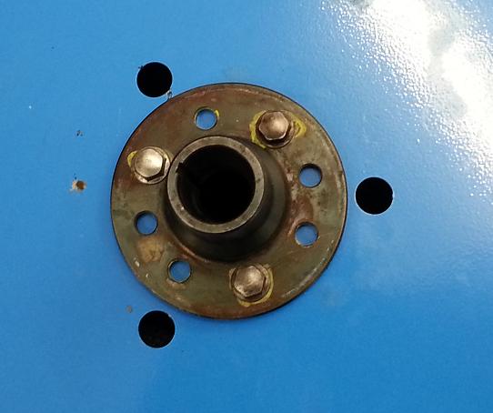

degree wheel adapter for a KX500 6.JPG (62.49 KiB) Viewed 3270 times
It bolted up and worked perfect....
Now I need to make the pointer for the degree wheel... :?
