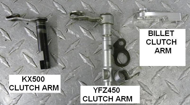

Here is what we are attempting to do.
We are using a stock KX500 Clutch arm, a YFZ450F billet Clutch arm from MOdQuad, and a stock YFZ450F clutch arm.
If everything works as planned this should give as a clutch arm that is 20% longer than stock.
The plan is to use the bottom half of the KX500 clutch arm with the top half of the YFZ450F clutch arm and of course the Billet arm

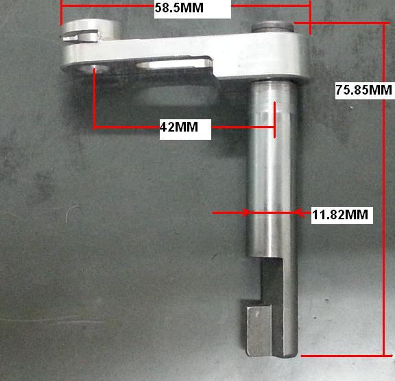

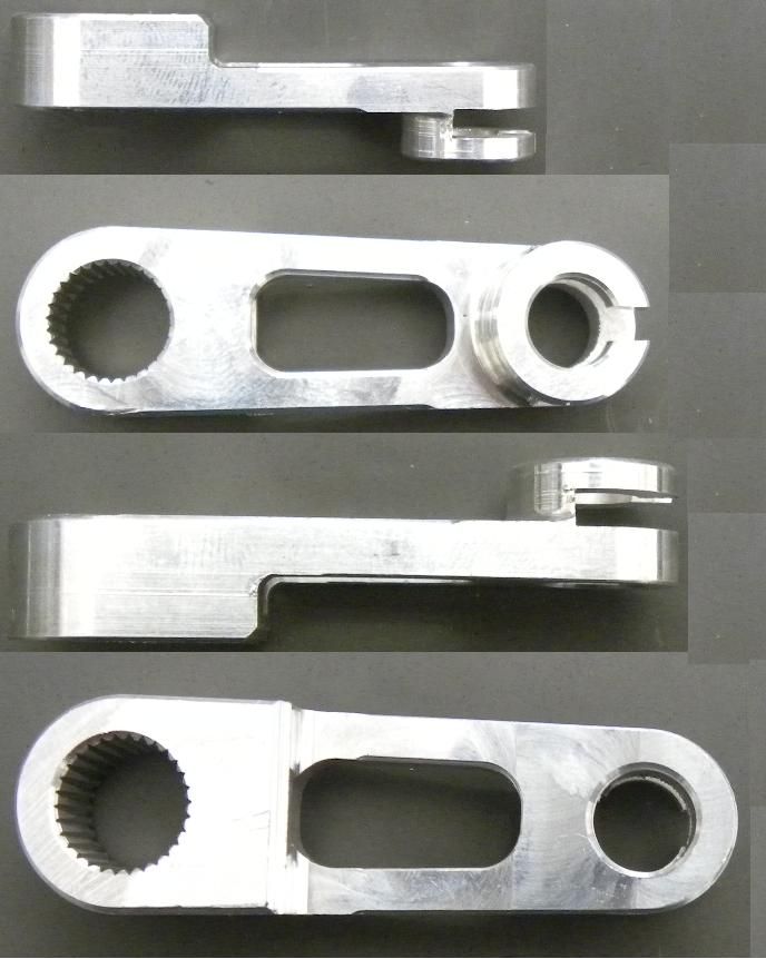

Here is some views of the Billet arm:

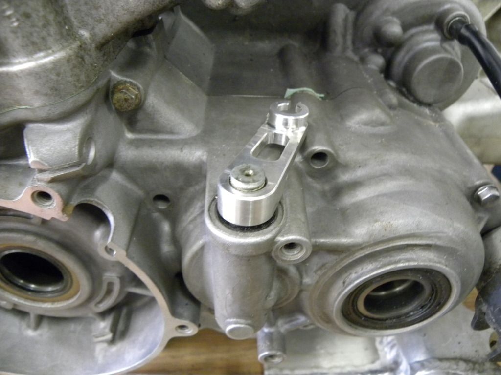

My first step was to make sure everything will fit:
Everything appears to be perfect.
So, my next step was to cut the YFZ450F clutch arm to simulate how the whole assembly will fit, installed the Billet arm and slip it into the KX500 Case.
So far, so good.

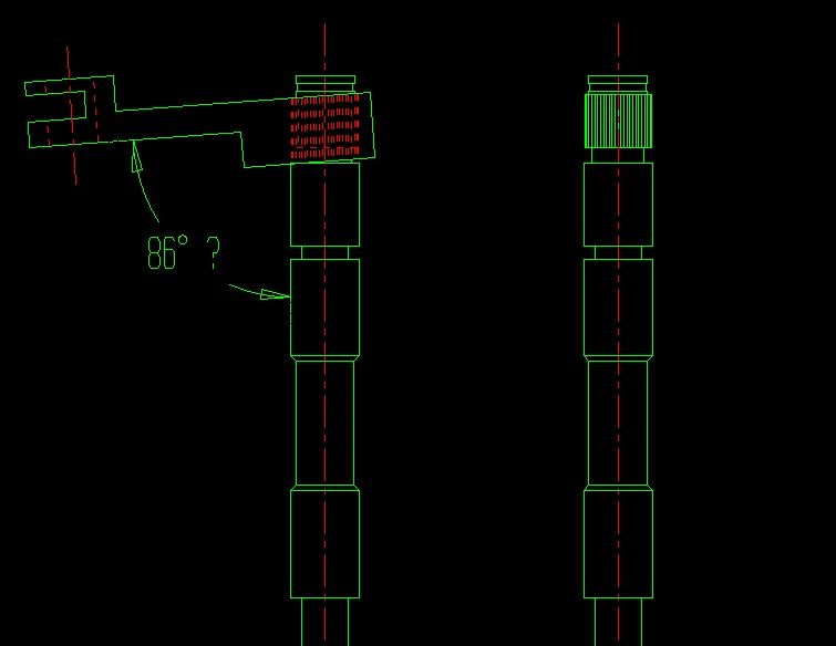

I was surprised to see that the splines are not perpendicular to the arm but rather they are approximately 4 degrees out of square.

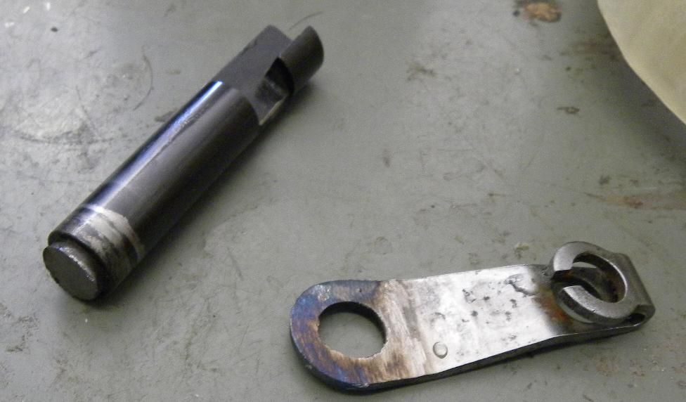

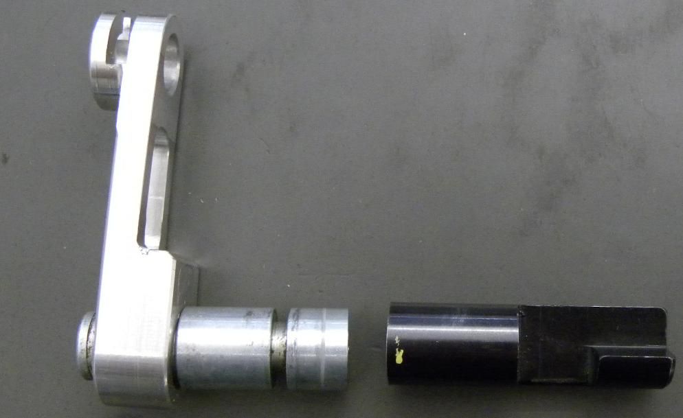

Next, I ground the weld off the KX500 Clutch arm and removed the arm from the shaft.
After carefully measuring the parts, I took it to a friend of mine who is a machinist and had him part both the shafts.
Once I verify the measurements I'll have it welded.
More later

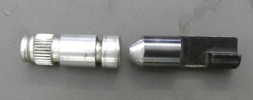

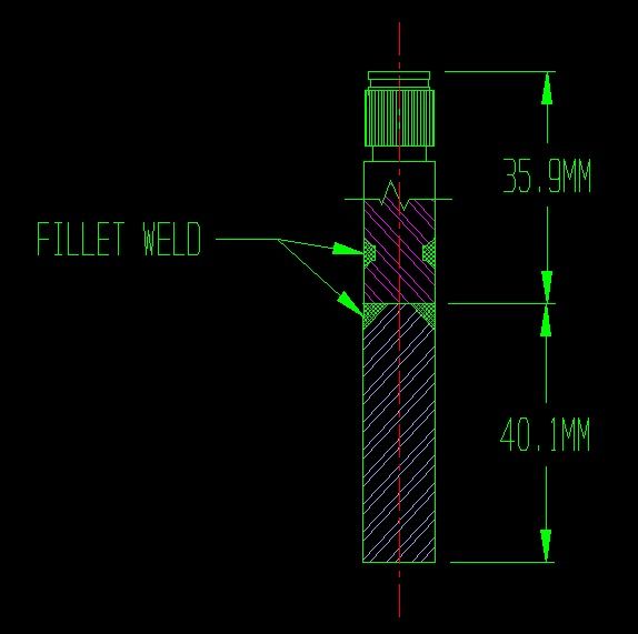

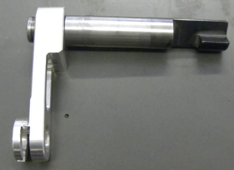

After I verified the correct placement in the bike I chamfered one of the shafts to provide a good welding surface:
Not shown on the picture is I chamfered the slot to allow for weld.
Here is the measurements I settled on:

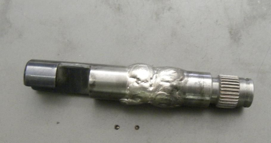

The shafts have been welded and the slot has been filled with SS.
The shafts were clamped down in a V-block to maintain alignment while welding:
We'll spin it up tomorrow on the lathe and see where it cleans up at.
Re: How to make a KX500 billet extended clutch arm.
All done :D

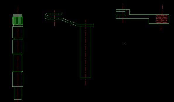

Here is some basic measurements
KX500 EXTENDED CLUTCH ARM.JPG (42.6 KiB) Viewed 17662 times
