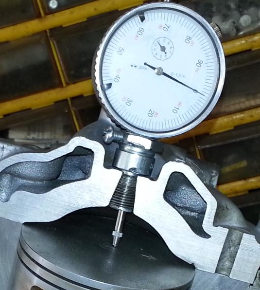

So now that we have the preliminaries out of the way, we need to be able to move the piston to top dead center and then roll the motor back .087" and install the flywheel.
So how can you get the timing exact?
Just need the right tool.
I used a dial indicator and a old hollowed out spark plug.
The first pic here is of my cut away motor.
I am seeing if I have enough travel in my dial indicator to zero the indicator out when the piston is at top dead center, and then still have enough travel to back the motor off to .087".
This is the set up:
[attachment=1]kx500 mzb ignition 1.JPG[/attachment]

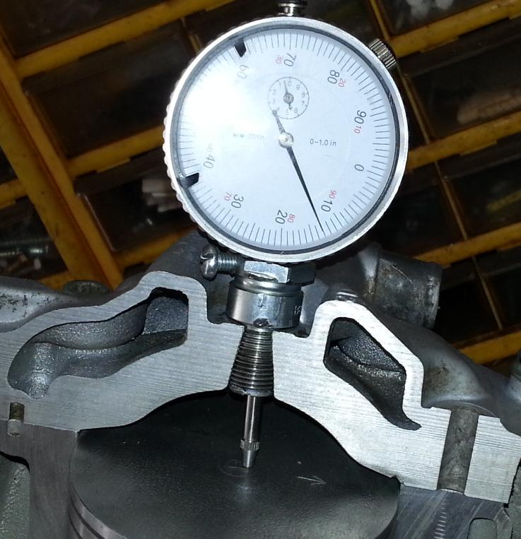

In the next pic I rotated the crank so that the top of the piston is at top dead center and zeroed out my indicator.
Then I rotated the crank so that the indicator is not touching the piston at all and got a reading of .132"
Looks good even when we factor in the gasket thickness that is not on the mock up engine.
However, it is really close so I may have to modify my spark plug adapter some to gain some travel in the indicator.

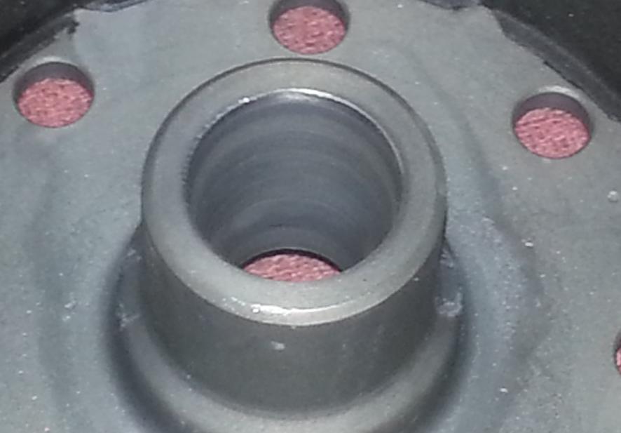

Use fine lapping compound and lap away...
KX500 2001 MZB INSTALLATION 1.JPG (76 KiB) Viewed 15864 times
I didn't get any pics before I started but the tapered flywheel ID was bright and shiny.
After applying some fine lapping compound and spinning the flywheel back and forth, round and round, it should be dull..
KX500 2001 MZB INSTALLATION 1-1.JPG (40.19 KiB) Viewed 15864 times

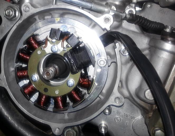

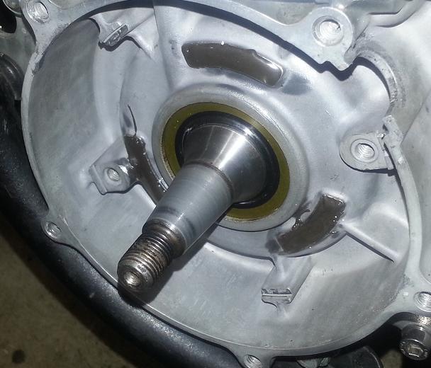

Here's how the crank looks..
KX500 2001 MZB INSTALLATION 1-2.JPG (46.82 KiB) Viewed 15863 times

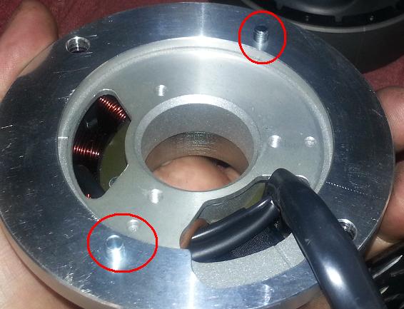

The next thing I did was test fit the stator.
When I tried to seat it, it rocked back and forth.
No matter how much I moved it, it just wouldn't seat..
Here is the culprits...
KX500 2001 MZB INSTALLATION 1-3.JPG (38.34 KiB) Viewed 15863 times

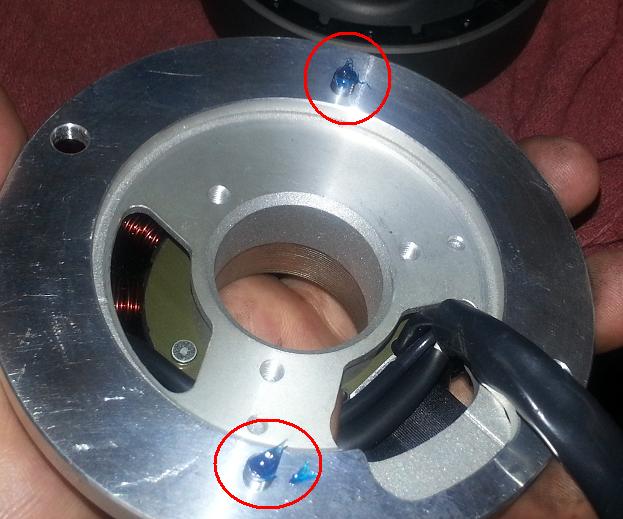

Just to make sure, I put some grease on the end of the bolts and did a test fit.
KX500 2001 MZB INSTALLATION 1-4.JPG (47.58 KiB) Viewed 15863 times
Sure enough that was the problem.
After I ground the bolts shorter the stator went right in with no problems.

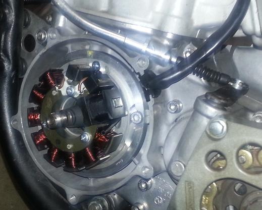

KX500 2001 MZB INSTALLATION 1-5.JPG (64.56 KiB) Viewed 15863 times
I used a dab of Blue Loctite on the bolts.
Probably don't need it but I wanted to be sure I don't loose a bolt and destroy my system :shock:

Remember the dial indicator and the spark plug adapter I showed earlier?
Go ahead and screw in your spark plug adapter into the head, then set your dial indicator with the set screw so that the indicator does not move around.
Next, roll your engine until the piston is at Top Dead Center...

Once you find Top Dead Center, Zero your indicator out.
Next you want to roll your engine over backwards until you hit .087"
If you are facing the stator side of the engine, that will be clockwise.
If you are facing the clutch side of the engine, that will be counter clockwise.

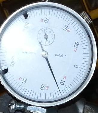

Note that my indicator reads backwards so if you were reading it normally it would appear to be .013".
KX500 2001 MZB INSTALLATION 2-7.JPG (78.96 KiB) Viewed 15863 times
But look a bit closer.... Notice the small red numbers?
KX500 2001 MZB INSTALLATION 2-8.JPG (21.25 KiB) Viewed 15863 times
Reading the small red numbers it's .087".... PERFECT!!! **** CORRECTED INFO NOW IT'S .086" ****

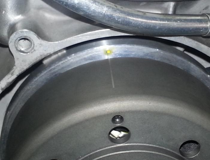

Now you need to install the flywheel.
Remember, there is no keyway in the flywheel.
Why?
Because this flywheel can be used in many different bikes :-)
On this model my stator has a small Yellow dot.
The flywheel has a line on the outside edge.
You need to line the line and the dot up and set it into place while maintaining the .087" reading :shock:
