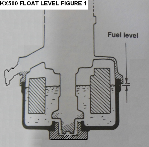

Kawasaki gives a specification of the actual fuel level, measured from the top edge of the float bowl with the carburetor held level as shown below in figure 1.

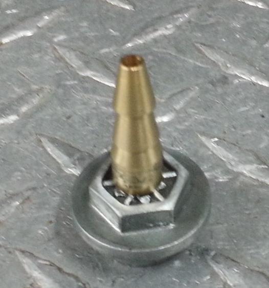

What we have here is a KX500 float bowl drain plug with a hole drilled in the bottom of it..
KX500 FLOAT BOWL LEVEL TOOL 1.JPG (35.85 KiB) Viewed 18764 times
This little fitting was from a air nozzle that I bought at Harbor freight for 1.99 which included several other attachments I needed for other projects so it was a real deal :lol: Of course you can use many other things for this but it is something I already had.
KX500 FLOAT BOWL LEVEL TOOL 2.JPG (36.61 KiB) Viewed 18764 times

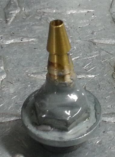

Now your going to need to solder and JB-Weld the nozzle to the drain plug.
If your going to solder them together you better remove the o-ring from the bottom of the drain plug or you will be looking for another to buy :(
KX500 FLOAT BOWL LEVEL TOOL 3.JPG (43.39 KiB) Viewed 18764 times
I tried to solder mine but I don't have the right tools for the job so I JB-Welded mine together and it works great!
If you decide to solder yours, be careful.
A torch is real easy to get carried away with and the aluminum plug will melt extremely fast.
A normal soldering iron does not generate enough even heat to get a good bond.

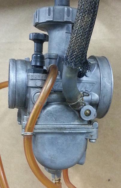

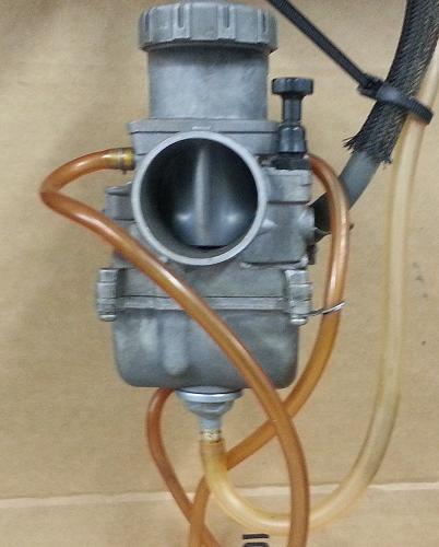

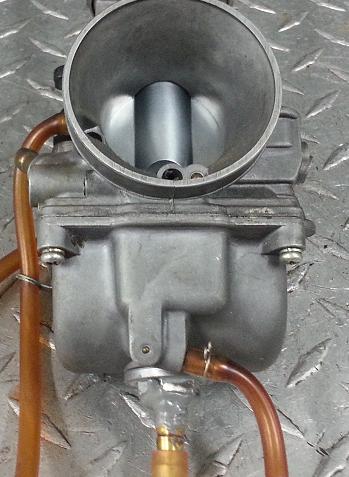

2. Remove the drain plug from the bottom of the float bowl and install our custom made fuel level tool as shown below.
KX500 FLOAT BOWL LEVEL TOOL 5.JPG (32.07 KiB) Viewed 18761 times
As you can see, this carburetor isn't hooked up to a bike because I just happen to have this one laying around and didn't have to disconnect mine :D
It is harder if it is completely removed from the bike.
3. Situate the carburetor so that it is as level as possible.

4. Once the carburetor is as level as you can get it, hold the clear fuel line that is connected to the bottom of your Float Bowl Adjustment tool up as shown below:
KX500 FLOAT BOWL LEVEL TOOL 7.JPG (27.29 KiB) Viewed 18761 times

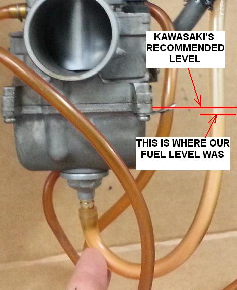

5. Open your Fuel Valve (Petcock valve) and note the level of the fuel in the clear fuel line that is connected to the bottom of your Float Bowl Adjustment tool.
KX500 FLOAT BOWL LEVEL TOOL 8.JPG (41.03 KiB) Viewed 18761 times
As you can see, our level is set too low :cry:

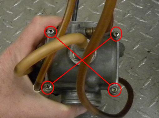

First, remove the screws at the bottom of the bowl.
KX500 FLOAT BOWL LEVEL TOOL 9.JPG (27.06 KiB) Viewed 18684 times

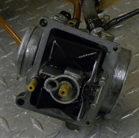

Next, carefully remove the bowl.
Remember, there are some delicate part in here so be careful not to force anything.
With the bowl off, it should look something like this.
KX500 FLOAT BOWL LEVEL TOOL 9-1.JPG (38.65 KiB) Viewed 18684 times
While you have it apart, it would be a good idea to pull the pilot jet and the main jet out and inspect them for any obstructions.
It would also be a good time to really clean your carb out to be sure no dirt got inside while you disassembled it.

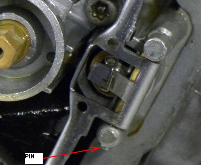

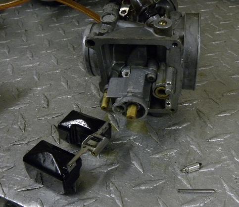

Next you need to remove the pin that holds the floats in the carb.
It is located as shown below.
KX500 FLOAT BOWL LEVEL TOOL 9-2.JPG (40.08 KiB) Viewed 18684 times
The pin will slide out from either direction.
Also, be careful at this point, take a picture or make notes of what you are looking at so you don't try to install anything backwards :o
Once you have the pin out, it looks like this.
KX500 FLOAT BOWL LEVEL TOOL 9-3.JPG (36.29 KiB) Viewed 18684 times

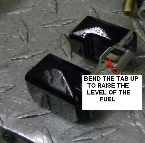

See the little tab in the middle of the circle?
KX500 FLOAT BOWL LEVEL TOOL 9-5.JPG (31.16 KiB) Viewed 18684 times
You change the float height by bending that little tab.
"CAUTION" it takes very minor bends of that tab to make a large difference in float height so be careful and go slow...

To raise the fuel level higher, bend the tab up.
Again, remember that I have the floats upside down.
KX500 FLOAT BOWL LEVEL TOOL 9-7.JPG (34.94 KiB) Viewed 18684 times

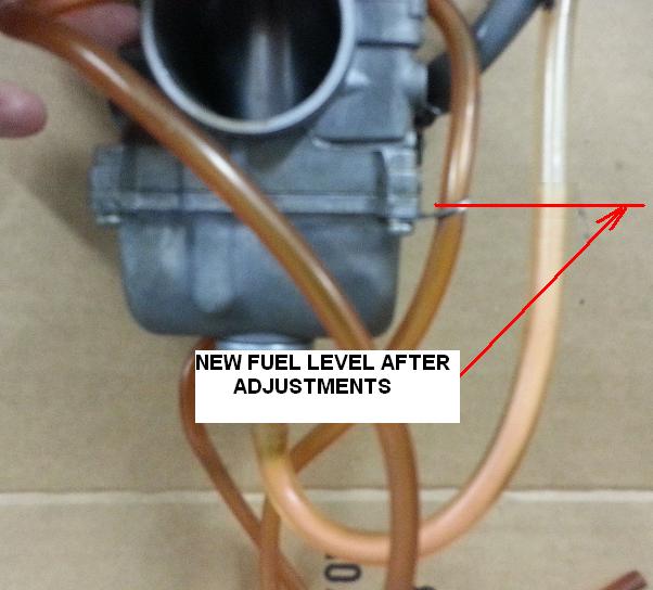

To test your new setting you need to reassemble the carburetor and set it up level again and use the fuel intake hose to fill the carb up again.
You may need to move the tab several times until you get it just right but be patient and do it until you get it right.
Re: How to adjust your float bowl height on your KX500 Dirt
Much much better.
It took me two tries to get it where I wanted it so don't be in a hurry.
A few minutes now will save you heartache later.
KX500 FLOAT BOWL LEVEL TOOL 9-8.JPG (37.58 KiB) Viewed 18679 times
