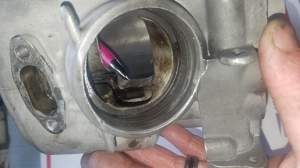

Starting with the cylinder.. It has been ported by Eric Gore.
This cylinder porting would be great for a trail bike but not so good for a Snow bike..

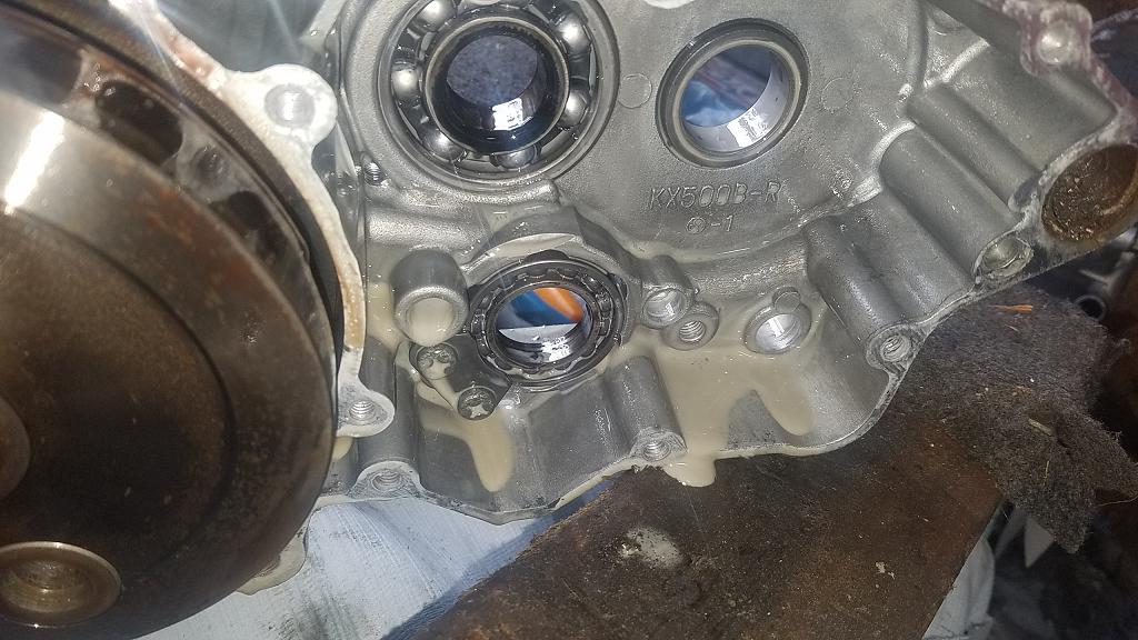

At first glance the transmission didn't look to bad... excluding the milky oil of course..
KX GURU RACING 1992 KX500 SNOW BIKE ENGINE BUILD FOR BRENT 105.JPG (114.98 KiB) Viewed 41811 times

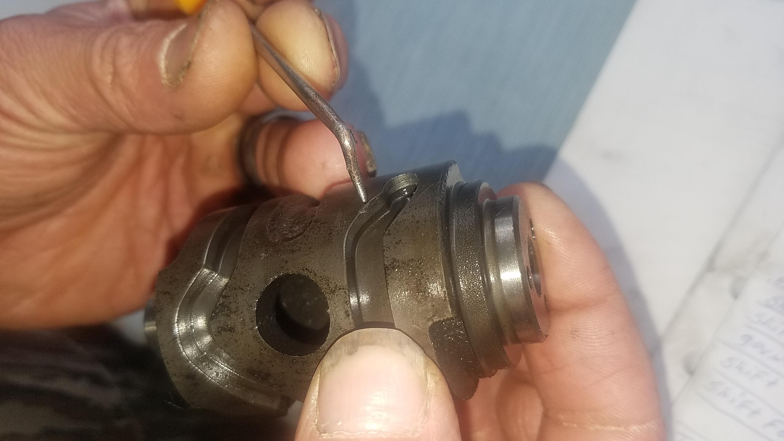

KX GURU RACING 1992 KX500 SNOW BIKE ENGINE BUILD FOR BRENT 106.JPG (122.65 KiB) Viewed 41811 times

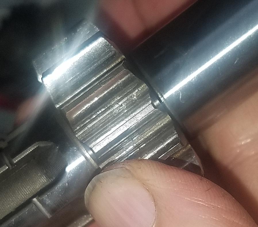

This gear looks pretty good..
KX GURU RACING 1992 KX500 SNOW BIKE ENGINE BUILD FOR BRENT 108.JPG (63.06 KiB) Viewed 41810 times

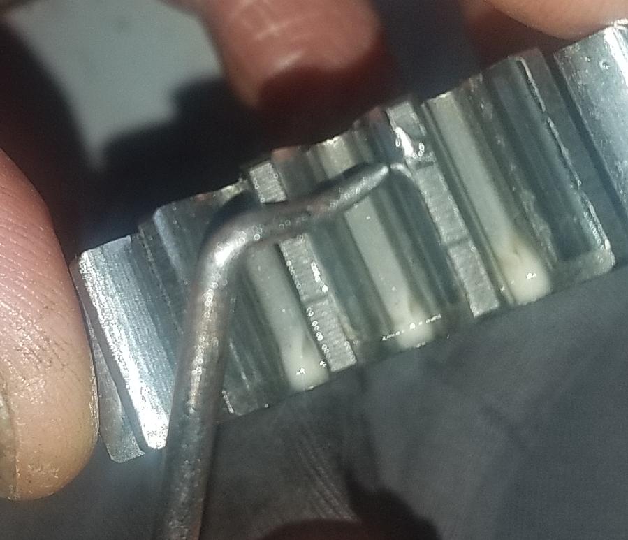

This one is chipped which is why there was some metal shavings in the bottom of the cases..
KX GURU RACING 1992 KX500 SNOW BIKE ENGINE BUILD FOR BRENT 110.JPG (74.97 KiB) Viewed 41809 times

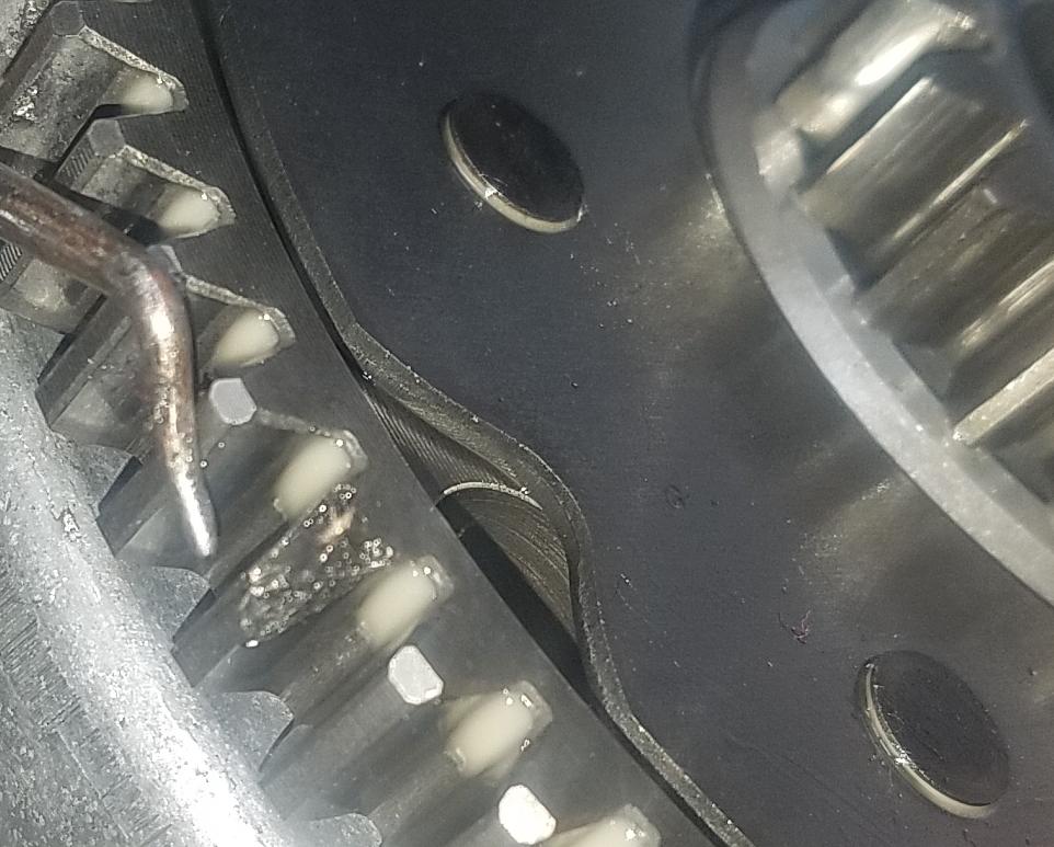

The small clutch basket gear has a chip out of it..
KX GURU RACING 1992 KX500 SNOW BIKE ENGINE BUILD FOR BRENT 113.JPG (69.66 KiB) Viewed 41807 times

Crack in the exhaust port..
KX GURU RACING 1992 KX500 SNOW BIKE ENGINE BUILD FOR BRENT 120.JPG (106.27 KiB) Viewed 41790 times
