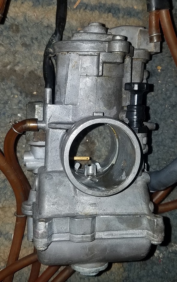

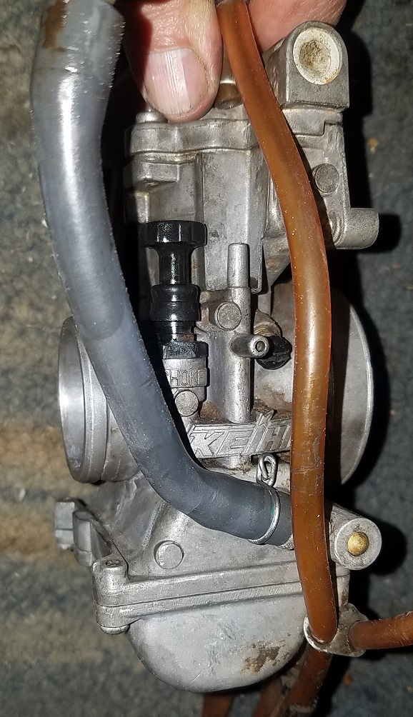

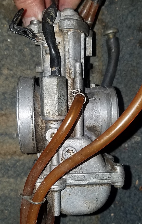

I just need one of these..

Have you tried test fitting this carb? If you have not, you'll eventually find an interference issue with the tank and the carb cap.
Shouldn't be a huge deal to modify the cap since the tps is removed from the carb. I'm hoping that's all that's needed.

Re: Need a new carb for your KX500?
The carb fits fine, other than the cap hitting the inside of the tank on the left side.
The welch plug area will need to be removed and tapered back towards the cable in the center......or at least that's the plan.
