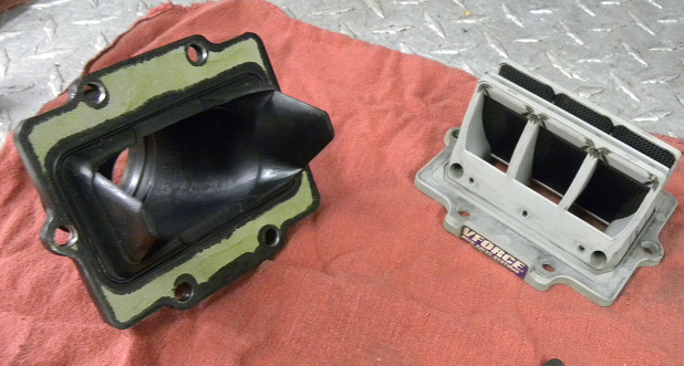

Installing a VForce 2 Reed valve in a KX500.
The first thing you notice is that the carb boot just don't work....
V FORCE 2 REED VALVE INSTALLATION -1.PNG (492.52 KiB) Viewed 19358 times
V FORCE 2 REED VALVE INSTALLATION -2.PNG (774.78 KiB) Viewed 19358 times

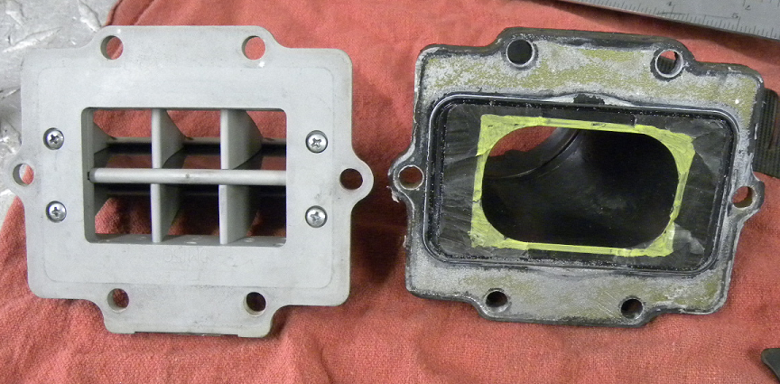

So, you need to cut the ears off... :o

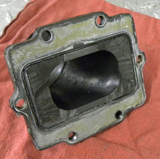

I recommend leaving the ears a little long so you can fine grind them to size.
V FORCE 2 REED VALVE INSTALLATION -3.PNG (668.39 KiB) Viewed 19358 times
That's better..

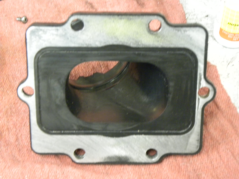

After cutting the ears, the next thing I noticed is the difference between the carb opening and the reed opening.
Marked in yellow you can see the huge difference.
My first instinct was to dremel out the difference.
But you don't want to do this as you will lower the port velocity.
I'll cover more of that in a bit.
V FORCE 2 REED VALVE INSTALLATION -5.PNG (852.22 KiB) Viewed 19357 times

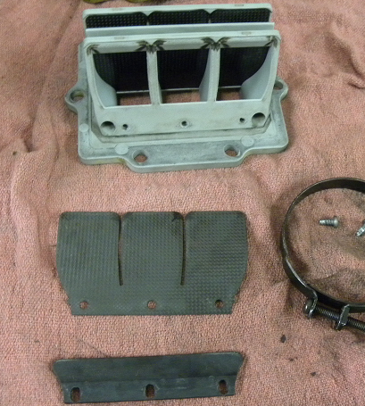

Note how the reed pedal clamp is slotted?
V FORCE 2 REED VALVE INSTALLATION -6.PNG (453.58 KiB) Viewed 19357 times

Here is what the boot looks like after it has been ground to it's final size:
V FORCE 2 REED VALVE INSTALLATION -7.PNG (1.04 MiB) Viewed 19343 times
It's hard to see but the mating surface is very smooth after grinding it on a 80 grit 18" diameter wheel.
The smooth surface is important for mating but also marking.

Look carefully at the reed clamp.
Note that they are slotted.
V FORCE 2 REED VALVE INSTALLATION -9-6.PNG (313.79 KiB) Viewed 19329 times

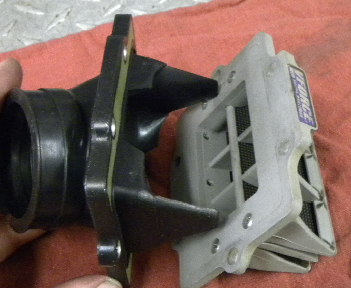

According to Moto Tassinari the Low tension setting is for low to mid range power and the hi tension setting is for High end power.
Here is a pic demonstrating the high tension vs. low tension settings.
However, after dyno testing stock and modified engines, then running the results on the streets I have found that nothing beats all around torque and HP when the petals are set in the low tension setting. That's what I run on all my bikes period.
Will the petals wear out quicker? I'm sure they will but I've never replaced mine :lol:
V FORCE 2 REED VALVE INSTALLATION -5.PNG (726.46 KiB) Viewed 19329 times
Note that there is a .004" gap when you set the reed clamp closest the carburetor making it harder to open the reed pedals.
When you set the reed clamp further from the carburetor there is a .050" gap allowing the reed pedals to open easier.
So just for the record:
Reed clamp closer to the carburetor = High tension setting
Reed clamp farther from the carburetor = Low tension setting
This is my story and I'm sticking to it for now :|
