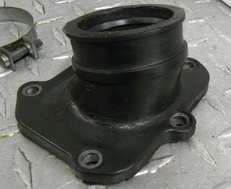

Let's take a look at this boot.
It is off a 91 KTM 300 DXC.
ktm 300 dxc carburetor boot insulator
ktm 300 dxc carburetor boot insulator.JPG (62.6 KiB) Viewed 9862 times
As you can see it is starting to get checked pretty bad.
I have fixed them in much worse condition then this so it is a easy repair.
None of the cracks go all the way through and from what I can tell the inside is smooth with no apparent defects.
So, get it CLEAN!!!!!!

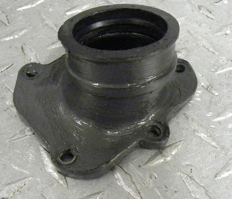

I take our boots and put them on the wire wheel.
Don't ski this step or do a half baked job.
Get every square inch of it clean.
ktm 300 dxc carburetor boot insulator-2
ktm 300 dxc carburetor boot insulator-2.JPG (48.97 KiB) Viewed 9862 times
When you are done, look at what happened:
ktm 300 dxc carburetor boot insulator-3.JPG (55.76 KiB) Viewed 9862 times
Many of the cracks opened up or were cleaned out so now we can see what is really there.

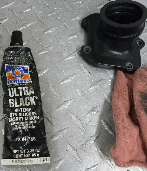

The next step is to make sure the surface is completely clean of any dirt, debris, grease, oil, ect.
We like to use Acetone as it does a great job and dries extremely quick.
I do recommend that you wear some good Nitrile gloves while handling Acetone as it goes directly to your blood stream :o
Acetone
Acetone
Now, look at the rag that I used to clean it with.
See the black?
If you don't take the time to really clean it your sealer won't get a good bond and you might as well not bother even doing this.
dirty rag.JPG (51.68 KiB) Viewed 9861 times
Get it CLEAN!!!

Here is pic of the actual tube.
ktm 300 dxc carburetor boot insulator permatex.JPG (59.38 KiB) Viewed 9861 times
As you can see, we have used it many many times :D

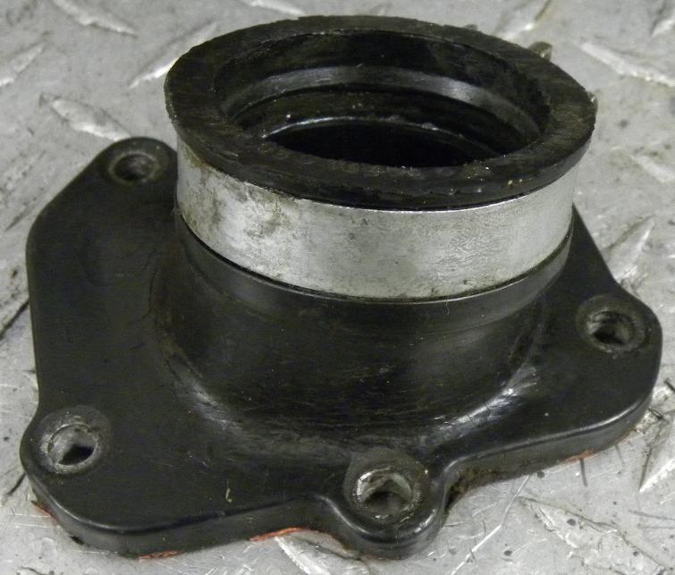

Now it's time to fully coat the entire outside surface area.
I like to use a nitrile glove for this as well just to keep the goo off my fingers.
Boot after coating:
ktm 300 dxc carburetor boot insulator-4.JPG (73.98 KiB) Viewed 9861 times
Let it dry thoroughly.
Typically it takes about 24 hours to be fully dry.
If it is below 65 degrees I recommend that you wait 48 hours or even longer.
Now put your bike back together and go ride it :D

It dried very nicely.
Obviously if your looking for show quality this procedure is not for you.
However, if you just need to protect the one you have or do a minor repair, this will give you years of usage for very low cost 8-)
