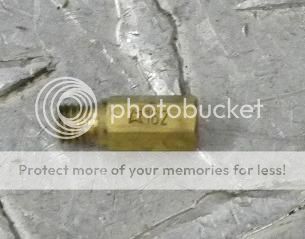

Installing a new pilot jet is easy.
Simply remove the bowl, unscrew the pilot jet, read the numbers on the side of it and get the correct jet.
Now, install the next size larger pilot jet and start from the beginning, adjusting the air screw.
If the air screw turns 2 or more turns then your pilot jet it too big and the engine is running rich at idle.
Install the next size smaller pilot jet and start from the beginning, adjusting the air screw.
Here is a pic of the carburetor opened up:
The pilot jet is down deep in that hole and requires a flat blade screw driver to remove it.
Here is a pic of the pilot jet removed from the carburetor:
See those little holes in the pilot jet?
Those are called Emulsion holes.
The Emulsion holes must be clean and free of debris.
You should also be able to look down the center of the jet and see daylight through it with no obstructions.

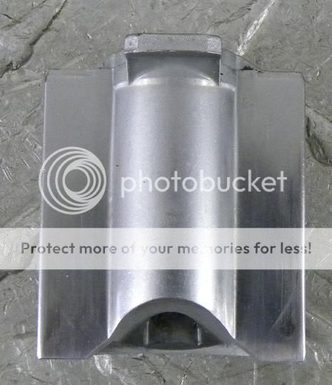

Slide, What is it and what does it do?
In most cases you will not have to change your slide unless it is just worn out.
The main job of the slide is to meter how much air flows into the engine.
When at idle, the slide is in the down position.
This blocks off most of the air into the engine but not all.
When you twist the throttle to the wide open position the slide moves up to it's top position.
While the slides main job is to control the air flow into the engine it also meters air at low RPM's by means of angles cut in the bottom of the slide.

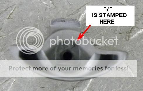

This area is called the Slide Cut Away.
Stamped into the slide is a set of numbers.
The lower the number the richer you will be at low RPM's.
The higher the number the leaner you will be at low RPM's.
Most of the time it will be unnecessary to change the slide unless you are making radical engine modifications or if the manufacture just flat out blew it in their slide selection :-)
