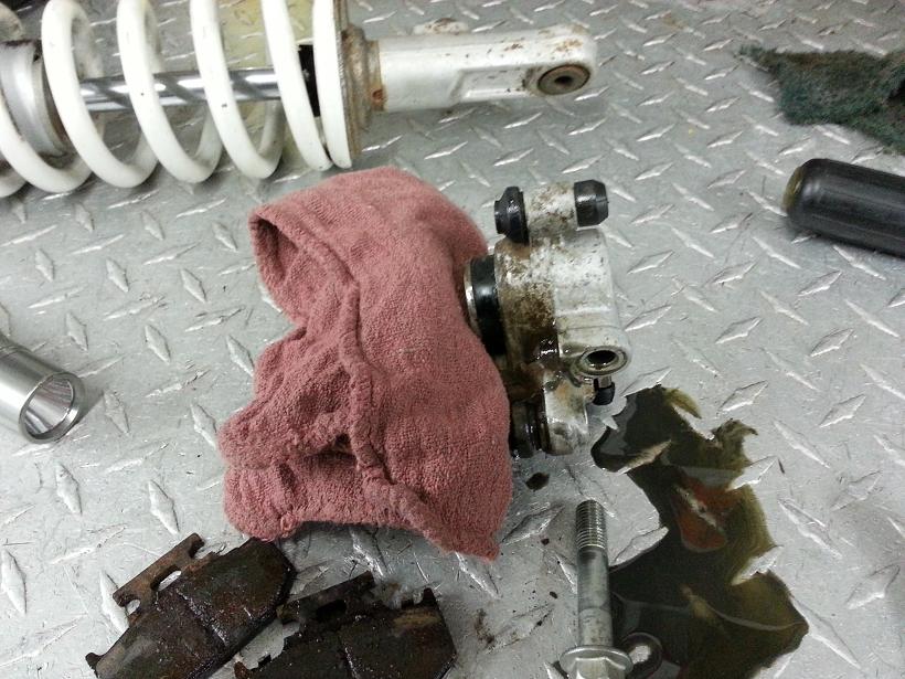

To start with we have to start disassembling this mess.
It's best to clean your brake BEFORE you start but whatever I'm in a hurry and I'll do it wrong anyway..
To do what I want I have to disconnect the brake hose.
When you disconnect the brake line you open up a direct path to the inside so I plug the hole with a bolt so I can continue cleaning without contaminating the insides.

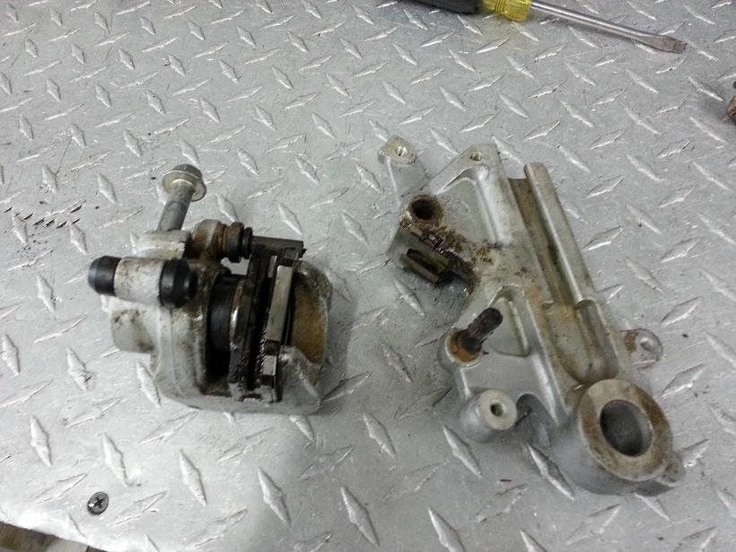

Next I removed the caliper mount.
This style is easy, just pull them apart.
After removing the mount I removed the two pad pins... What a mess...
I removed the bolt that is in the hose mount because I need to blow compressed air down that hole to remove the piston.
What a mess...
What a mess...

When using compressed air to move the piston I like to use a shop rag to make a barrier to keep the piston from shooting across the room.
Yes, they will shoot across the room
Put your rubber tipped nozzle in the brake hose hole and give short bursts of air.
Typically they will shoot out with a noticeable pop..
If you don't use a rag to keep the piston from shooting out, be sure to aim it in a safe direction because the piston will easily shoot out 12 or more feet even under fairly low air pressure.
This one oozed out because the piston and seals were completely gummed up.
