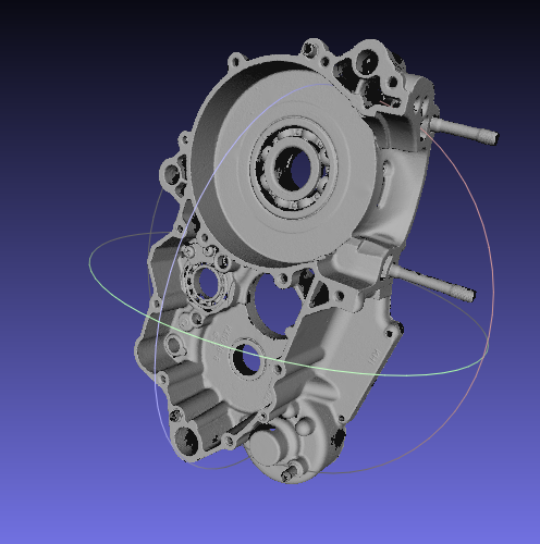

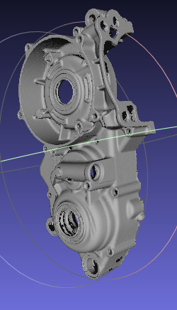

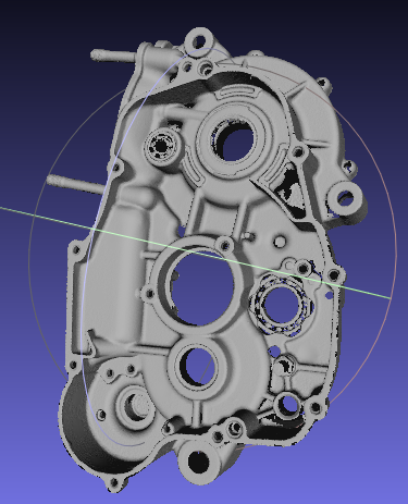

14001-5258 89-04 KX500 Crankcases: Obsolete
You can repair a lot of damage.
Before looking for a used case which can cost 400+, consider getting yours repaired.
We have repaired some really bad cases and they work perfectly.
KX Guru Racing is working to have new billet cases made.
They will be expensive and there is no date for availability :?
